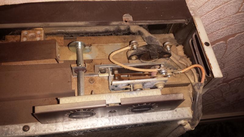

So took covers off and checked again for reset... none present!
So will see what dimplex say...
This one? It's not your model but anyway -
Unless it is the black disk at the back? Was a white pin at the back but didn't budge pushing or pulling....

Not sure if they were touching, i tried to move the white pin, but it didn't move. If i had figured out this was the reset at the time i would have spent more time on it :( .
Taylor - problem for the actual user is he's currently using 1 oil radiator to heat the flat! He assures me that no cloths are being hung but besides that he still needs to get heating back up and running. If i order all the possible parts for 3 rads, each rad will be somewhere between £121.84 and £137.09
if i order 1 part try it, order next part etc, it will be weeks before heating gets up and running...
Dimplex - or home appliance care who does the after warrant work quote £139 per rad fixed price - however they called this morning and said they cant do the work as the rads are too old?? They stop servicing old rads as they cant get parts - which i know is rubbish as the link from EFLImpudence's post has the parts!

4) Heater itself - Given that when power was applied for 2 and 3, the heater did NOT heat up, i can only think that something has gone wrong on the heater side - power is applied but no heat is generated.
So from what i can see, i have a fault at 1 or/and 4.
4 is proven when power is applied to be faulty, 1 hasnt been proven either way.
Surely if i can get the heater working when powered from the 24/7 and it still fails on the eco 7CU, then i can look at that accordingly. Till i can prove the heater is working, its difficult to turn to the DNO and say the meter is dead... esp when they have been round and said its not?

May well be the cutout - but i couldnt get it to budge - is it a magnet based system? when working normally the white pin is pulled to magnet, when the strip overheats its strong enough to pull it off the magnet? or does it work in another way?
