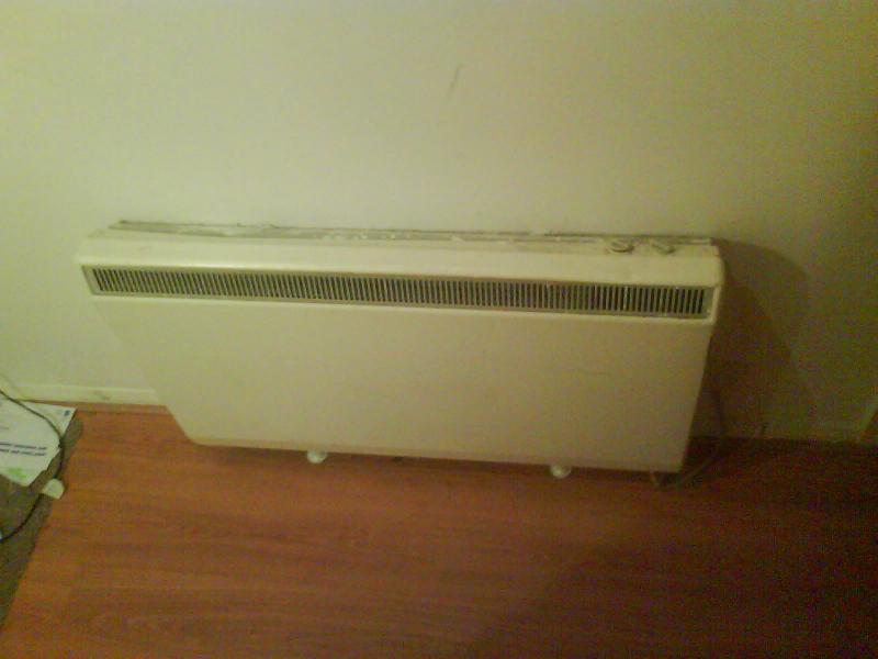

hi all i am new to this forum and was hoping someone could help me out, my storage heaters have stopped working (not both at same time)
they are not on a separate circuit as someone else suggested to me, they just packed in one day.
they are wired to unfused switches on the wall
they are both Dimplex, one is a 'lxsn' model
any information before i have to call out an electritian would be great,
thanks

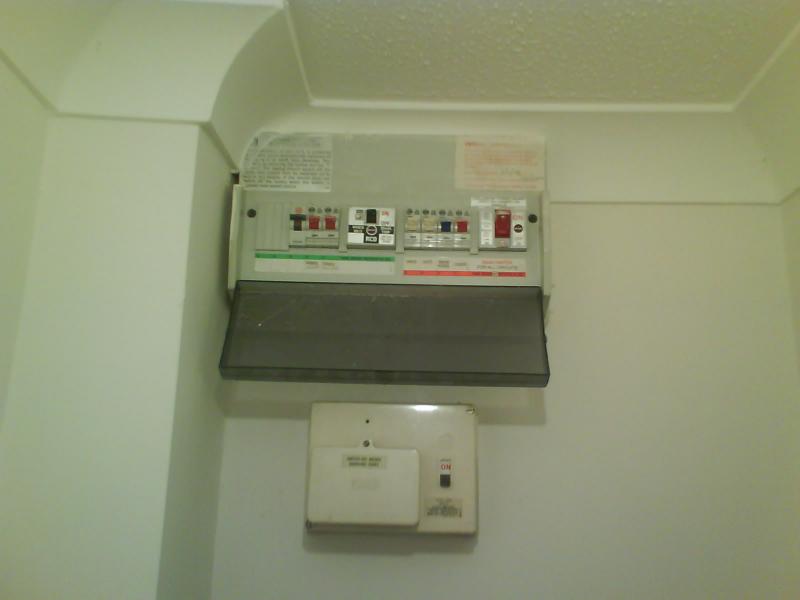

storage heaters usually come from a second off peak fusebox remote from the main fusebox.
the set up you have is hard to say.
if possible post a picture of one of the heaters and of the main fusegear near the electric meter.
What is the exact model number of your heater? There will be a plate on it somewhere with this information on it.
If you turn the switch off next to the heater and is also probably a good idea to turn the fuse box off - it looks like the bottom fuse box but will be a good idea to confirm this.
You will then need to remove the cover screws around the storage heater to gain access to the thermostat area at the top right hand side - there may also be screws around the dials, I did one not so long back and can't remember if they were hidden behind the knobs. Think you need to remove the knobs anyway.
Inside the top of the heater there will hopefully be a device which looks like this:
The brown part to the left hand side of the above pic is the thermal cutout. If you press the small white button in the middle of it, if it has tripped there will be a positive "click". Now to put your heater back together again!
The supply to them may possibly come from that smaller box.
the reset is on the top of the heater near the control knobs underneath.
But to access it the cover needs removing.
the cover is held on with small pozi screws usually up to 4 off, not to get mixed up with the ones holding it on the wall bracket do not remove them.
the top pulls forward and the bottom lifts off the two slotted lugs
You must First pull the two knobs off gently
as the cover comes off it will hit the live bar
This is why it needs to be 100% off.
If unsure do not attempt, or preferably do it during the day when the offpeak supply is off.
the reset is a sort of round button shaped thing with a sort of middle bit sticking out.
the middle thing pushes in and an audible click is heard.
The POWER MUST be OFF before attempting this.
