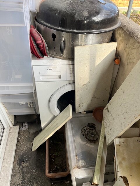

Hi
In rental property, my tenant removed my washing and stored it in the balcony for few months in the elements, then re-installed against my advise, it is working but is it safe? Do I have to honour the maintenance if breaks down?
Photo how was stored is attached.

Is the machine safe to be used after being in the elements for over 3 winter months. I believe it's been outside from Oct to Feb.

Send an email to the manufacturer with model number and ask if the lifespan of the machine is likely to be affected by leaving it outdoor for that period and if it's safe to be re-installed.
They'll surely see this as an opportunity to wash their hands off any warranty (implied or otherwise) and suggest to not use the machine unless inspected by an authorised engineer (which will cost more than a new machine).
That reply will give you the green light to remove the machine from the property and dispose of it.
Tenants will pay for it via deposit when they leave.
I would remove the machine regardless, just in case.

I imagine that the machine is protected via the socket it is connected to by all the correct components in the consumer unit (mcb and rcd ) if that is so and the machine is now working fine then I would say, although it is difficult to prove without close examination, that the machine is OK. The usual fault that appears in that sort of sityuation is that the heating element absorbs moisture and causes either the mcb but more commonly the rcd to trip. You don't mention having this problem. The other concerns would be circuit boards and motor brushes both of which would probably give error codes when trying to use the washer if they were faulty. Personally if the machine is not that old I would tend to just suck it and see. As Diver fred says the only real way is for someone qualified to see it on site but I doubt they would commit themselves to giving any guarantees and be a ttime consuming and expensive thing to do.
