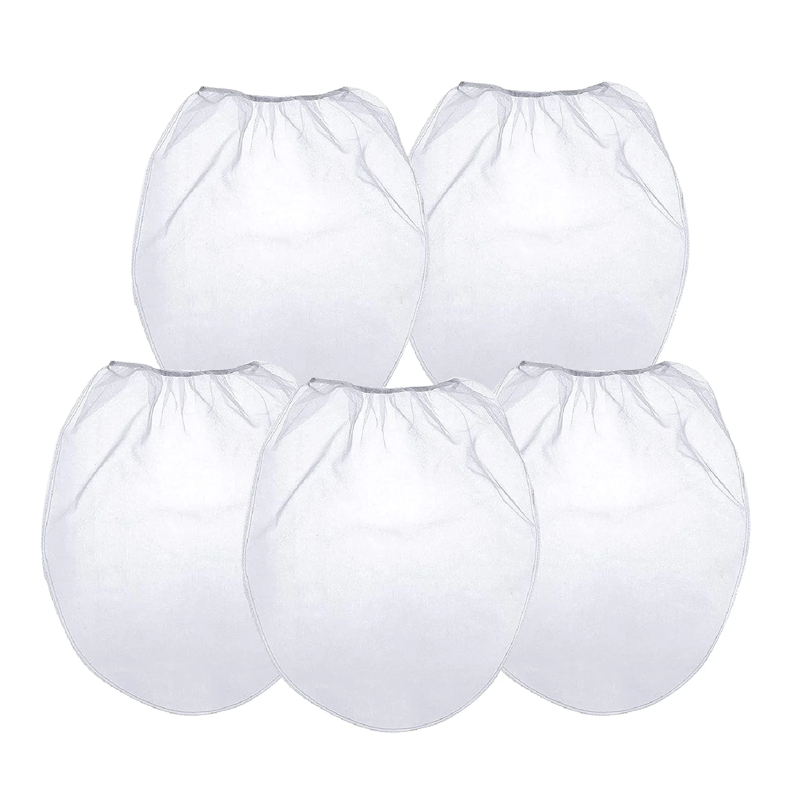

Hi
Hoping it’s a quick one. I’ve read the tips about using fine muslin or tights to strain paint. Is this still the go to method or is one of those stainless steel strainers a better option? Like this https://www.ebay.co.uk/itm/28566395...mCv9mJvT4K&var=&widget_ver=artemis&media=COPY
I’ve got a Wagner 350m sprayer and a load of covaplus vinyl matt from Johnstone’s. I like the covaplus but it does seem to flake up a bit when left in the tub. That won’t be good for the sprayer I’m sure so I’m just trying to work out the best way of doing it. I’ve probably got a good 60 litres to do as I’m painting the whole house. Planning to do most of it in one go.
Any tips would be greatly appreciated.
Thanks for any help!

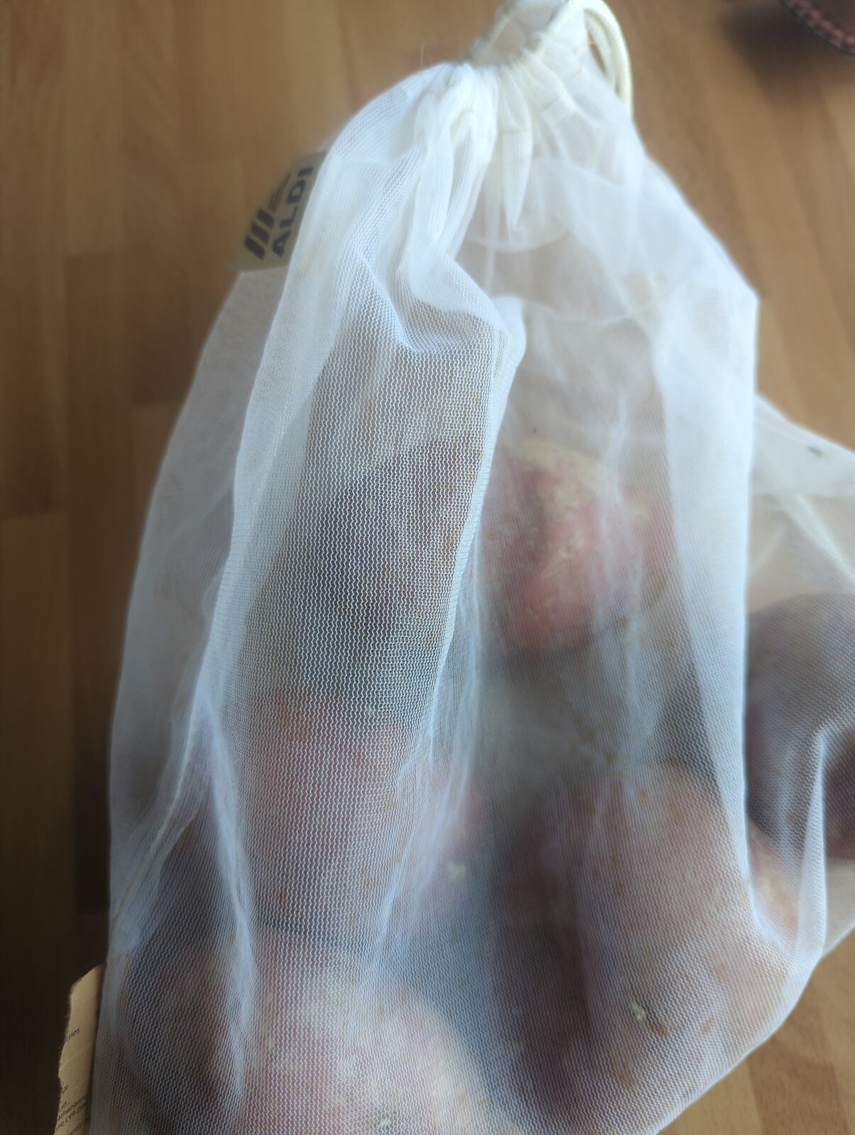

Veg bags from supermarket are good. Bit small but can tape on 5lt can.
I like the big net bags from AliExpress
Thanks! Have you got a link? I’m not sure what you mean by veg bags. All I can think are the orange net ones you get onions in but that’d be too big to stop any flakes getting through.

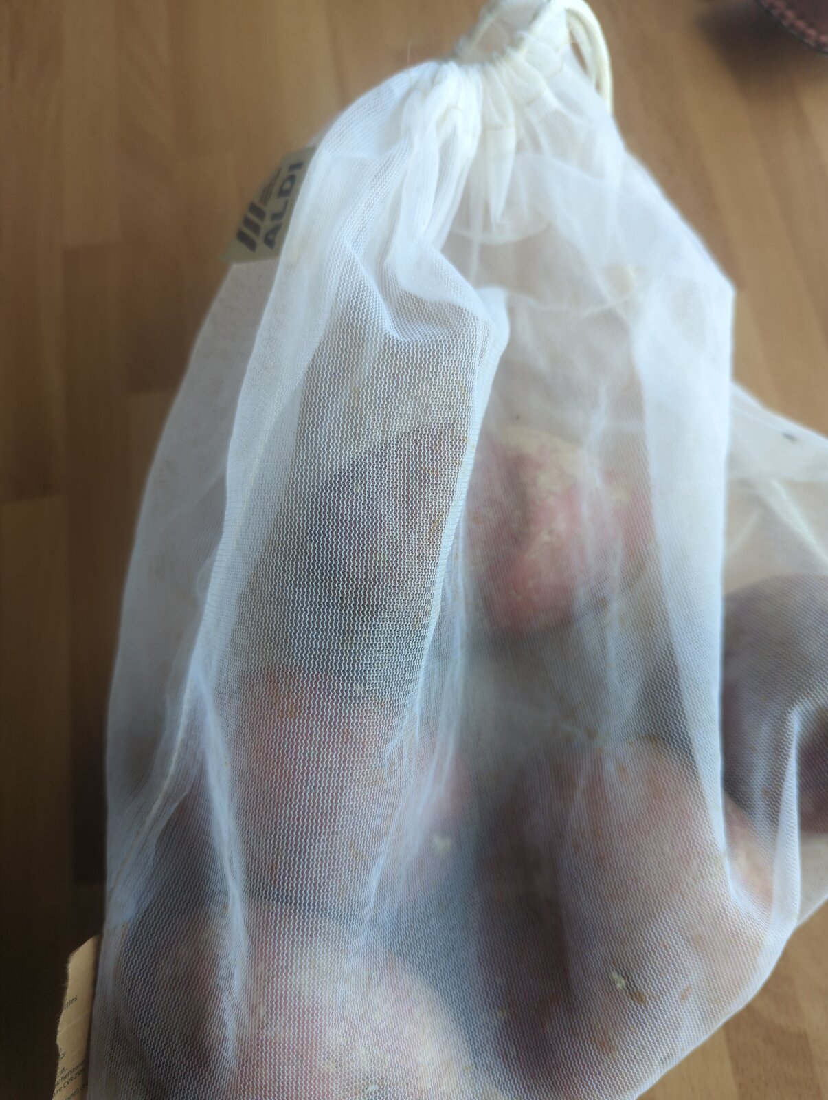

Supermarket sell veg bags for 25p. Aldi Sainsbury's ect. They don't give out free plastic bags to put carrots or apples in ect now, so you have to bring your own or buy the net bags in the boxes scattered around fruit and veg.
I guess you're not in the uk?
Do you want link to AliExpress bags? Bit of a wait for those.
Aldi veg bag. Use as paint strainer. It's a known thing

Tape the net over 5lt can of the paint.
Pour through the net.
