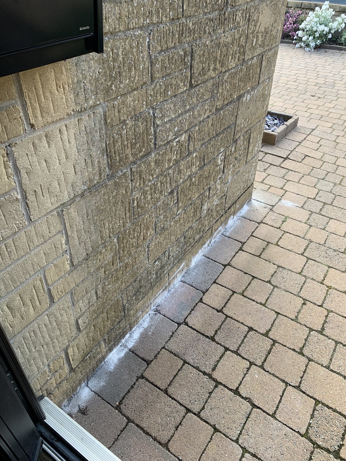

I noticed a bit of a musty smell coming from my daughters bedroom as of late.

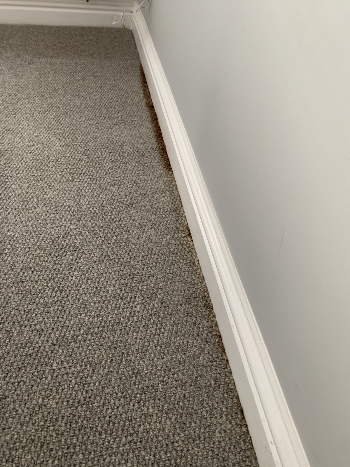

Nothing obvious so I pulled out the furniture and found this on the carpet. It was damp to the touch so I’ve cut it out and sprayed it with mould killer. In the process of letting it dry out.
Now - what is it and how did it get there?
It runs the precise length of an IKEA unit and there’s no sign of any other issues anywhere in the room.

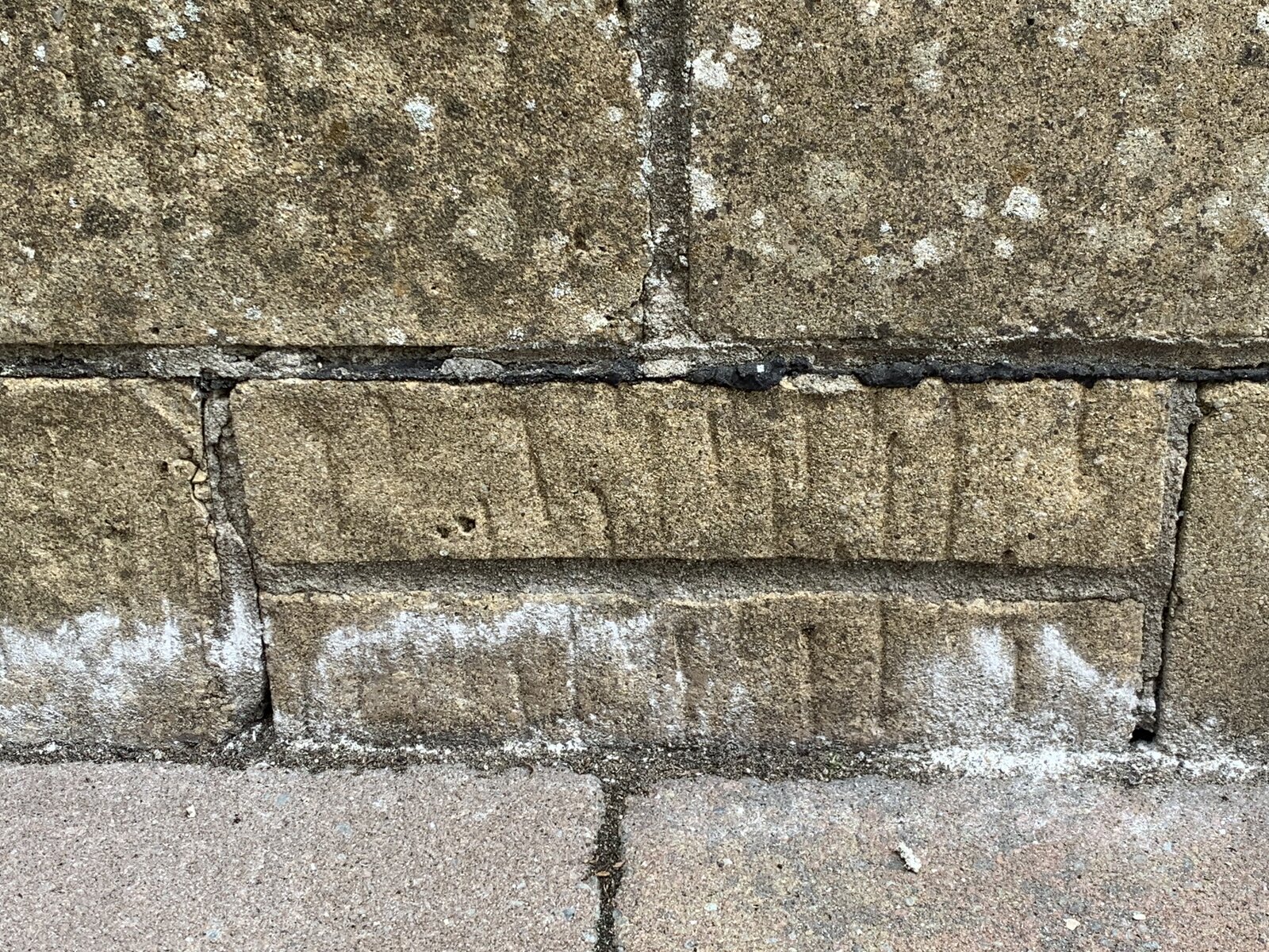

In terms of what outside looks like - there’s another picture attached (the white stuff is ant powder and not efflorescence).
I’ve measured where the main spot was in the room to the outside wall and taken a picture of roughly there.
I definitely have a DPC, and it’s definitely not bridged.
It’s a solid concrete floor construction (no DPM under the concrete) with a cavity wall. There are no pipes in the floor at all.

a damp patch that is the precise area of the shelving unit?
do you mean the carpet was damp where there was something on it?
you find exactly that in a shed or cellar where the concrete floor is damp. the water evaporates off fast enough that you do not see damp patches. But if you put something on the floor, damp forms underneath it because you have prevented evaporation
this is a noted cause of paint tins in sheds rusting through the bottom.
put a sheet of clear plastic on the floor, weighted down, see if moisture forms undrneath it
you say "a solid concrete floor construction (no DPM under the concrete)" which would fit

Rest of the room is fine so far as I can see. Also - it was tracking from wall / floor junction back into the room…

Pics showing the full damp stained elevation up to eaves might help to show why the elevation is damp stained?
The skirting appears to have been boxed or packed out from the wall?

That’s not damp staining on the wall - it’s weathering. The cleaner bit is by the porch which shields that bit of the wall from the worst of the elements.

Skirting is neither boxed nor stacked. It’s attached to a plastered wall which doesn’t bridge the wall / floor junction.
