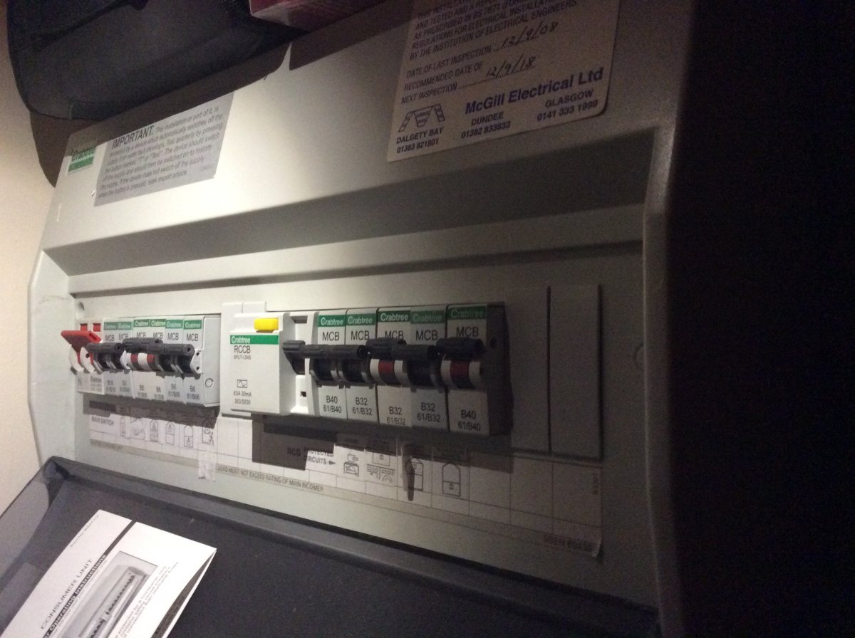

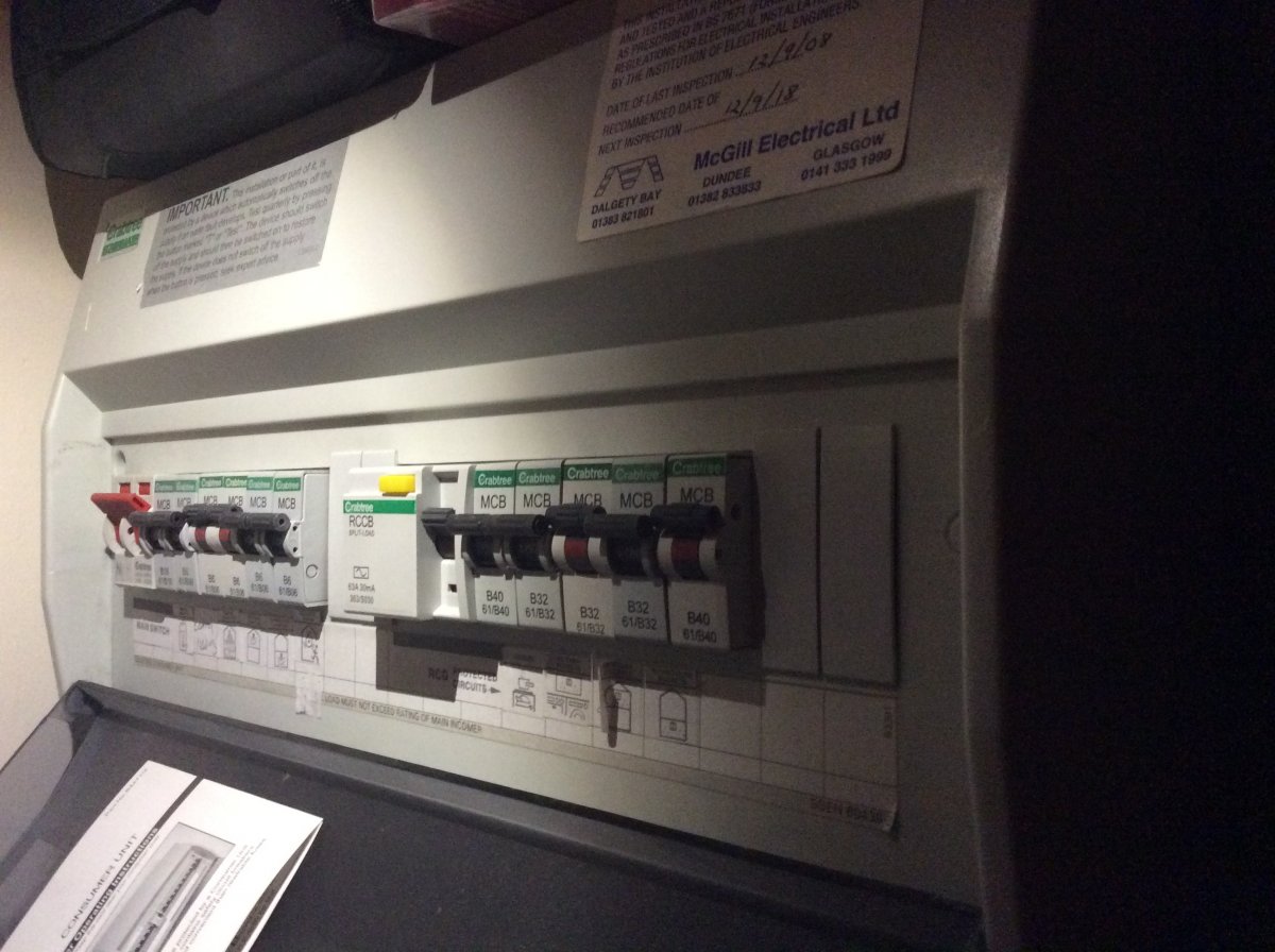

Ok it's been a while but we are seeing the issue again. In the afternoon, no one in, come home and the main rcd has tripped. How on earth (excuse the pun) do you figure out what's doing it!!
post a pic of this main rcd, if poss.
if your flush with cash it may be worth investing in single rcds for each circuit
Hi 333rocky333
I have put an image in my post. The main RCD is the RCCB in the middle.
Mm, been there, done that, have the RCCB tested. I have replaced two on these Crabtree units due to nuisance tripping. Your electrician will have the equipment required to ramp test the RCCB.

Great. Thanks. I am getting in touch with a local electrician in the morning to come and check. Do i ask for ramp checks to be done?
You could, but one would hope that a competent electrician would not need to be asked/told!
I suppose that, pragmatically, if it appears that (s)he is not going to undertake such tests (or maybe not even test the RCD at all), you might want to 'mention it' to avoid wasting time!
Kind Regards, John
