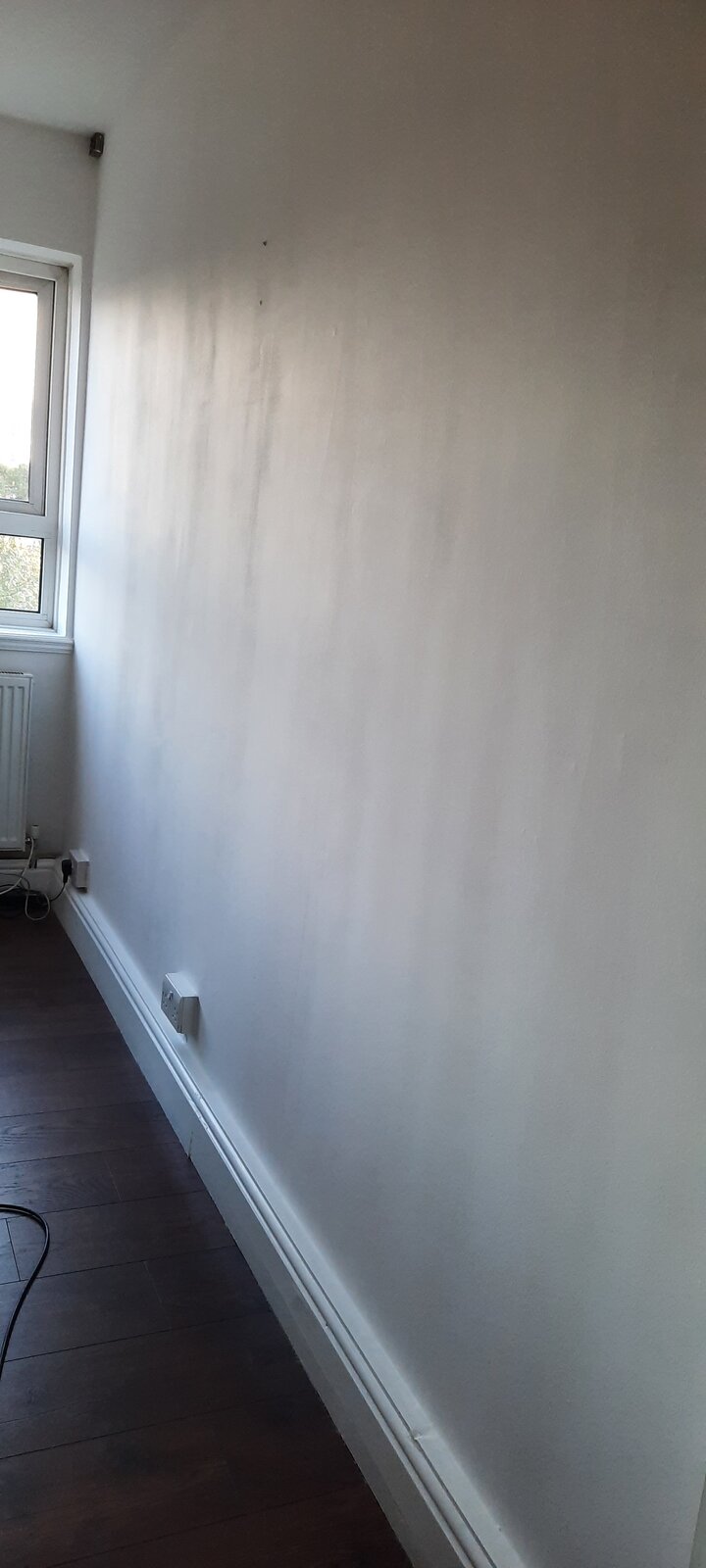

Streaky Walls Please Help
18 May 2023
7
Why oh why has this happened ?
This is after 3 coats of dulux mixed white vinyl matt paint.
Please don't tell me I have to sand it all and start again.
Any advice appreciated please.
15 ich or wider roller.
Final roll on each drop run roller in the down direction only so nap is same pattern on each drop.
I used to go horizontal. That was my unusual thing.
Right to left along wall starting at the top.
Drop down 12 inches with my 15 inch roller and go along again.
Repeat until you get to the bottom of wall.
It's never totally perfect but way better.
Also strain emulsion with 25p veg bag
