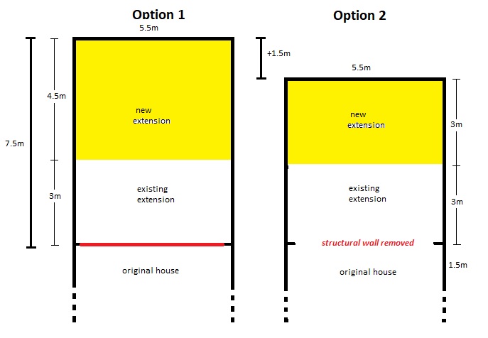

Hi all, we’ve recently had planning permission approved and now trying to finalise our internal layout before getting in builders for quote. Budget is going to be tight, so one of the key considerations is weighing up whether to do more structural works or make the extension bigger, and looking to understand whether either is likely to be significantly more expensive than the other…
We have permission to go out 4.5m (on a 5.5m width) and this would be the preference (Option 1 below), but budget is a major factor and in theory for what we want to achieve (7.5m x 5.5m open plan space) we could get away with only needing to extend out 3m by using some of original house space, but that would require some significant structural works in taking out pretty much the whole 5.5m wide structural back wall (possible box frame/goalpost structure needed) - Option 2 below.
So looking for advice (if it’s a simple-ish answer) whether it’s likely to cost significantly more to do a bigger extension with less structural work, or to do the smaller extension but with more structural work? Or is it not that simple to answer and a case of needing to get the builders to quote for both designs?
In my (relatively inexperienced) mind, once we’re already extending at least 3m it feels like it would be more cost efficient & less complicated to just go out another +1.5m rather than having to go down the more “complex” structural route??
Simplistic drawings below to illustrate this particular scenario (mine, not the architects drawings, in case you weren’t sure )...
Let’s hazard a guess
Structural wall opening £5k
Additional 8 m2….not sure but maybe a builder will put in a number here
My guess is the additional 8m2 will cost more, but you get more for your money

Thanks Notch... assume the £5k might be more for a "simple" opening? I got the impression from architect a goal post/box frame type structure would be needed given the span and as taking out the full wall, which might be significantly more?
Yes you could well be correct, I haven’t pricing since before covid so prices are probably double.
A box frame is a fair bit of work as it means foundations and pads
And if you want a flush ceiling then replacing floors upstairs
Ultimately you will need to get a good builder on board who will give you the options…but you kind of need building regs drawings to get a builder to quote and you don’t want to get drawings done until you know how much each option will be. Chicken and egg
Thanks Notch... you see my issue exactly ha!
I guess my question is for builders then... If you're already onsite and building the extension of 5.5m x 3m at a rough quoted cost of £2.5k per sqm, then to take the extension out an extra 1.5m (to 5.5m x 4.5m) i.e. an extra 8 sqm, would I really be looking at £20k extra, or would there be economies of scale and the incremental cost of those 8 sqm be less than £2.5k per sqm??
