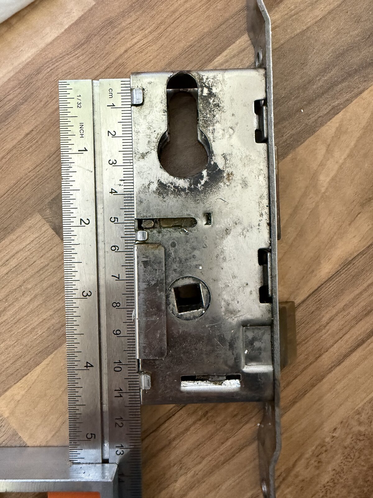

Please see attached pics. I went to my local hardware and to Selco and neither had anything close to this. It states 'Yale—Glissade A' on the external faceplate. Nothing on the internal.
Length 193mm (or 115mm aside from front plate)
Backset 30mm
PZ centre 45mm
What are my options here? I'd like a like-for-like replacement, but not sure if that's realistic.

This is the nearest I can find but it’s a bit bigger: lock case is longer as is forend
But it has 30mm backseat and 48mm ctrs
Thanks. That looks like it might fit the bill. Here are pics of the existing cut out and faceplate. Will they fit, do you think?
