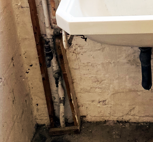

One 'spanner' on the tap, something else helping to take the torque on the pipe, so the arms of both are at a similar angle, close to each other - then fit a lever between them, to apply the brute force.
It's still a while before I'm going to be reunited with the tap again (my greatest hopes still being in 'heat') but, in the meantime, I've found a photo which gives a little insight into the 'access' problem (restriction on getting decent length pipes onto a spanner, as below.
As I said at the strat, the whole place obvioulsy needs a new plumbing installation 'from scratch', and I'm starting to think conceptually about ways in which that could be arranged and engineered. I'll therefore probably be asking a number of further questions about those 'concepts'(and some details!).
