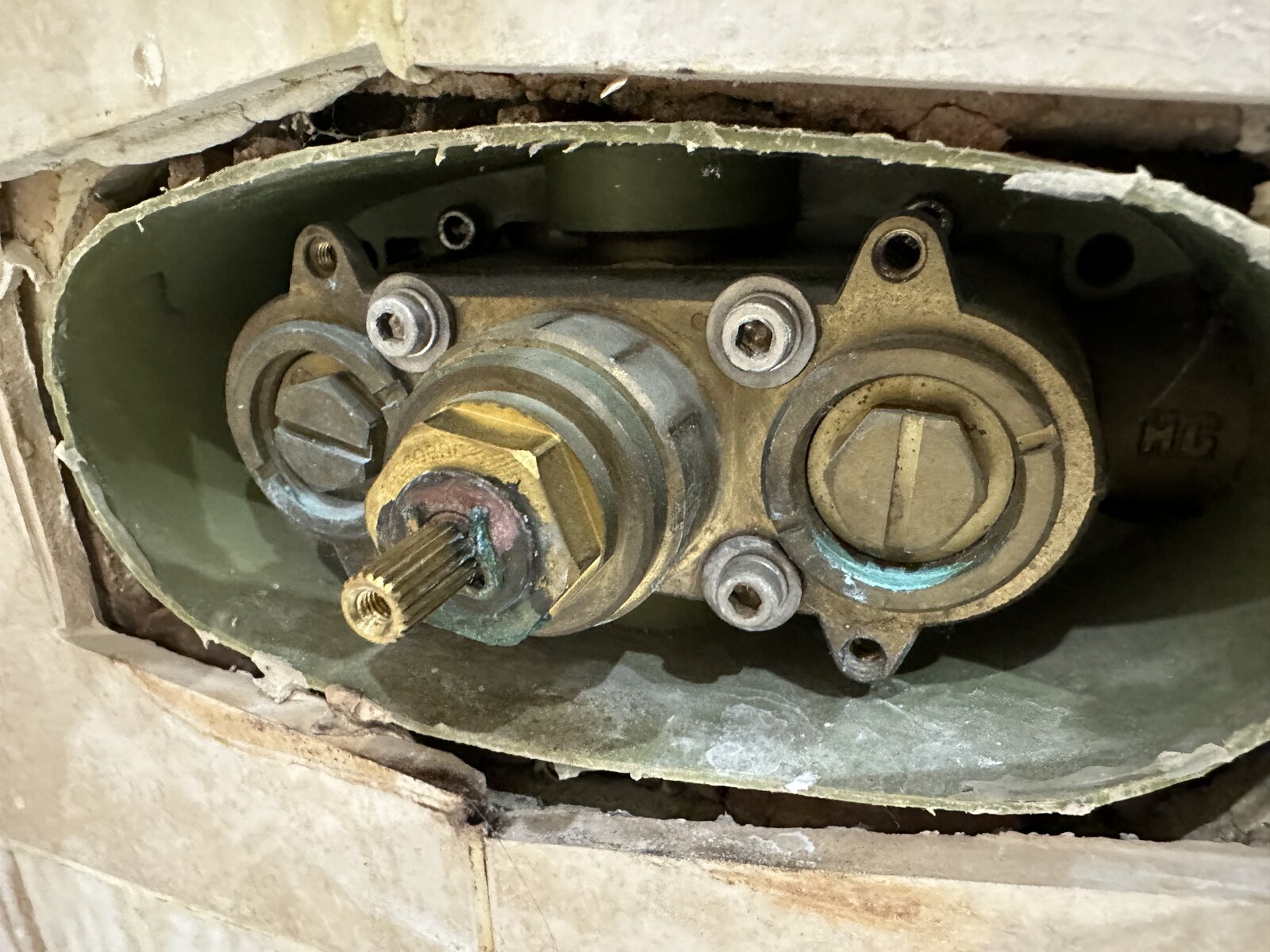

Hi, there is lukewarm water coming out from the shower at maximum hot settings, so I suspect the thermostatic valve needs replacing.
Unfortunately valve is suck and doesn’t come out after unscrewed. Is there any way to pull it, maybe some sort of puller tool for valves?
below is phot of the valve when it is fully in, didn’t take it when unscrewed.
If I remove those little cartridges on left and right, and unscrew the 4 hex bolts, will I be able to remove the whole front plate together with the valve ? And if I do it, so will I damage any seals that would need replacing ?
This installations about 23 years old, Hansgrohe Starck 2000-2002

Thanks John, I unscrewed those filters and cleaned them and back. They look ok - could they be the reason for lukewarm water? Doubt it but I am not a plumber.. Cartridge does move a tiny bit, the problem is I don't have enough leverage to pull it.

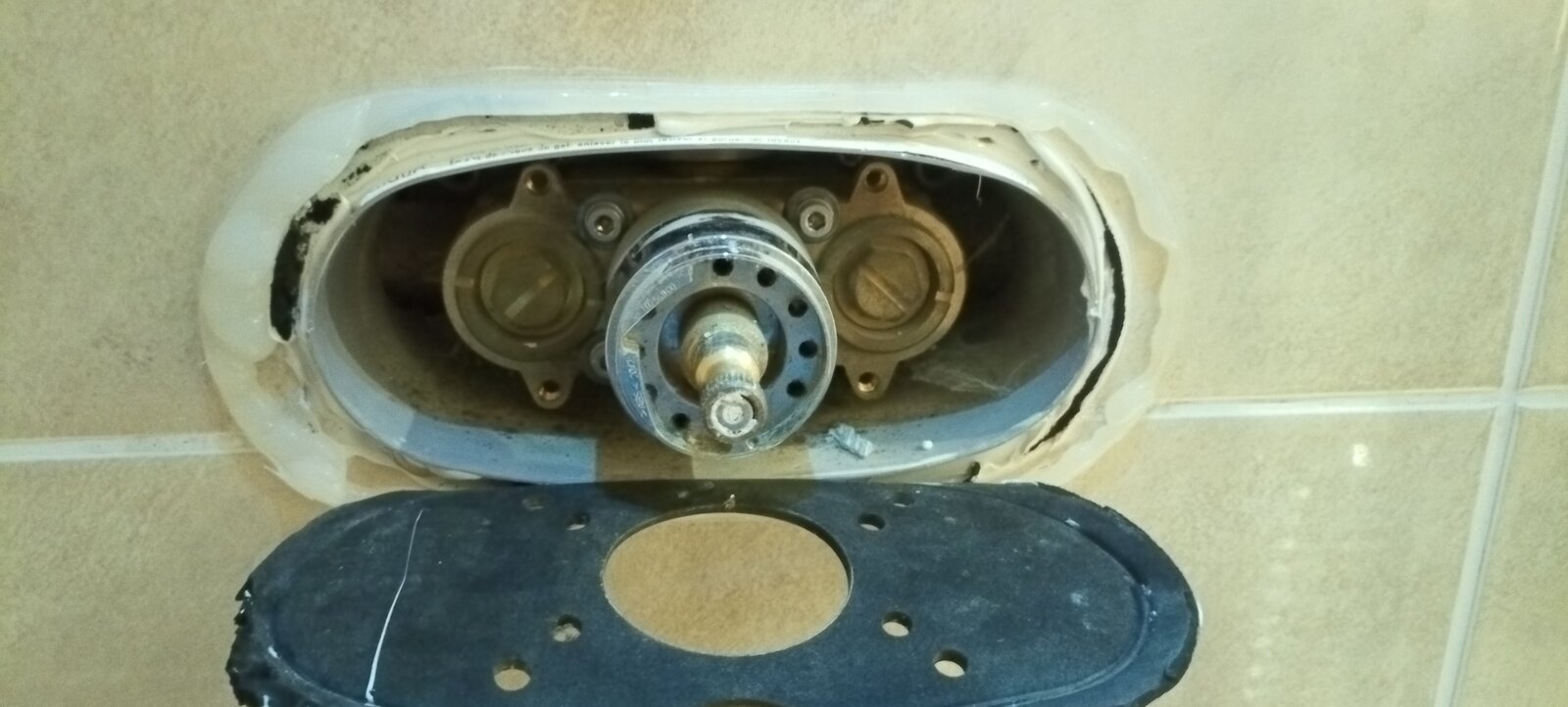

Did you have any luck? I'm having similar issues but can't get quite as far as you.
Can I ask how you got the chrome plastic surround off around the cartridge (with the 5 small holes on the right and some on the left).
