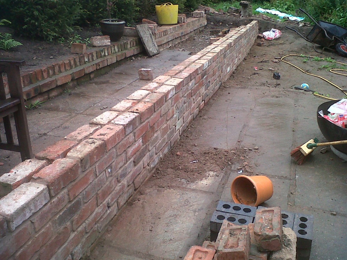

Yep agreed, which is part of why i wanted to speak to someone who has really done it and lived with it.
To alleviate this, the fence is decorative inside the boundary so sheltered by other walls/fences, will use slatted panels for less resistance, the top layer of bricks will be engineers and will brace at mid point with frame purgler.
But yes I am still concerned by structural integrity.
Kev

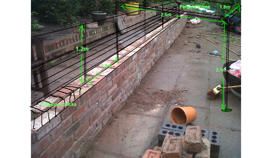

Another option would be to fit a wooden frame to the brickwork. This would allow more attachment points and therefore spread the load rather than the GardenTrellies method of fixing the posts directly with resin anchors. Bit like this.
Kev
Excuse the very crude diagram but this gives an idea of the project and how the fence will be braced.
If you use resin anchors within about 3 courses of the top of a brick wall you are asking for trouble because the mortar will often not hold the bricks sufficiently well.
