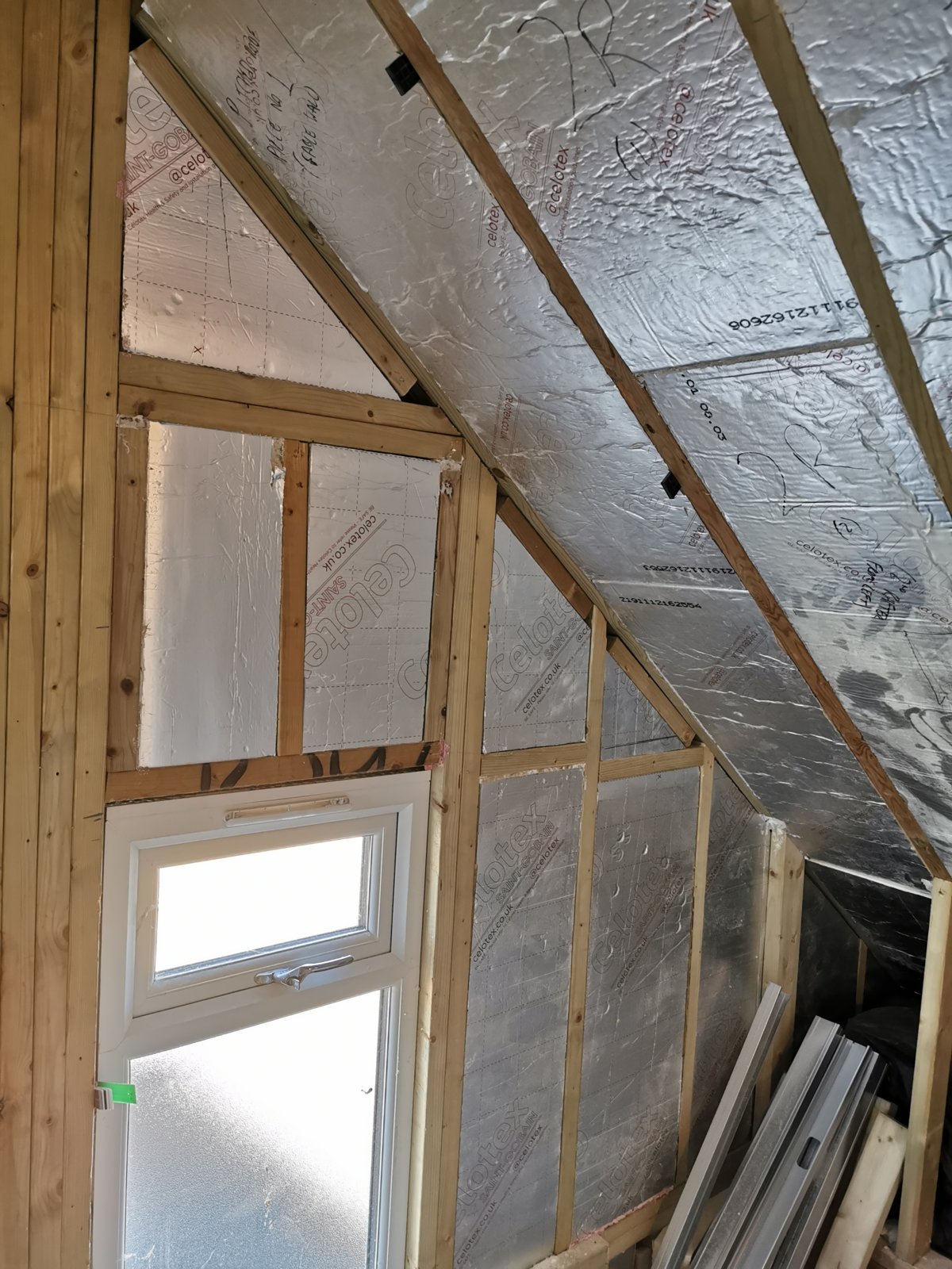

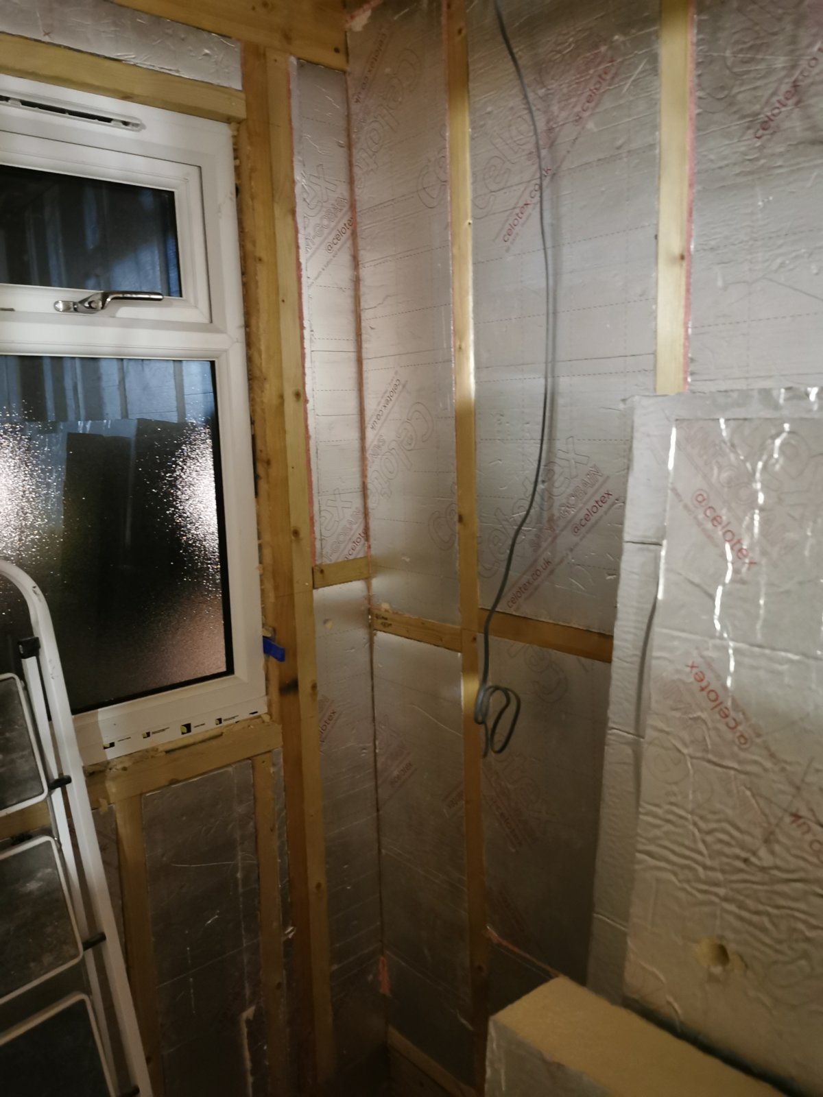

Almost ready to start plasterboarding my DIY Loft conversion (had a builder do the shell/structure only) but realised the internal corners have no studs for the plasterboard to screw to.
Is this standard or has the builder messed up? I would have thought a stud is needed on every corner? Do I now need to cut into my insulation boards and fit studs along every edge?
Even wall to pitched roof edge is missing a stud as you can see below:
Oops.
How much air gap is there behind the insulation boards? If there's plenty you could push the boards back and fix slating battens or similar to the hidden studs.
Or (messy & don't know how well it would work) get some longer board screws & skew screw them into the hidden studs
Or (if the insulation is firm) Gripfill non-solvent down those edges
Easy mistake to make when setting out, give builder a ring and rip the ****. Unless he was building from detailed drawings done by someone else....
Nice neat cuts on the insulation, vile job innit :)
Is he off school? It's a schoolboy error.
The worst crime there and which would be more concerning, is by whoever specified that construction without a layer of insulation across the timbers. Thats pre-school.
I would not be too concerned about the noggins, not ideal but not a major problem, but rather than rip the lot out, use some panel adhesive along the edges to secure the board to the insulation.
if it was smaller areas i’d say butt the board edges up and run gripfill up the corners . when it’s scrimmed and skimmed it shouldn’t budge. however that’s really not acceptable. and given the extremes of moisture and heat and cold are greater in the loft it’ll expand and contract and look like a car crash in 12 months.

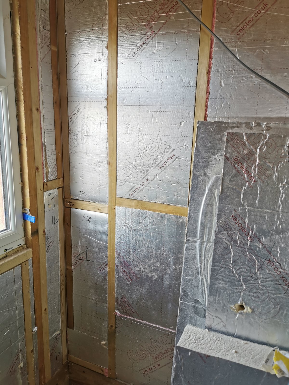

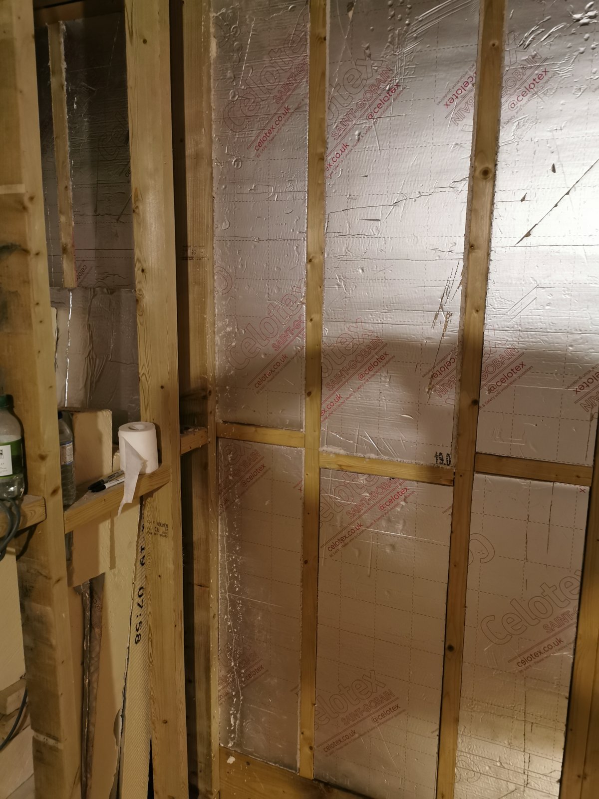

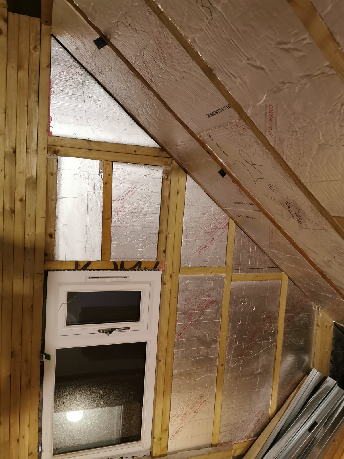

After seeing these replies agree with my initial thoughts, I decided to redo those corners - removed and recut insulation, and fitted new timber to support the plasterboard :)
