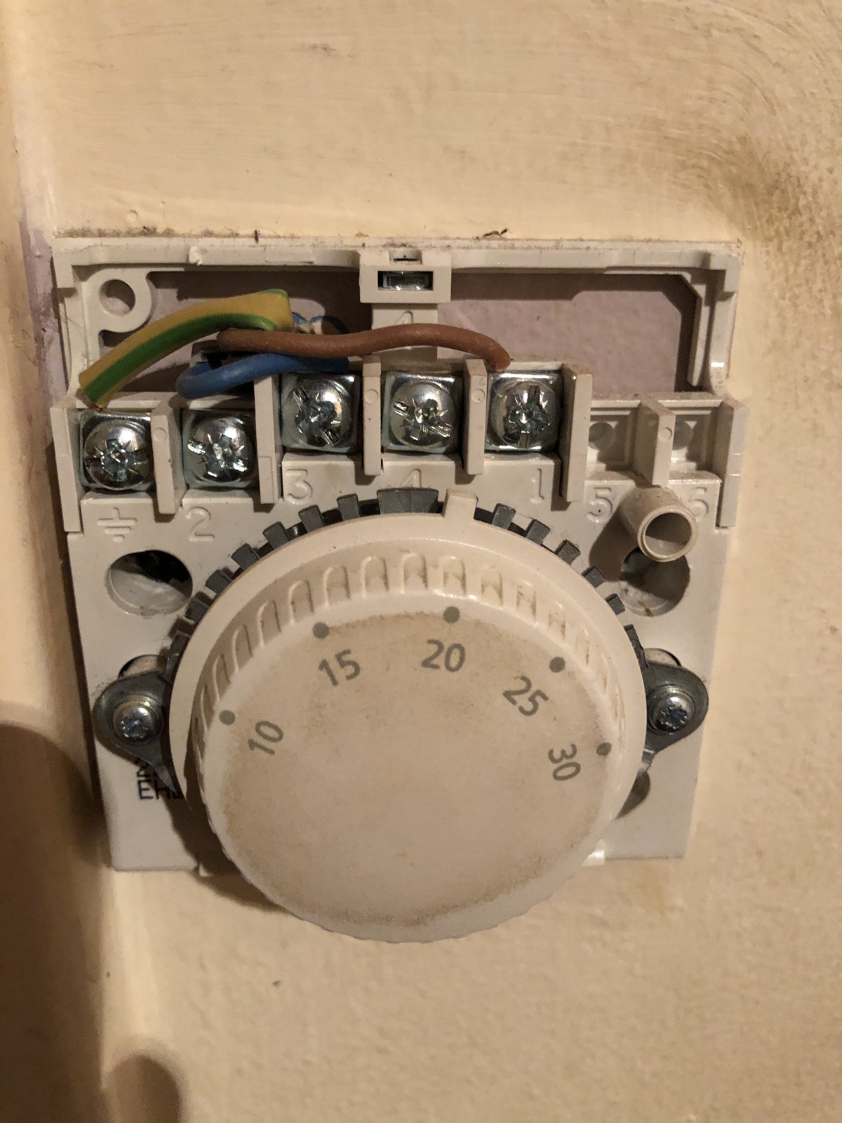

Hi all I am new to the group so thanks for letting me join. I am looking for advice on the install of a smart stat.
I have removed my old (very) old stat and have found it only contains a brown, blue and earth wire. I removed the whole unit from the wall to try and find any other wires hidden, but there was none. How on earth can I fit my new stat. My thermostat is in the bottom hall while my combi boiler is upstairs. Here are some pics of the offending items. Thank you all in advance.

So the thermostat is for underfloor heating? Not sure if the NTC needs compensating cable or if twin and earth will work, or if the remote sensor is for the floor or if it allows the thermostat and sensing elements to be remote from each other.
With many "Smart" thermostat the dial and sensor are wireless or single pair of 12 volt wires connected to base/heat link/or other name, so not sure if new thermostat goes where old one was, or just the NTC sensor what does the paperwork say?
I will guess you have picked up wrong thermostat, and you have a under floor heating one which you don't want, so will be returning? So at this point question is what do you want the smart thermostat to do? I hate the word "Smart" in the main it seems to mean it connects to your phone, but what it does then varies so much, my Nest Gen 3 has geofencing (it detects when phone is close to home) and occupancy detect so either will turn heating back up, and it auto turns down when you are not at home, and with the hard wired option you need two wires between the thermostat and heat link, so your heat link would be upstairs and the thermostat where the originally is and it does not need any batteries.

Likely the new one will work, but it will need the cable swapping to a 5 core cable and it does seem a lot of work specially if wrong thermostat to start with.
If you want to use that thermostat you will have to run a new cable, if you dont want to run a new cable buy a battery powered room thermostat and you can use the existing cable

No the live and neutral should come from the same supply as the boiler , it would work but would not conform to the installation instructions for the boiler or the thermostat, you need a minimum of 3 cores and possibly 4 cores if your boiler uses low voltage switching, you only have twin and earth so only 3 cores, I never said you had underfloor heating someone else mentioned it not me, if you cant run a new cable but can return your smart stat, look at nestE has to be the E it is battery powered so you just use the 2 wires already in the existing stat and that will connect to alexa

Most heating engineers carry drums of 5 core 0.75mm flex and this is for wiring heating systems, I buy mine in 100M drums but last time I was in B&Q they were selling it by the meter, so if you measure how much you need you wont need to buy a whole drum, or you can use 4 core if it is cheaper

Terminals 5 and 6 show NTC 10k which I would suspect should go to a sensor to ensure floor does not get too hot, so that why I think it is for under floor electric heating.
