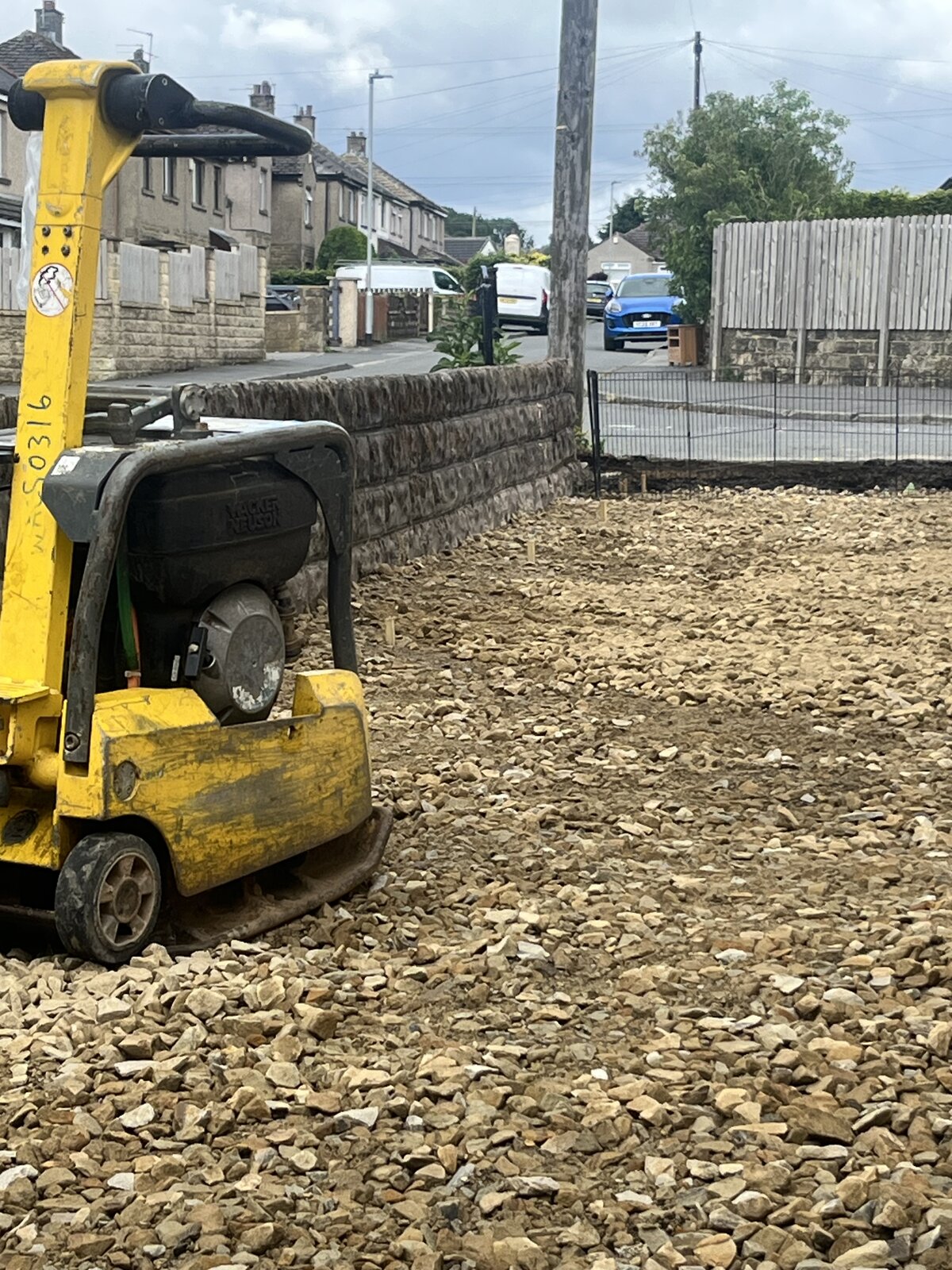

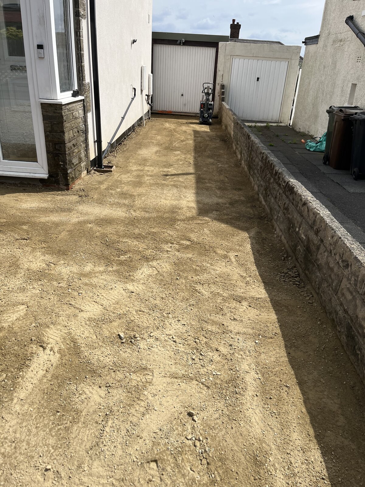

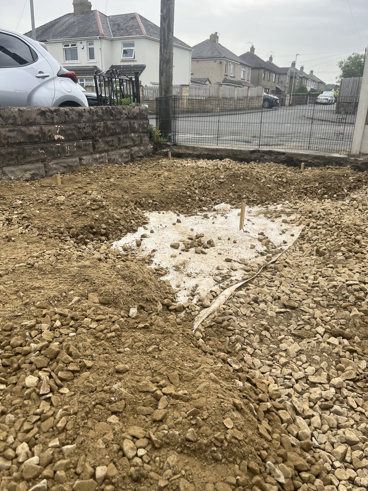

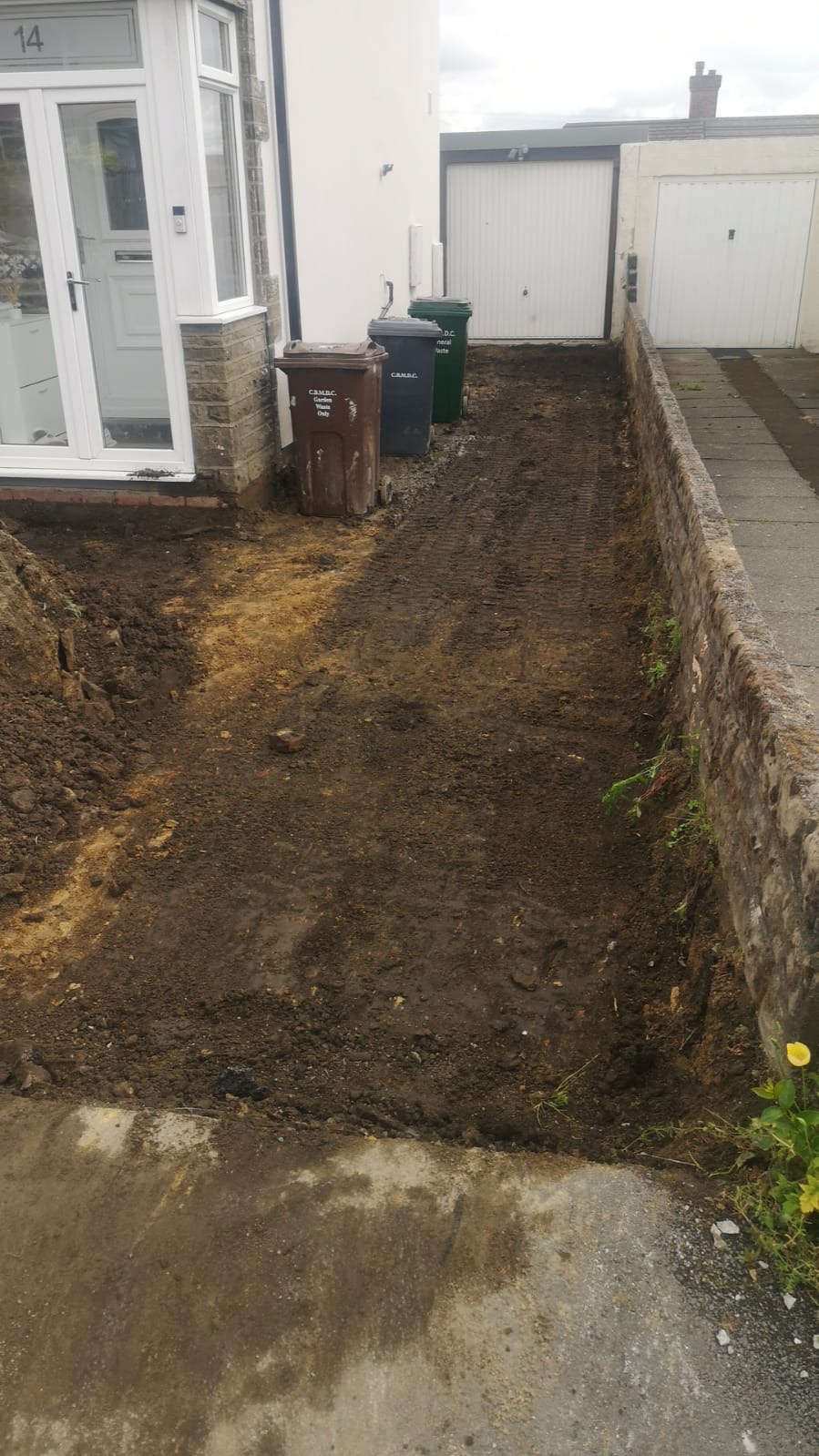

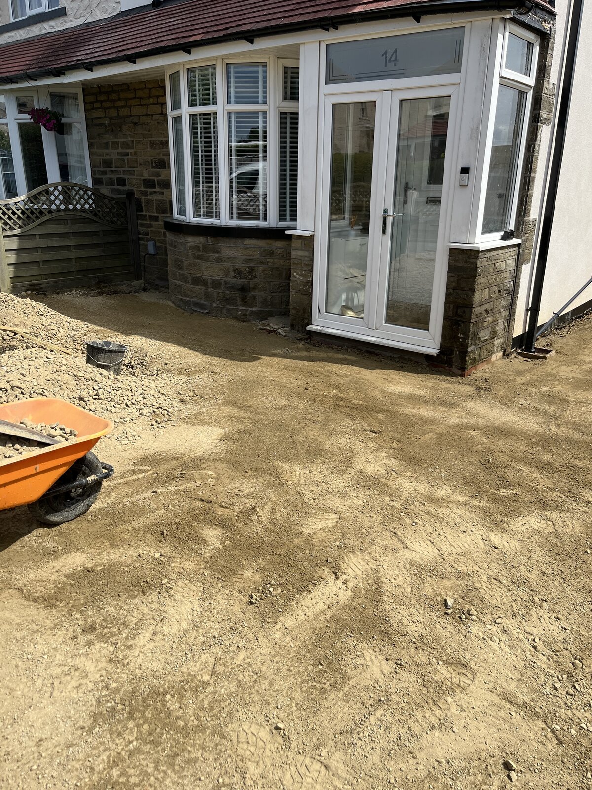

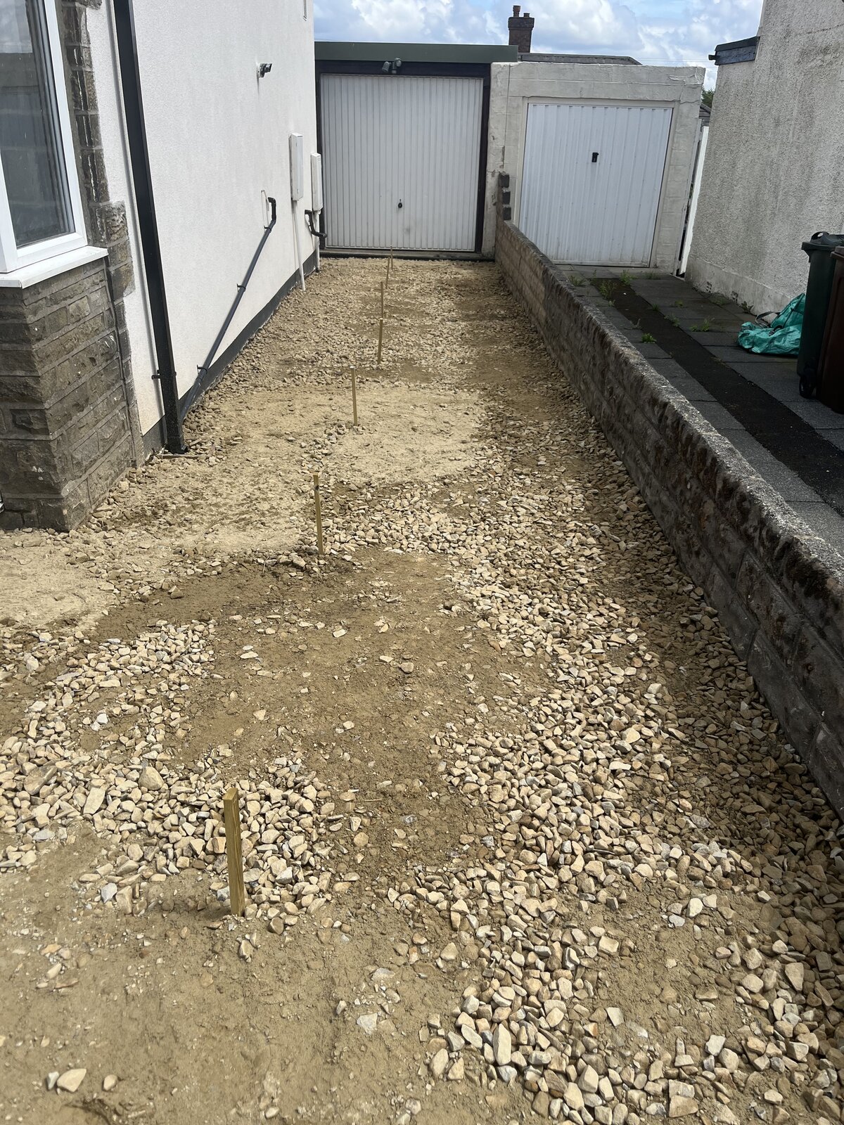

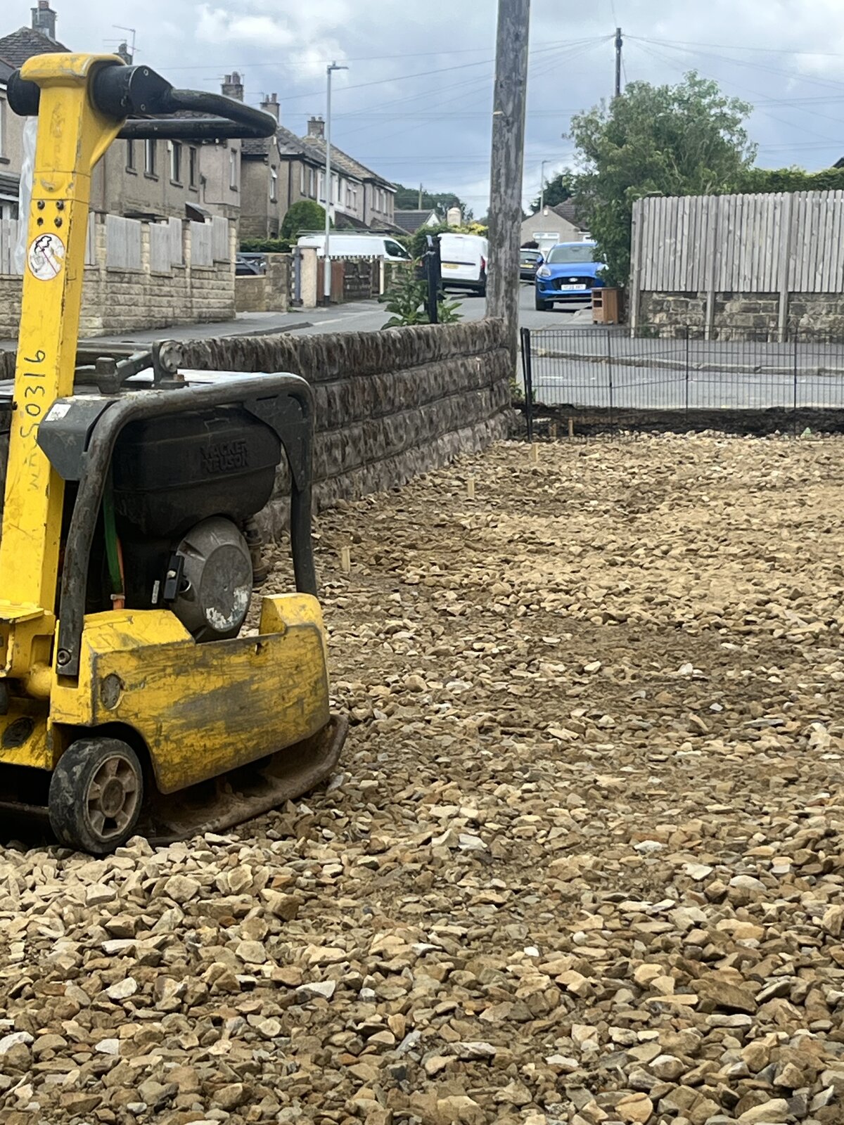

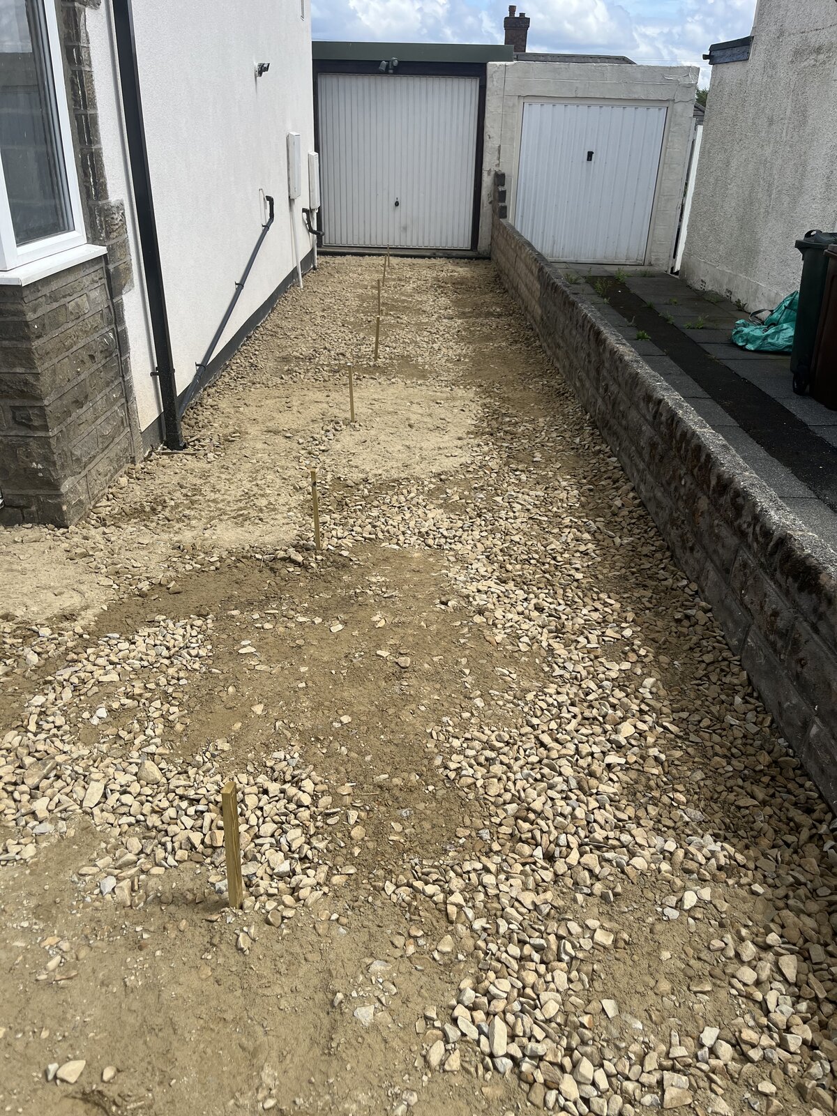

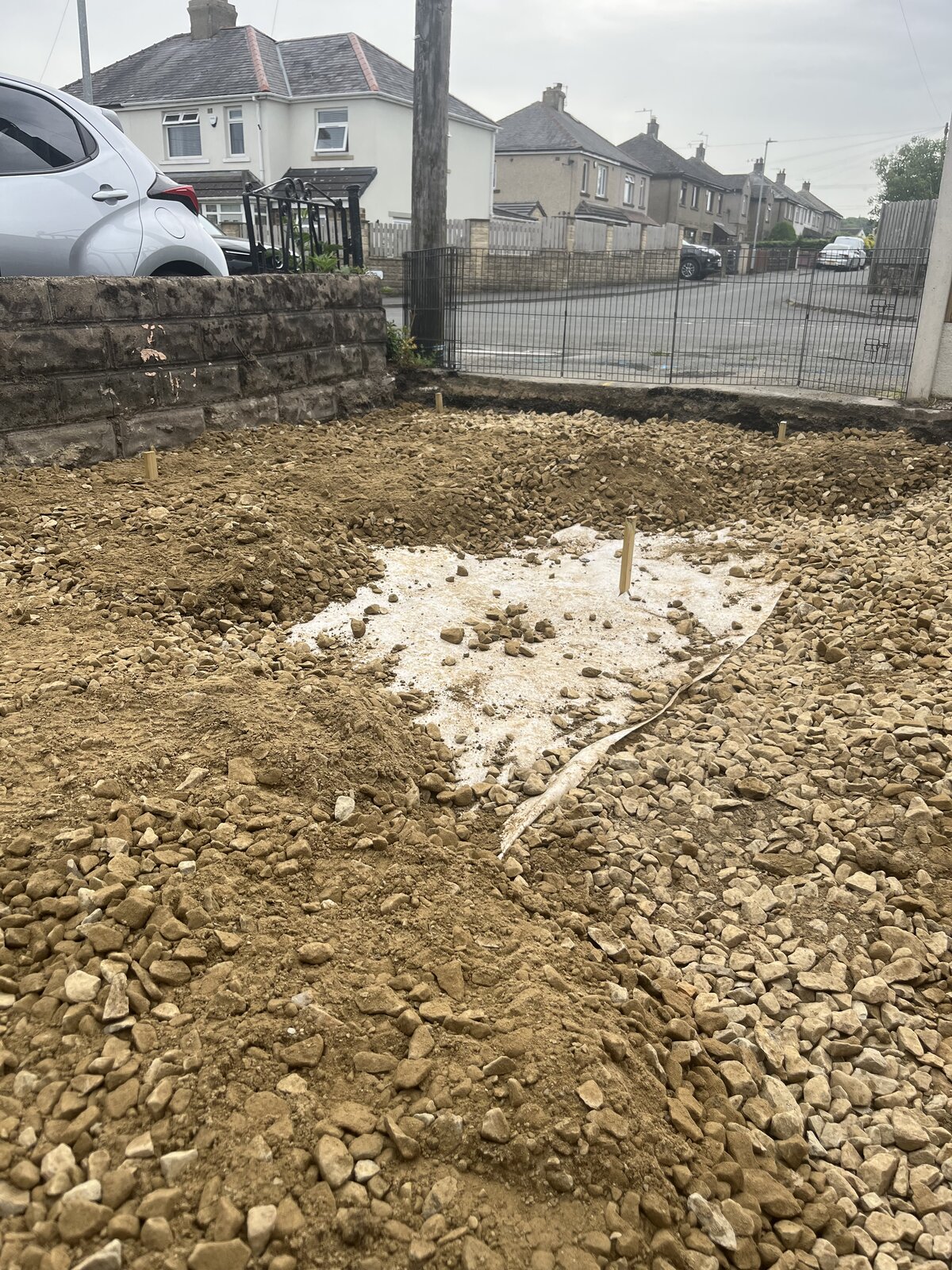

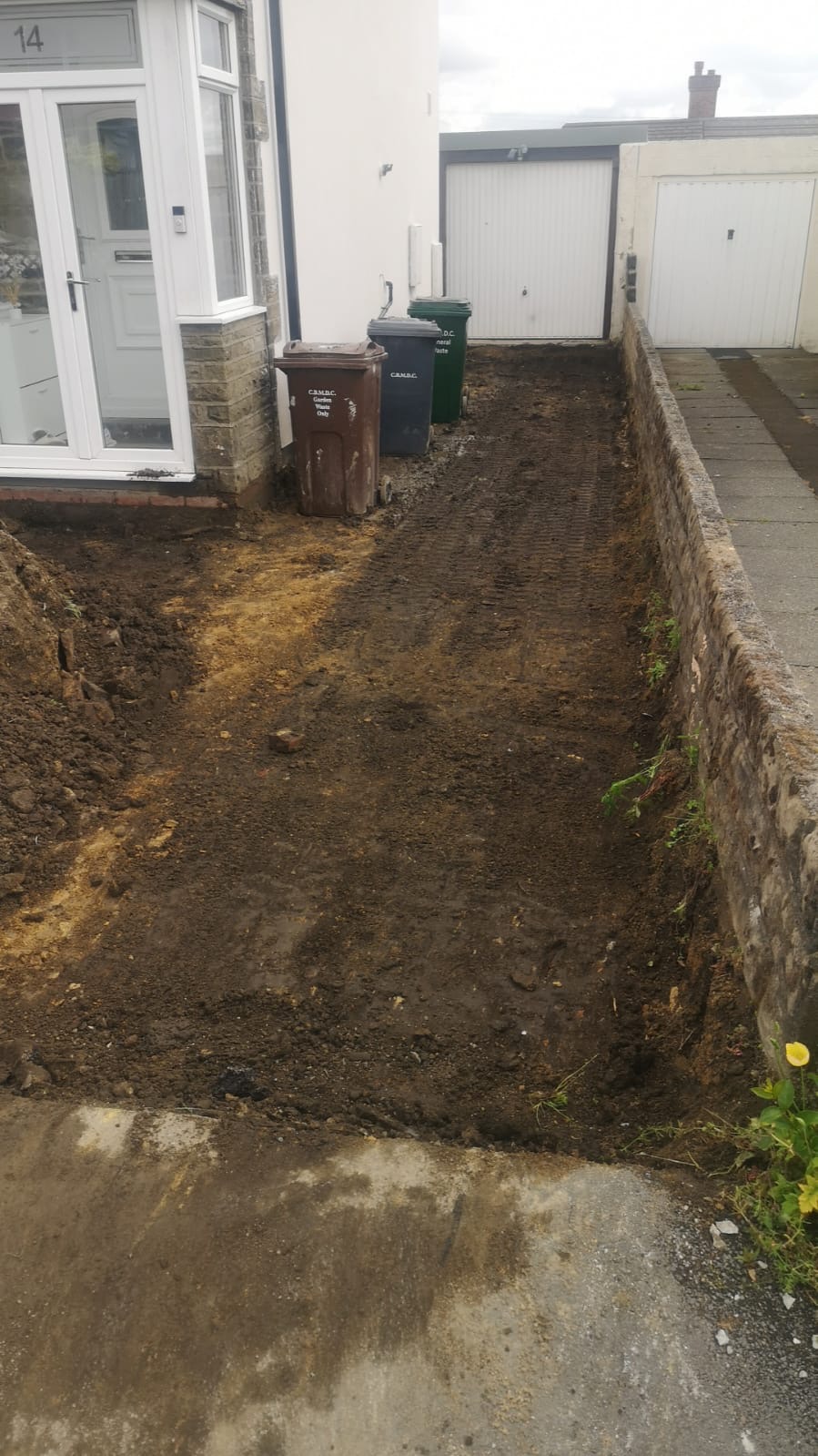

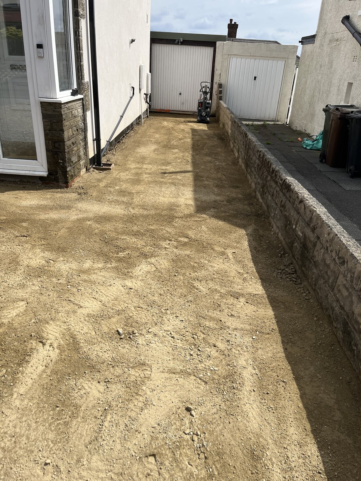

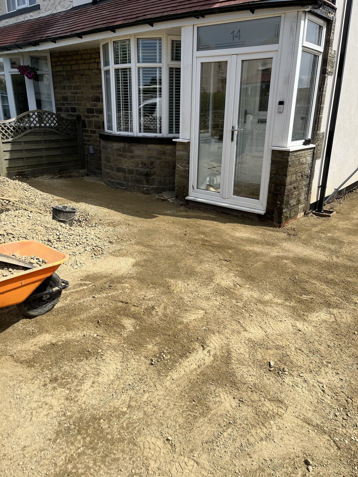

I’ve dug out and put down a type 1 sub base for a new drive.
250mm dug out and a membrane put down before refilling and compacting the type 1 in layers.
We have had some heavy rain the last couple of days even though it feels solid under foot, the top has gone a bit mushy.
I’ve put a tarpaulin over it for now to stop us getting mud everywhere but wanted to check this wasn’t an issue.
It’s probably going to be left for a couple of months before been finished that’s all.
I’ve attached a couple of pics of the sub base before the rain came.
