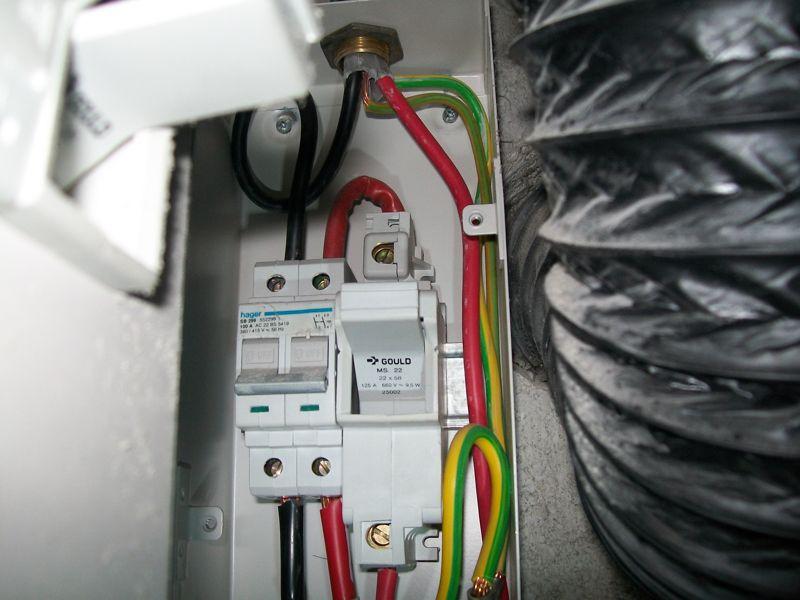

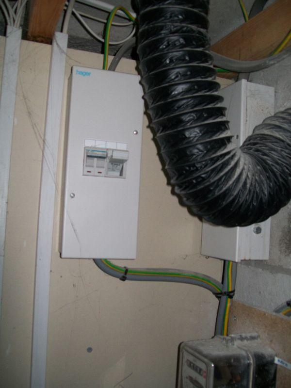

This is what was installed to feed my flat - and the electrician pointed out that it should have a 6A, not 80A, fuse installed when I had the installation tested recently (only been like that for the 18 years since it was built)
I'd have thought that a box containing multiple sets like that (4units per submain) would minimise wall space used.
Thanks for your interest and suggestion. You presumably don't mean 6A - did you mean to type 60A?
63A actually - no I didn't really mean 6A :rolleyes:
