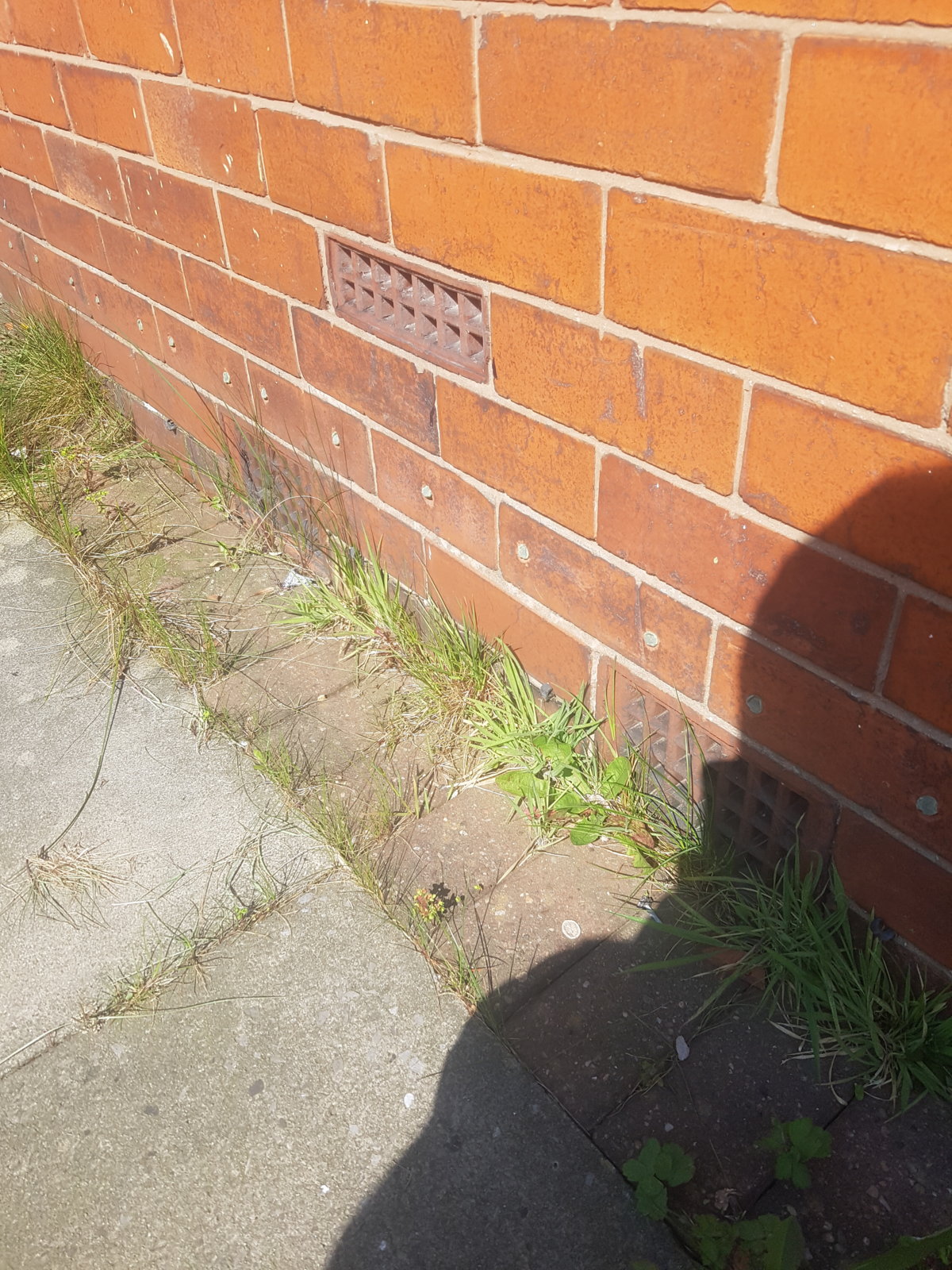

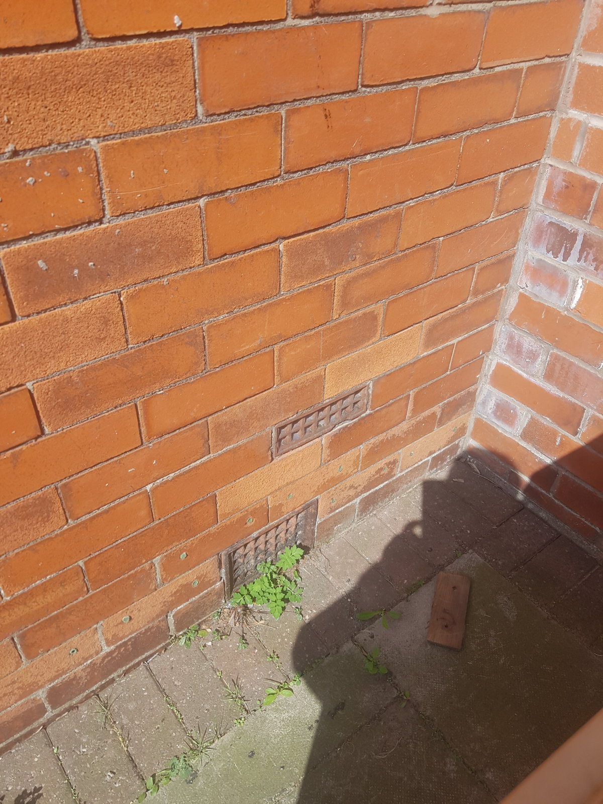

These are the two at the front and one at the back

Michaelsf90, good evening.
OK I am now confused, no a rare occurrence.
in one of the images posted there are indeed 2 air bricks, but they appear very close together and at differing levels, are these the 2 at the front?
Ken
The one higher up I'm guessing is for air flow in the cavity wall. If you look carefully there is one to the left of the one at the bottom. Still very close together tho
Michaelsf90, good evening again.
As a general rule cavities should not have an air flow, any large air flow will reduce the ability of the cavity to assist in keeping the property warm, a static un-vented cavity will keep the property warmer than a cavity with a howling gale passing through it?
To allow air bricks to function as intended the air bricks should be spaced out along any elevation and around the entire property, for example having three air bricks within 2 meters of each other on a gable measuring [say] 10 / 15.m does nothing at all for underfloor ventilation.
Another consideration is the underfloor compartments where the dwarf walls criss cross the property and are there to support the timber floor joists, these walls are honeycombed, not solid so there is a slow air flow between the various compartments under floor
In my opinion you need to locate the underfloor areas and introduce at least one air brick into each.
Ken
