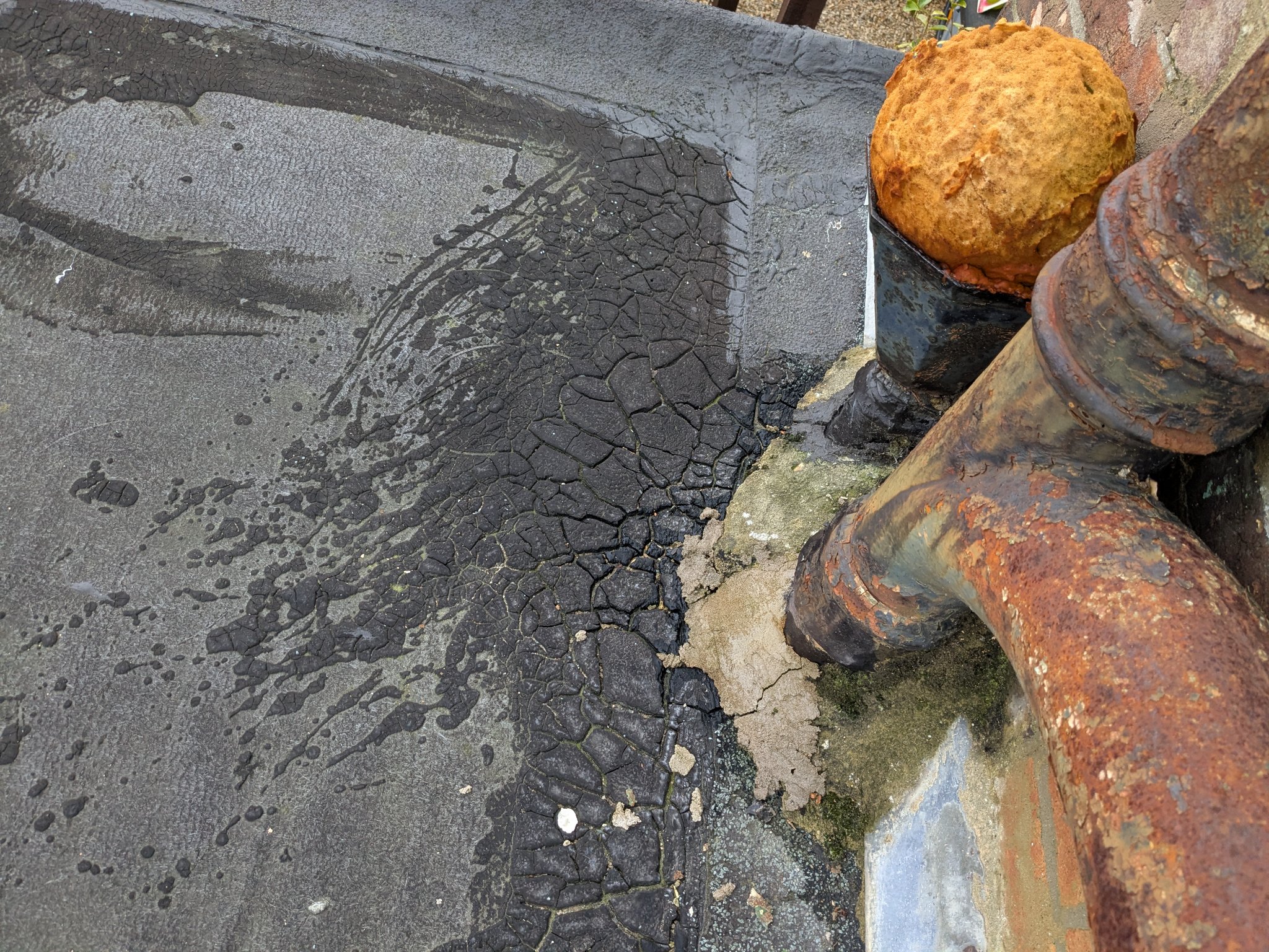

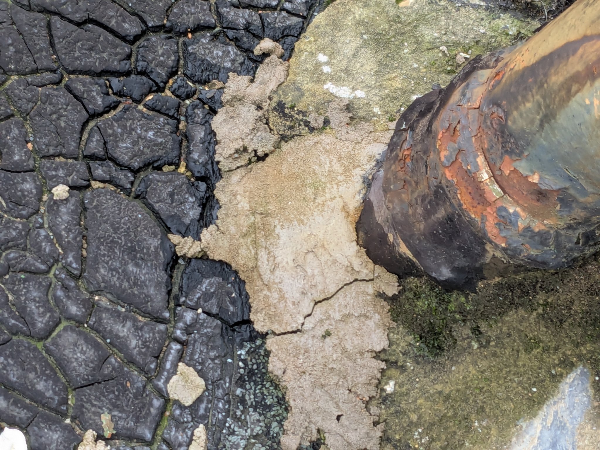

All,
I have an old old flat roof with a soil pipe flush against the brick wall. Whilst it's probably not leaking I know it's not the best.
Any suggestions on doing my best to make it leaky-proof-ish?
I know the roof needs replacing but I am not in a position to do so as yet
Any ideas at all?

You can't make the pipe penetration leak proof when the roof is in such a state
Acrylpol (and flashband). Buy a big tin and do the whole roof.

Flashband over any pipe joints, pipe to roof junction and any potential movement joints as reinforcement, then acrylpol over.

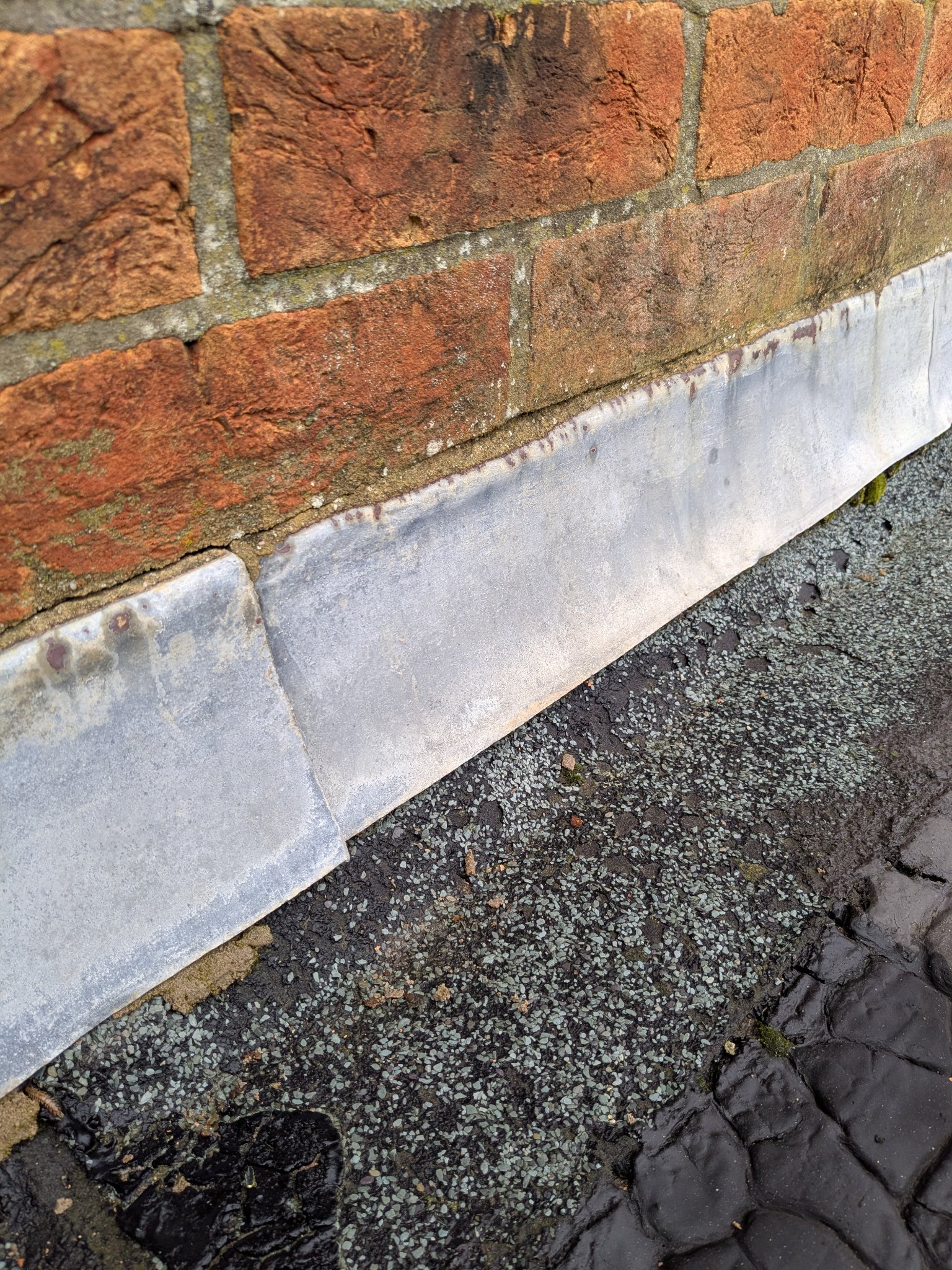

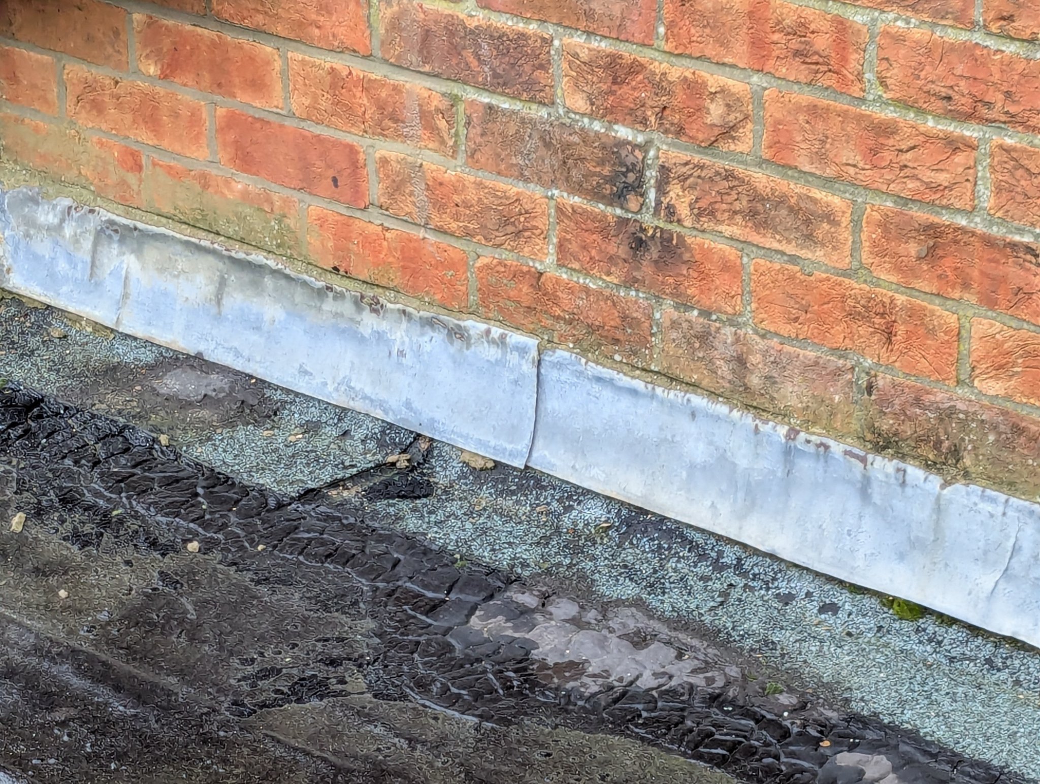

I managed to get up on the roof for a better look.

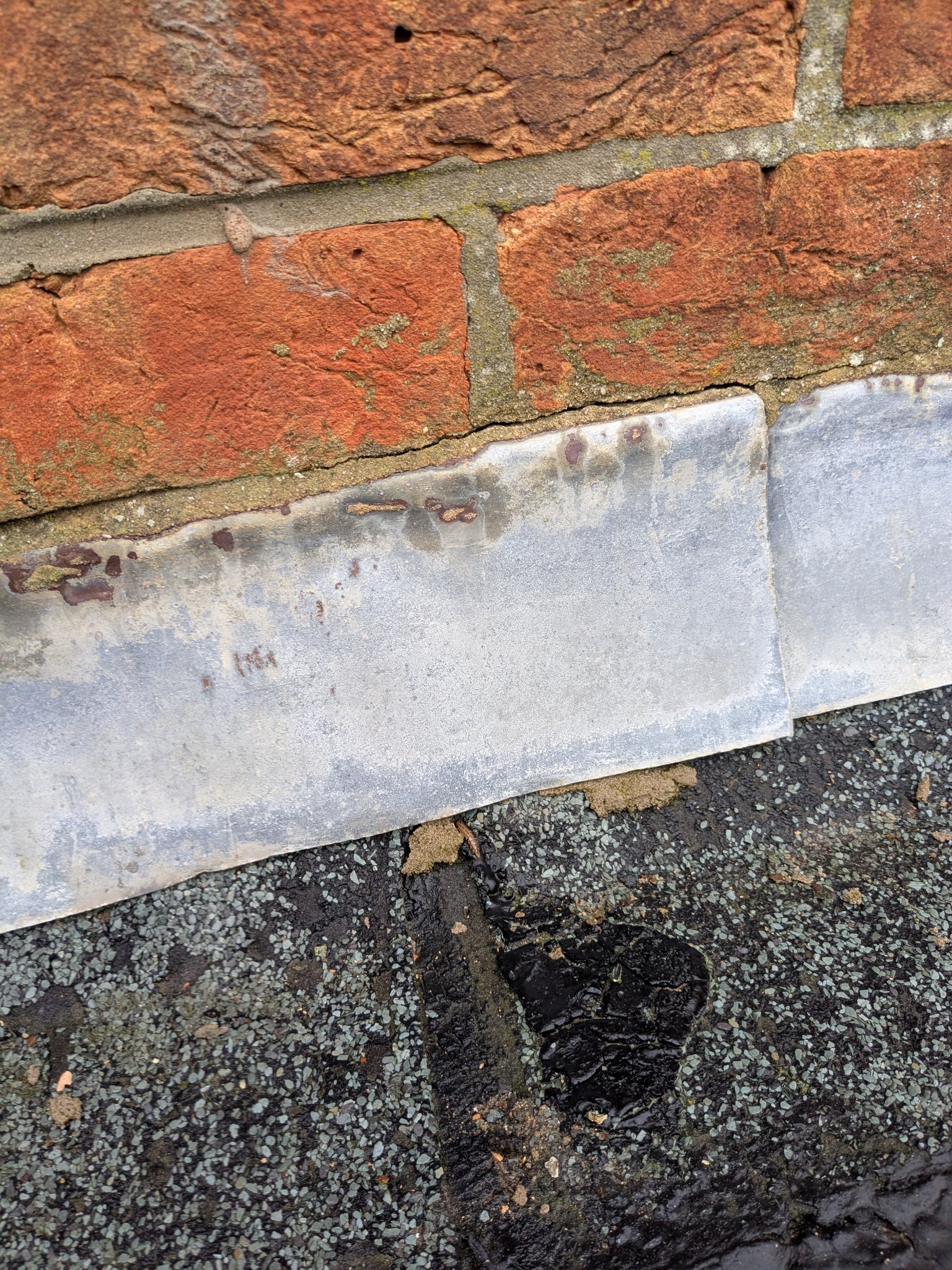

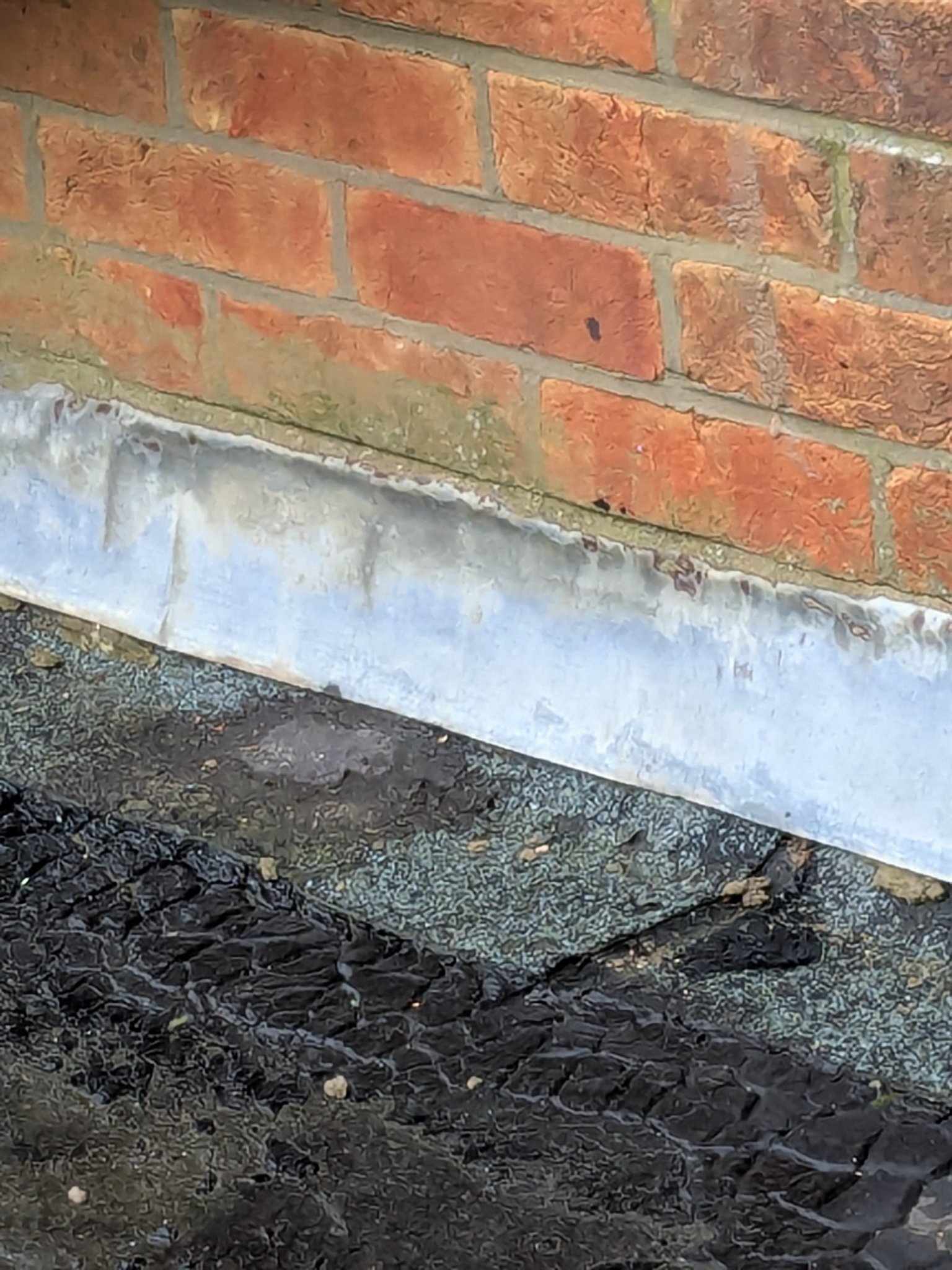

Ancient asphalt roof aside - I note the mortar in the flashing is cracked roughly near where the leak occurs ( only during excessive rain ).
The lead doesn't move much at all without poking too hard.
The lead looks similar to these photos all along - only 7m.

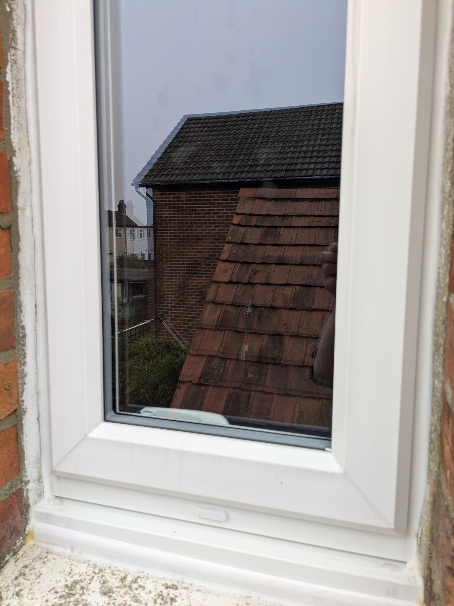

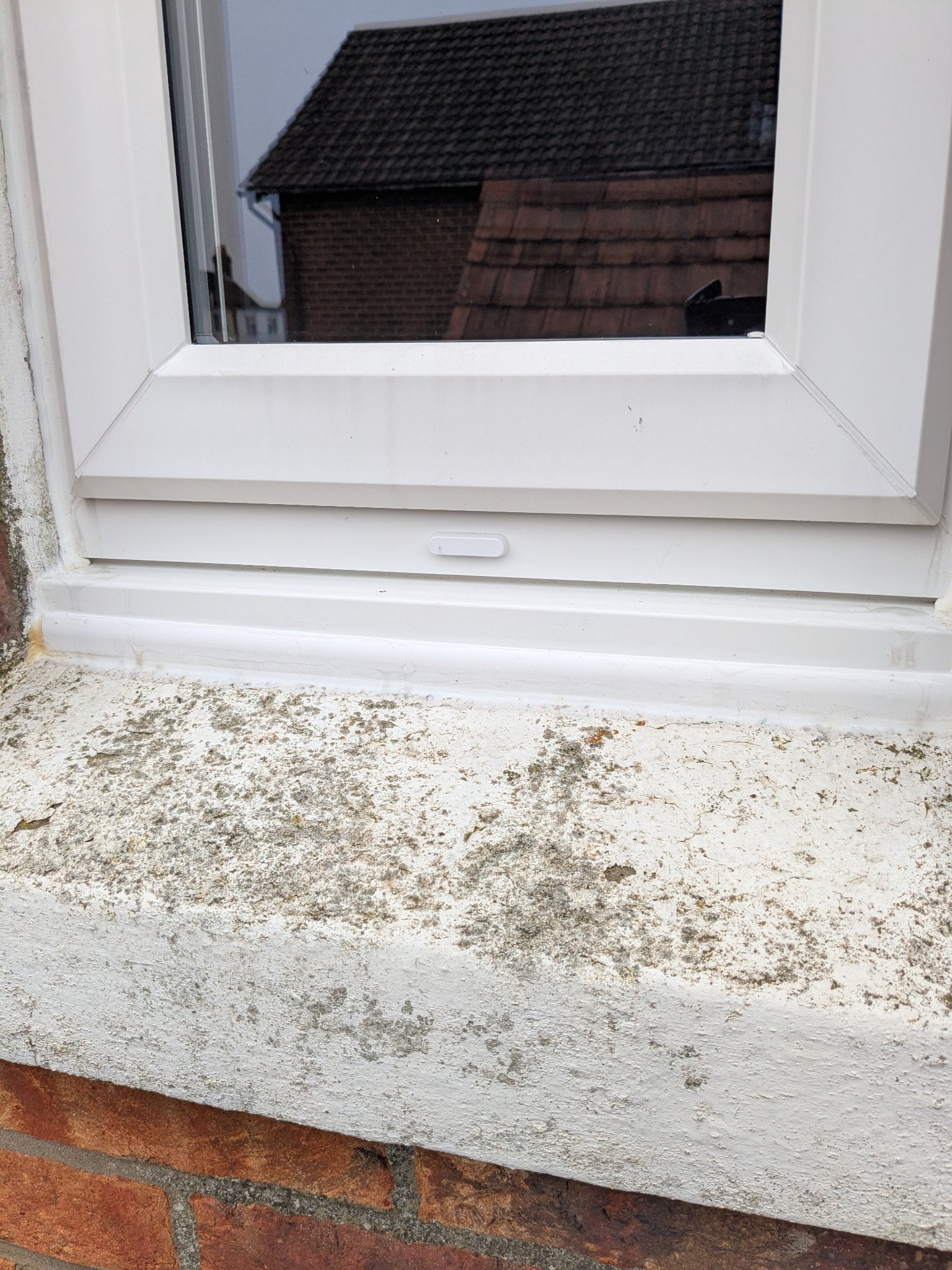

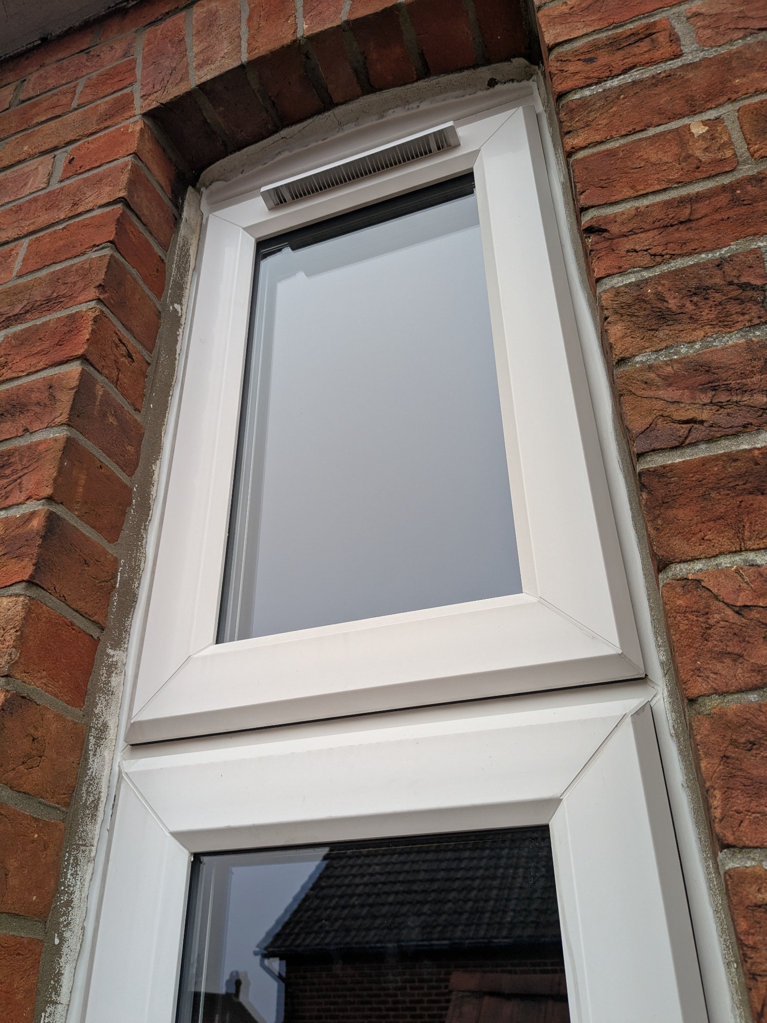

Having said that a brand new window was fitted and all of a sudden there's a leak. Window looks sealed sufficiently.
Do you reckon this lead has another year or so life, or am I better of replacing the lead as the mortar needs to be redone?
I see there are differences in opinions - leadmate sealant all the way or leadmate at the back of joint then finish off with cement mortar.
The pointing and internal walls in this property seemingly are lime based. The mortar fizzles with vinegar.
Should the mortar for this flashing return to being lime based, or does it not really matter?
Any thoughts at all?

Build a box around it . Weather that to the felt roof .
It's not difficult to incorporate a lid for future access
