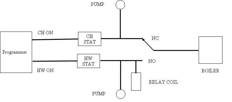

Ch ON programmer contact goes to roomstat, switched live of roomstat goes to NC contact of a relay as well as CH pump.
HW ON programmer contact goes to HW stat. Switched live from this goes to HW pump and NO of said relay. Relay coil (240 volt) is connected to this point as well. Alternative if using 12 volt relay is to use opto isolator for mains isolation with LED side having suitable dropper resistor and diode. Again, details available
C of relay contact goes to boiler.
Doesn't that just give you either heating or hot water; you can't have both at the same time?

DH, draw what I wrote and see for yourself. As a registered gas installer I have used this setp many times, though it is for gravity HW system. Circuit described is slight modification of gravity HW setup.
OK then, here it is:

I don't think DP's drawing is the clearest but his description is correct and will allow hw and ch at the same time.
Follow his description and draw it out and it all becomes clear. :wink:
The penny's just dropped. :lol:
I was concentrating on when the relay was energised for HW and forgetting that the CH pump could still work as it's before the relay. It's a bit like a Y-plan in that the HW Stat controls the boiler when both are on.
