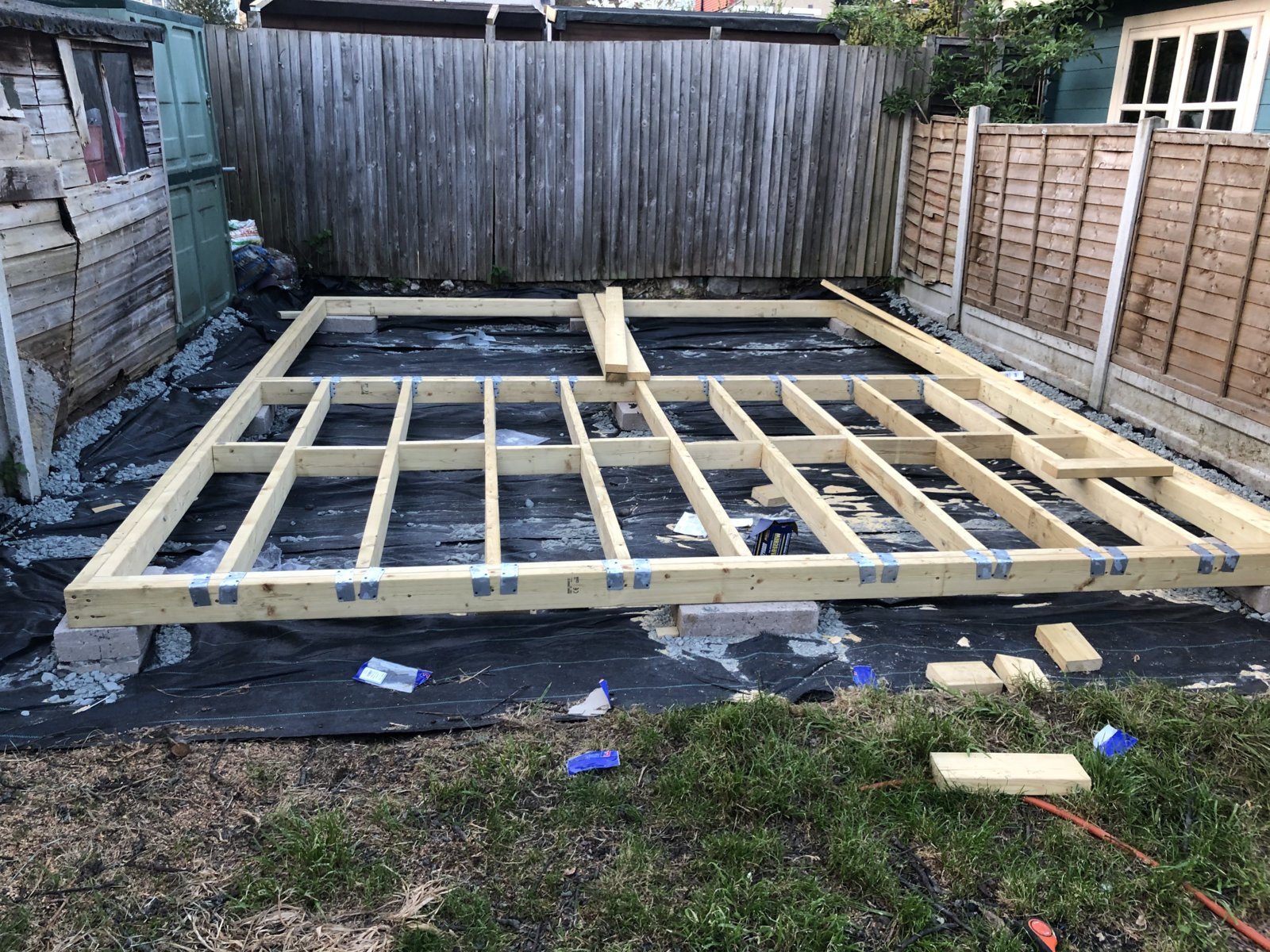

So I’d need building control then as I’m within 1 meter. So they’d prob make me start doing extra things or not like something I’ve done.
So far I’m at this stage
Just waiting for a wood delivery on tuesday
2 Jan 2015
91
London
View attachment 188694 So I’d need building control then as I’m within 1 meter. So they’d prob make me start doing extra things or not like something I’ve done.
That's coming on well :)
What's the internal floor area in square metre's?
If it's less than 15 Square Metres then guides say building regulations do not apply.
Also, if you can keep it under 2.5M in height from floor to the flat roof then guides also say you need not apply for planning permission.
To recap :
1. If it's less than 2.5M in height total then PP not required.
2. If it has less than 15 Square Metres internal floor space the BR not required.
So if you tick both to above, build and enjoy.

I’m 20sqm 5x4
I might try keep it at 2.5 but I’m 6ft4 so need to see what head room I’ve got.
