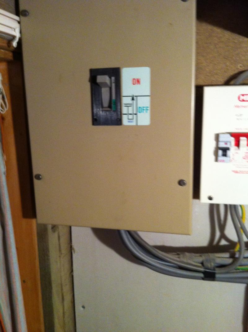

Personally I would try and split the outbuldings up into two separate circuits from the house (maybe make both single phase circuits but on different phases?). This would eliminate the second crossing of the road, reduce the demand on any particular circuit and reduce the length of the longest circuit. BTW it is perfectly fine to cleat SWA to the outside of buidlings.
More detail on each of the boards (photos if possible) especially the main board in the house would be useful if you want advice on how best to make connections. It would also be good to know the size of connection from the garage to the cottage.
It would also be useful to have a list of what equipment you have in each outbuilding and what the buildings are used for. Is there any electricity supply to the barn at all?
securespark, why do you recommend changing the existing TN-C-S supply to TT ?
what's wrong with extending the earth conductor from the existing distribution board?
There are a couple of things you need to be aware of if you do use the PME earth for outbuildings.
Firstly if main bonding is needed in the outbuilding (it will be if there are pipes coming in from underground) you need to make sure your earth is up to main bonding standards. Assuming this is a fairly normal sized supply and you use 10mm or 16mm 3-core with a core as earth this shouldn't be a problem.
Secondly TN-C-S isn't reccomended for farm buildings because voltage gradiants in the earth can have a bad affect on livestock. I don't know if this is an issue for these particular buildings.

I plan to
select the most underused phase inside the big brown breaker thing I posted just now.
take 16mm2 tails from it to a 100A switchfuse which I will mount adjacent.
from the metalclad 100A switchfuse I will route 15 metres of 3-core 16mm2 SWA out to the adjacent shed.
In the shed, the SWA will terminate in a lockable steel box where I will mount 3 x 5-way 100A marshalling blocks (Line, Neutral & Earth).
These marshalling blocks will then supply:
a consumer unit in the shed they are in, located a few yards away. Ill get to it with meter tails.
and
a consumer unit in another shed. This shed is 10m away, and I plan to get there with another run of 16mm2 SWA.
Please comment on my plan!
I'm not too worried about strict adherence to the 16th edition, due to the extremely remote (offshore islands) location. But I am concerned about practical/safety aspect, and doing the job (fairly) well.
NB there are no livestock involved in the sheds, However there is a shower-room in one of them.
there is no gas or oil plumbing on the site.
all comments gratefully received.

Why not take out three phase? Seems a much more sensible idea and future proof. Cost difference between 3 and 4 core SWA is minimal
anyone know the accurate name for this (the big brown thing)?

That's a single pole moulded case circuit breaker, but the advice you have been given is spot on - you sound out of your depth I'm afraid.
