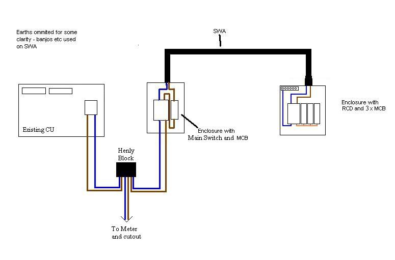

Running power to my shed using 4mm SWA - was going to use the setup below and would like to know if it is ok.
I will take the supply to the 1st enclosure from the load side of the CU switch (no spare ways) - this will supply an RCD (30ma 60A) and feed a 32A MCB.
SWA to 2nd enclosure supplying a 20A and 6A MCB - neutrals connected into chic block.
Earths will be in choc blocks inside enclosures (inc earths from banjos etc)
Is it ok to connect the neutrals and earths this way?
