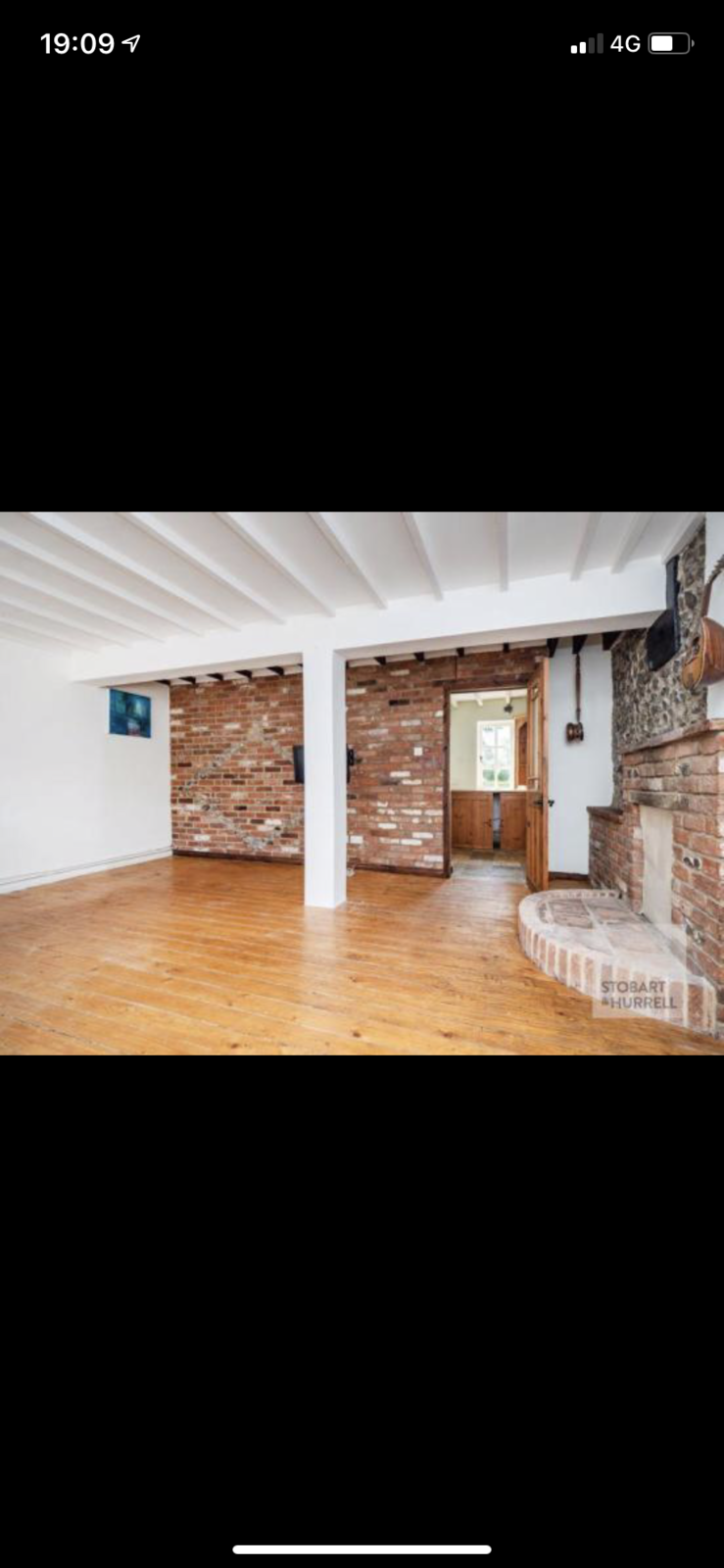

We are in the process of buying a 300 year old cottage and there is a vertical pillar supporting what I presume is beam or RSJ.
Would it be possible to replace the beam/RSJ and do away with the support pillar? Please see attached pic.
Obviously understand it will need a structural survey but just interested in people opinions and experiences.
Thanks in advance
It's probably a timber beam, as a steel beam that size would not need a central support.
Straightforward job to remove the post and beam and replace with a steel beam.
What section size of steel beam you would need depends on the span of the floor, and if it is carrying any wall upstairs. Quite possibly, a 203 mm deep steel beam would do.
It's there for a reason.
But ultimately, anything is possible if you throw lots of money at it.
