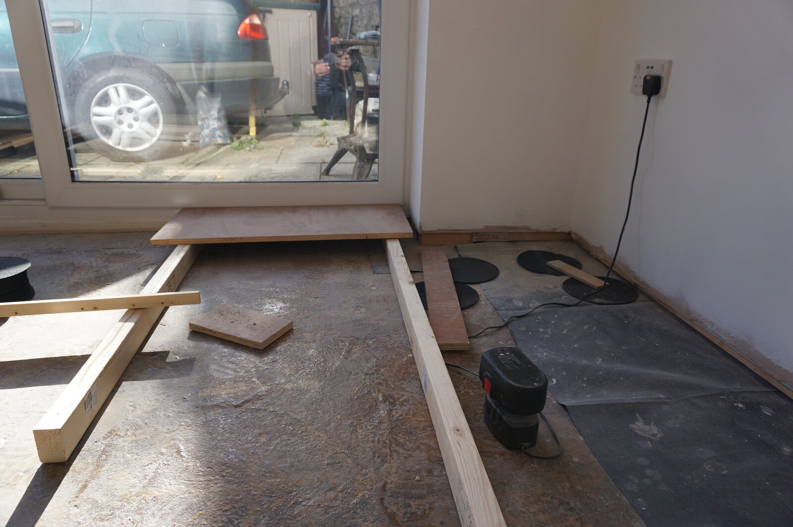

There's a clearance issue I need to create a small shallow step/tray local to the window frame btm, stepping up, to allow all 63x38 CLS sections to be vertical. Snagging. It gets deeper off to the left.
Build the frames, chock to correct height and see which decking support pedestals are reqd? Or is there a cheaper method? How was it done before decking pedestals arrived on the scene? Pedestal bases can be screwed down.
How much ply is generally allowable to overhang the outside of the frame?
I got some of these in, probably made of recycled car tyres, chopped up, wire removed, formed under heat/compression. Quite dense.
https://www.roofingsuperstore.co.uk...r-base-plate-for-pedestal-200mm-diameter.html

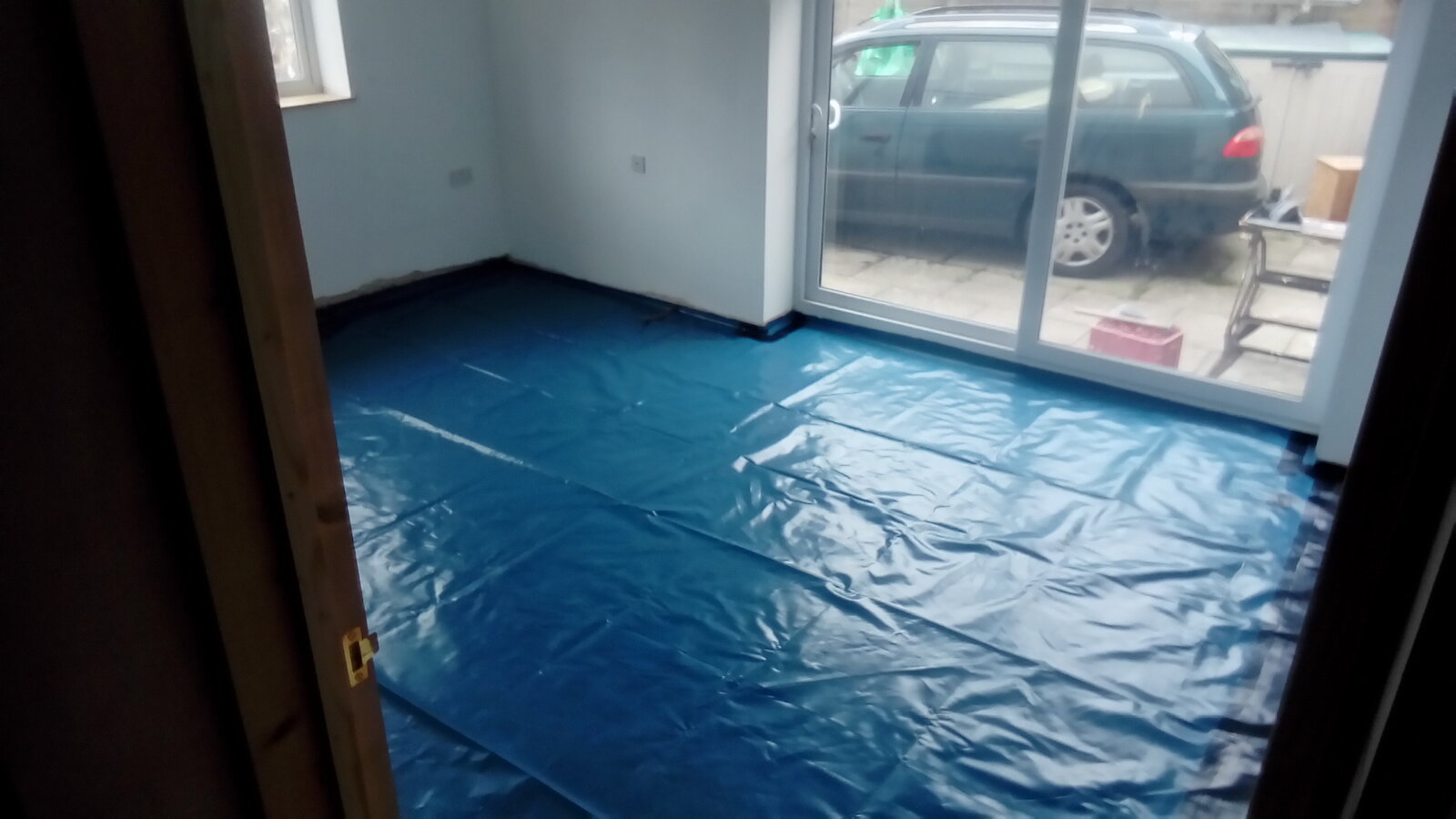

Conc. base has 2 coats of Sikha Rapid, I'll membrane over it, too.

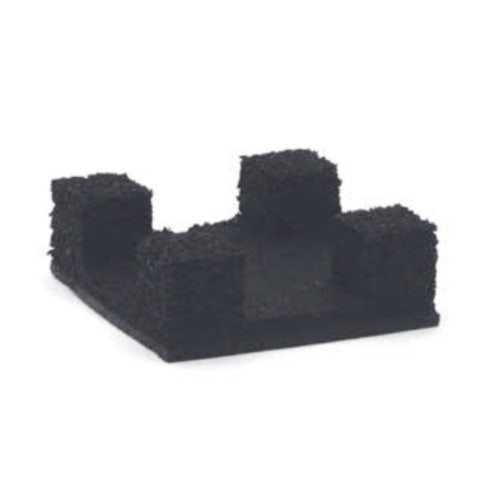

I'd still go with the rubber "castles" because they offer a degree of thermal separation from the concrete floor. They really don't need fixing down if the joists are tied together with solid strutting and the plywood is glued down
Is "castle" a generic term for a joist cradle or pedestal? Possibly because some of them resemble a castle on a chessboard?
I did a quick search. I couldn't remenber the name of the stuff we've been using (on leave at the moment), but RynoDeck like this is similar:
You can see why we call them "castles" now, I hope. The main differences being that the ones we use are a lot deeper - about 10mm - and they are part of a system which includes fixed thickness (10 and 20mm) packers for use beneath the cradle and the manufacturer also supplies 2, 5 and 20mm flat shims which sit inside the tops of the castles

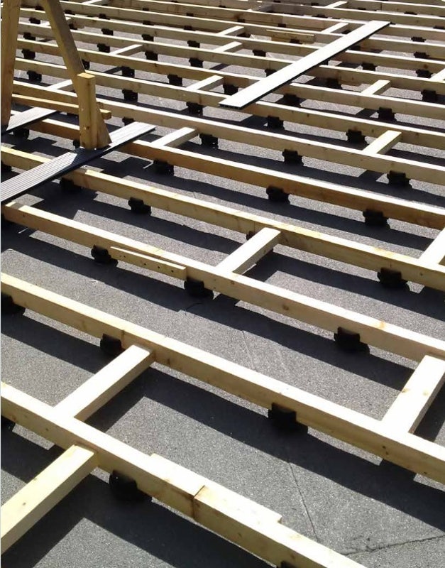

From the same manufacturer comes this illustration of these in use:

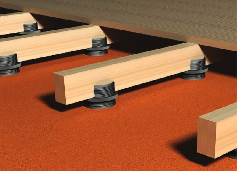

They also make a variable height version with a screw adjuster:

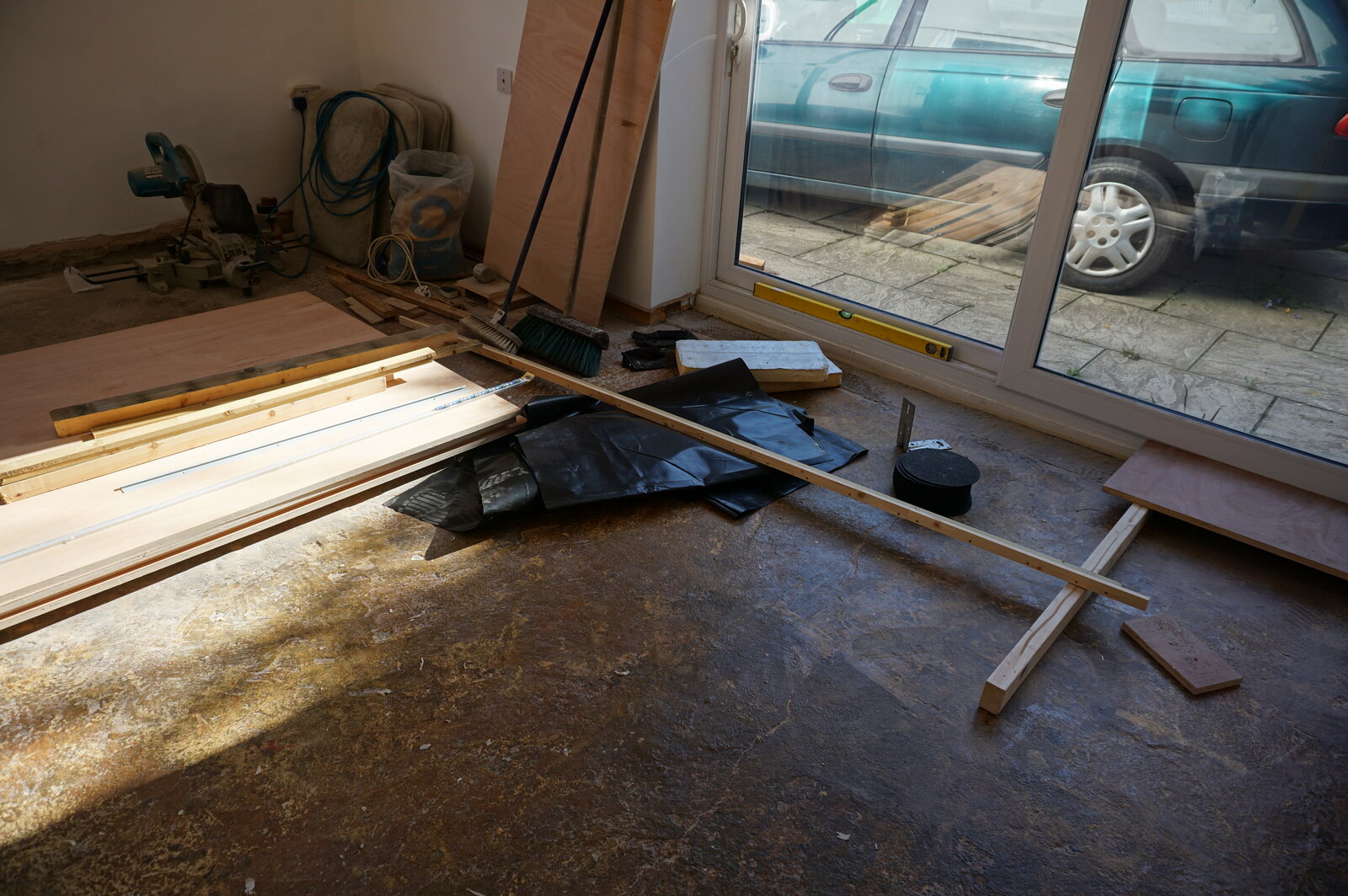

So anyway, I bought some 63x38 and 89x38. I'll get a few chocks and a long bubble and see what's what. There's 2 coats of Sikha Rapid damp seal on the conc. substrate under that membrane. I might use brackets at reccomended ctrs, with rawlplugs (6x35mm or 6x40mm) but cut plenty of short sisters to screw to the sides of the CLS frames and take the weight? The brackets can set the frame & prevent it moving but I don't think they'll be taking much weight once there's planty of sisters added. Maybe a splash of Gorilla in the holes before the plugs go in.
