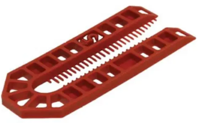

TBH I'd be fixing my timber packers down to the concrete sub-floor, then foir fine adjustment I'd use plastic packing shims - the sort used for door and window insallation, like horseshoe packers:
or these glazing packers:
You can buy these in a variety of thicknesses, from 1mm up to 10 or 12mm, and they are often sold by builders merchants as mixed bags of packers. One well known brand is Broadfix.

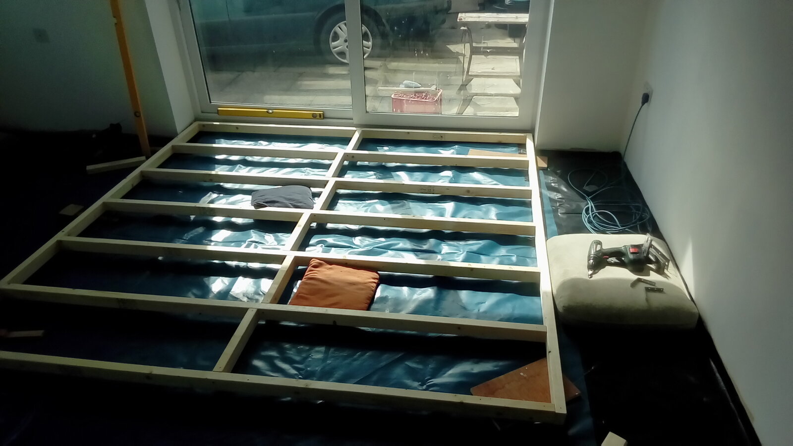

Frame sits in door reveal nicely but could rotate 90? Far/outer wall is 5m, on the right is 4m.
I thought setting top of ply to underside of the 10mm uPVC P_20220409_112806[1].jpg P_20220409_112338[1].jpg threshold strip would give plenty for 6mm click vinyl/edge strip.
Left side of frame is sat on 2x15mm architrave offcuts but still needs to drop a few mil.
Door frame rises to left slightly, floor rises to right..
terrible images but I've moved the frame out of the sun now.
