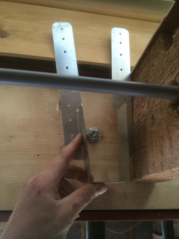

I'm making really good progress now. I've made good of the pillars at each end and now have a 145mm gap between the beams and top of the pillars. My padstones are 135mm high so just need something that's 10/11/12mm to go between before I sit them in place. I will be sitting them on a bed of mortar but due to the weight there's no way they will sit properly if just on mortar.
I'm having abit of trouble getting my head around the joists hangers. The joist hangers I've got are far taller than the timber inside the web and the floor joists themselves. I have read before that every hole in the hanger needs to be fixed with either twist nails or screws.
Here's my dilema
Above the beams is two bedrooms, one is finished and one is not. Can anyone offer advice on this please?
Many thanks
