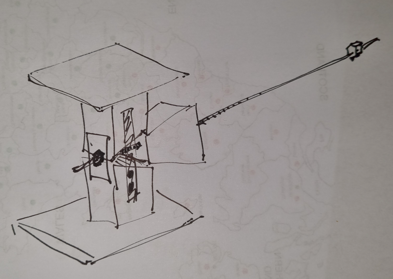

So, the joists are marginally sized, and the floor is a bit bouncy. I think, with a small access some lateral thinking is needed. An idea that springs to mind is to make up some custom jacks for each area with a top and bottom base plate, folding wedges between and a long piece of threaded bar to both push the jacks in to position and then spin them to pull the folding wedges together and raise the jack. Bit of knife and fork engineering needed. You could custom build them for each position at different heights.
bit like this

I like this idea but can’t quite work out what I’ll need to do it. Would you be kind enough to treat me like an idiot (!) and give more details please?
I think you'd need to experiment to get the best design, but essentially a wooden post cut so there is a folding wedge, a plate top and bottom to spread the load and make it so it doesn't topple over, and a threaded rod (which you can buy from the builder's/engineers merchants in various lengths) which with various lock nuts/welded nuts, washers and a bit of bracketry will close the wedges and raise the jack when turned with a spanner on the end. The wedge post will be very solid when raised.
Think I'd think about getting a 75x75 or 100x100 treated fence post to cut up. If you cut them to height so the wedge is 80-90% home when raised in the correct position, you'll get a very solid support. You'll need something to keep the top and bottom bit's of the post in line - bit of ingenuity needed - depends what access to tools you have.
