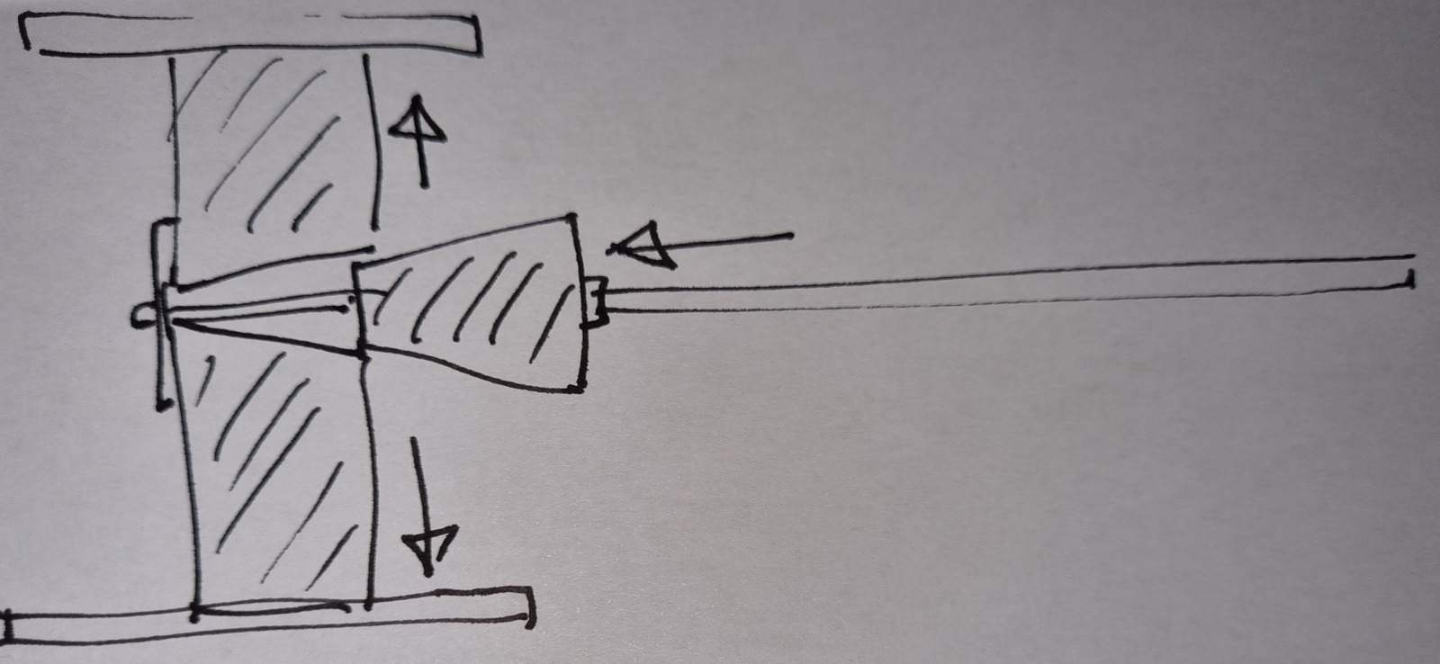

I think you'd need to experiment to get the best design, but essentially a wooden post cut so there is a folding wedge, a plate top and bottom to spread the load and make it so it doesn't topple over, and a threaded rod (which you can buy from the builder's/engineers merchants in various lengths) which with various lock nuts/welded nuts, washers and a bit of bracketry will close the wedges and raise the jack when turned with a spanner on the end. The wedge post will be very solid when raised.
Think I'd think about getting a 75x75 or 100x100 treated fence post to cut up. If you cut them to height so the wedge is 80-90% home when raised in the correct position, you'll get a very solid support. You'll need something to keep the top and bottom bit's of the post in line - bit of ingenuity needed - depends what access to tools you have.
Or even buy a few really cheap scissor jacks, and modify them so you can easily position them without toppling over. https://www.amazon.co.uk/Quality-Tonne-Scissor-Handle-Octavia/dp/B0721MSB52/ref=sr_1_97?crid=2XIGJI4LTSBDC&keywords=wedge+jacks&qid=1687162421&sprefix=wedge+jacks,aps,76&sr=8-97
the bit I’m struggling with is the timber post cut so there is a folding wedge. What hinges it?
Nothing "hinges" it - it's just a wedge which when pulled in by the threaded rod pushes the other parts apart. The wedge needs to be nearly fully home at the point the post starts to take the weight.
strictly speaking it's not a "folding wedge" which is a pair of wedges, but the principal is the same.
