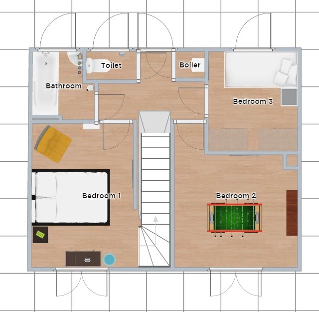

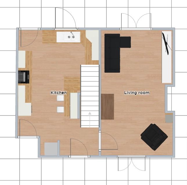

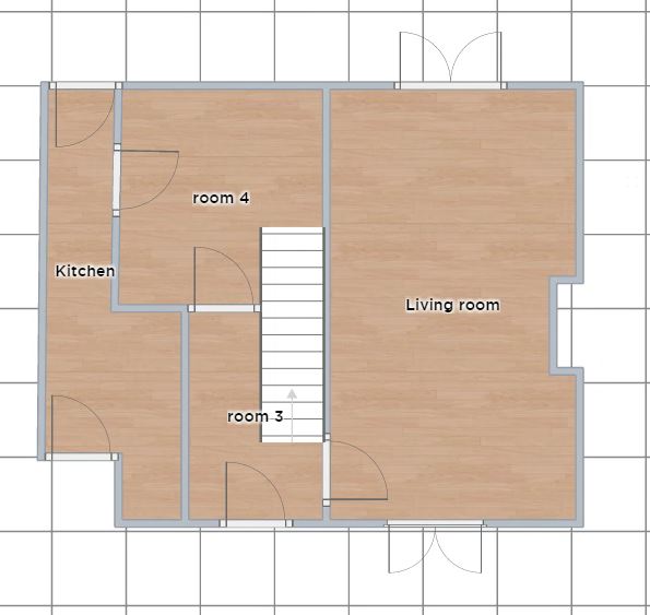

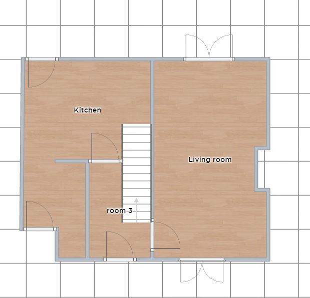

Hi All, just thought i would pose this question to the knowledgeable people on here. Please see attached pics. Eventually would like to remove the wall shown in the pics to achieve the layout in the NEW PLAN pic. However I wont be in a position to do this for another year or so. Until then I would like to remove the wall to achieve the same as the NEIGHBOURS pic. I would also like to remove the short horizontal section of wall to the left of the kitchen door. Both of my neighbours have removed the wall as shown and did not take any measures to strengthen it. One particular neighbour who was in the building trade said that the beams in the ceiling just meet the requirements for the distance of the left hand external wall to the centre wall. The distance is 3750mm and beams are 175 x 50mm. As the wall is a brick wall I was worried it may be a supporting wall but I believe as the house is 1950's build internal non supporting brick walls were common. I have also attached a view of the upstairs layout. Would love to hear some expert thoughts on this.

Googling says 47x170 @ 400 is OK for 3550.
So yes it's likely that 50x175 is OK for 3750.
Your proposed "new plan" will have fire safety issues; not insurmountable, but requires thought before you go too far.

Many thanks. If i only go ahead with knocking down the wall as per neighbours with the additional small section and leave the kitchen boor where it is now would this have any impact on fire safety as the staircase would have the same protection it has now?
