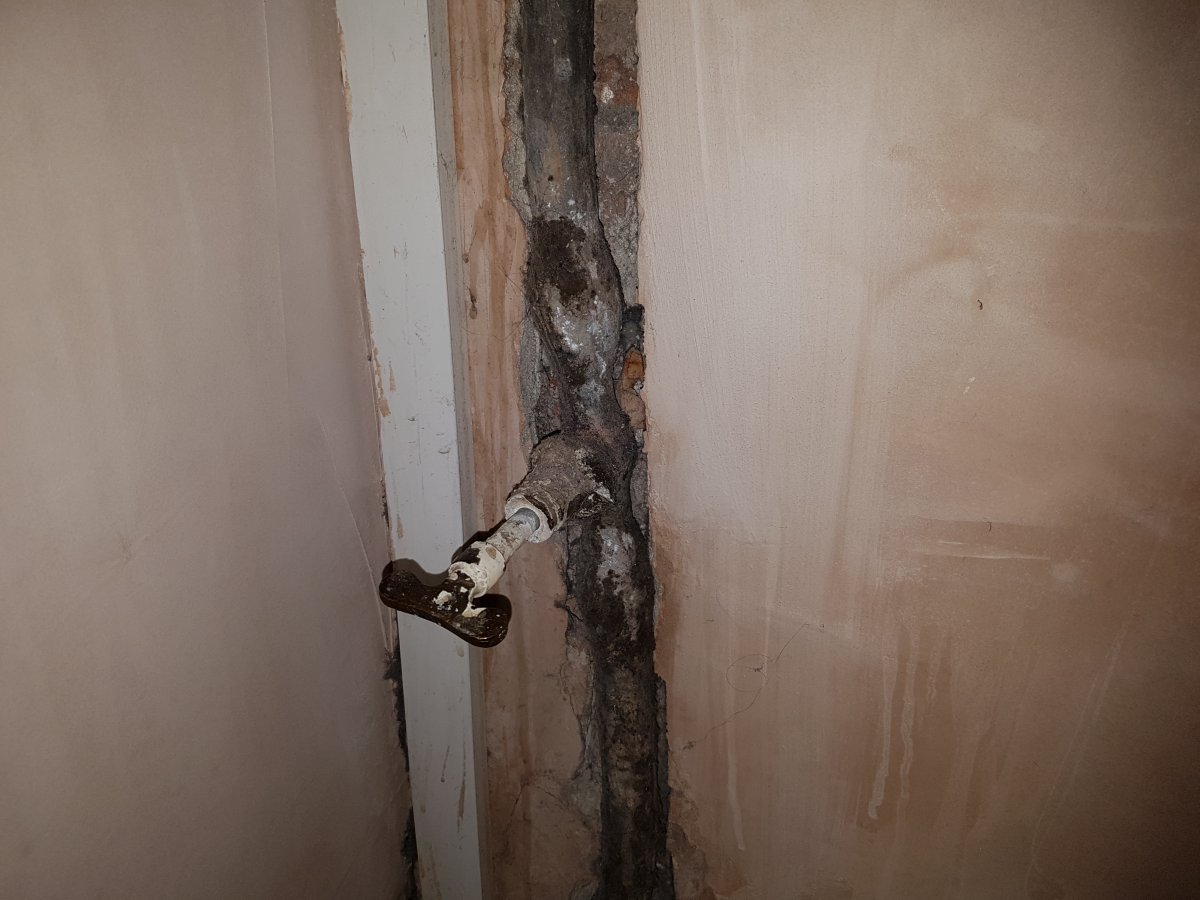

Take a look at the attached photo.
This is my stopcock looks like lead both sides. Located right behind the tumble dryer, a swine of a job when you need yo shut the water off in a hurry.
It doesn't fully close the water supply off. I've closed it and opened it a number of times but I think the stopcock valve seat or seal must be worn.
I'd like to fit a Surestop Stopcock but the All the Pipework is plastered into the wall so theres no accessable point after the stopcock to fit the push fit Surestop.
Any ideas?
that looks old!
can you turn it off in the street?
if so i would do that, then expose the pipework enough so you can get the lead cut, once you've cut it in half you should be able to move it a lot easier, and then use a Lead Loc to adapt it to copper, then fit your Surestop, i would maybe consider replacing the lead from then on with either copper or plastic, but that would depend on how easy it is to do. if you don't do that, you'll have to adapt it back to lead with another lead loc
