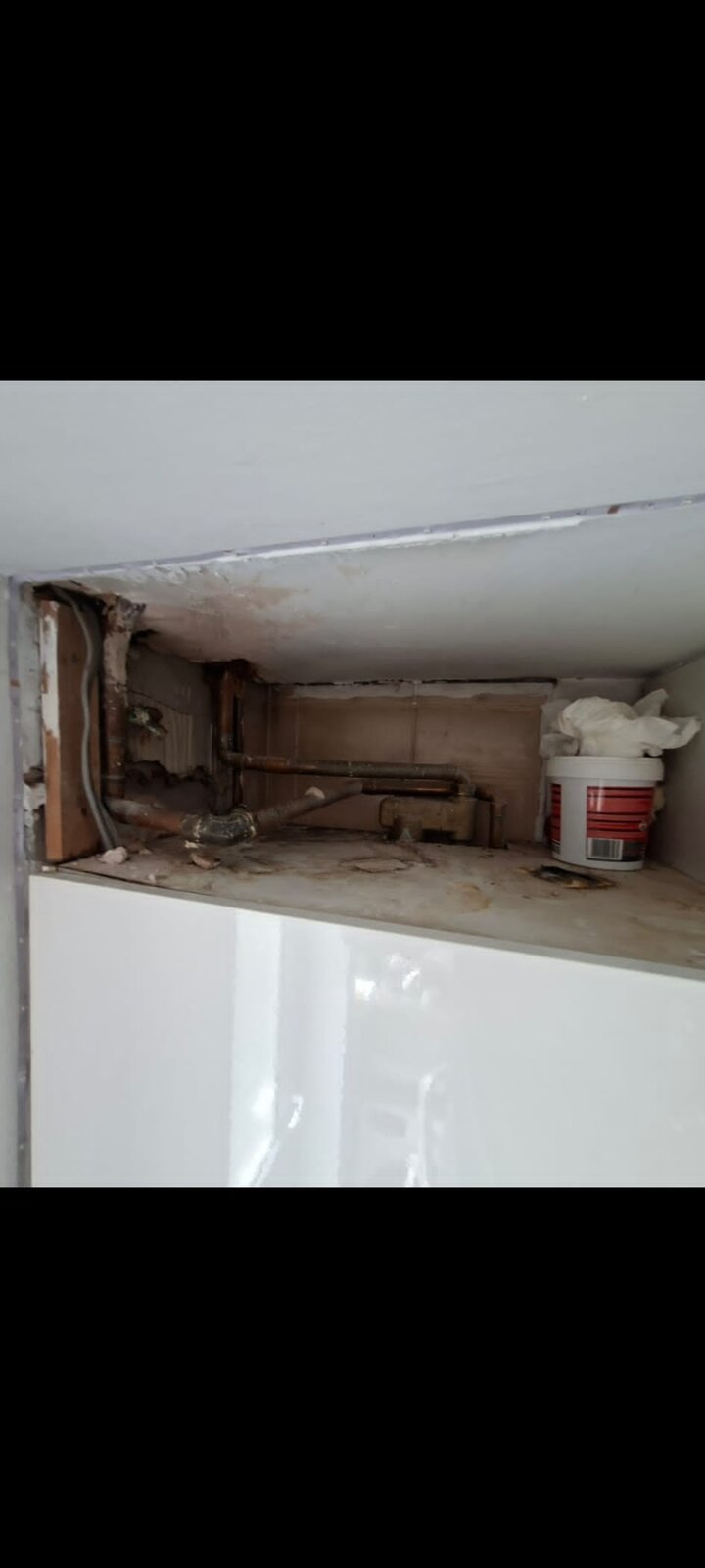

Suspected blocked feed t on heat only system

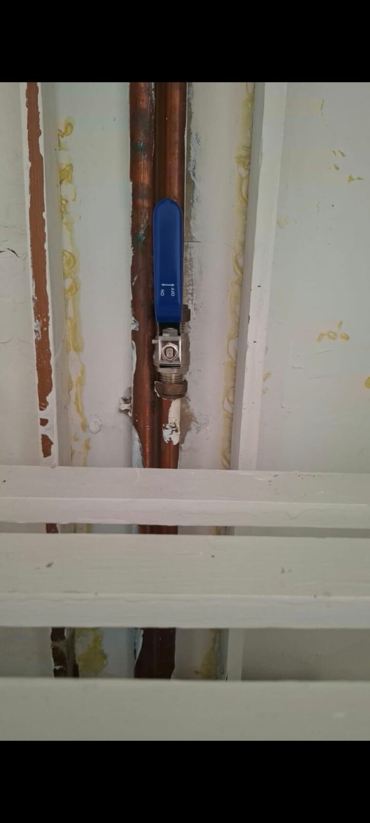

So I went today. Cleaned f n e out. Changed gate valve to a new ball vall. Replaced t and wet vax pipes. Water dropping from f n e no problem.

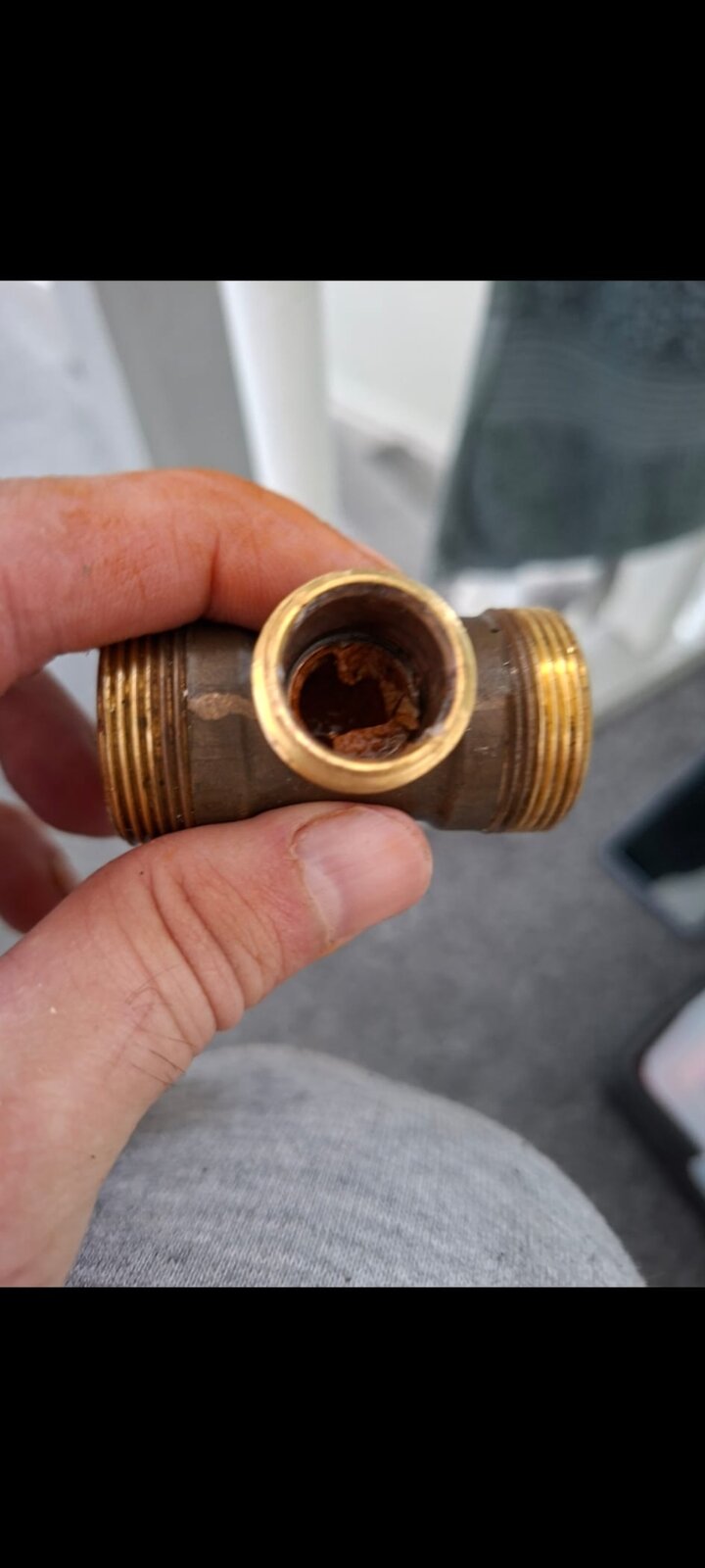

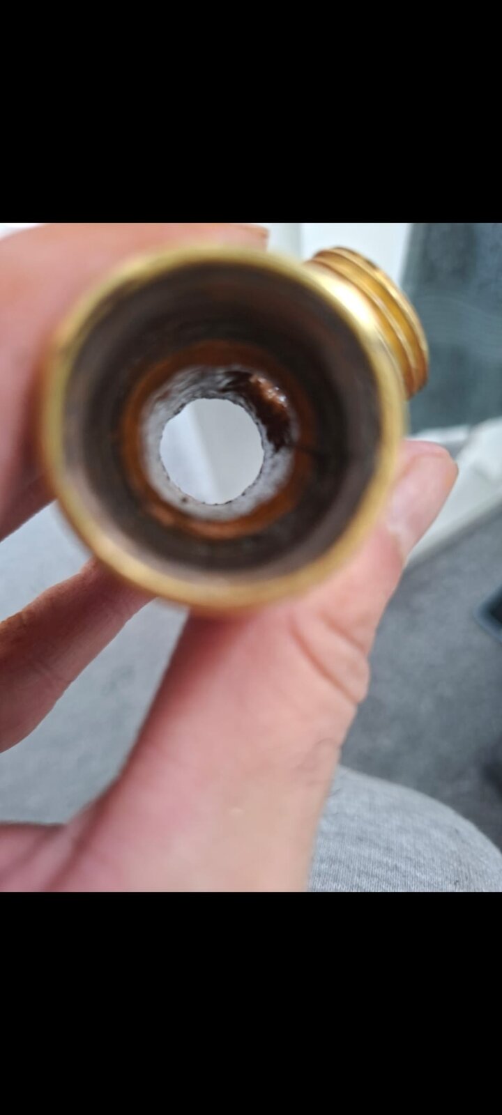

The t was not that much blocked ( picture attached ).
Upon turning hot water/ heating on the feed pipe got hot again but there no block.
What else could it be ?

When engineer fitted 3 port he told me the heat or hot water never worked. He never got in loft to bung tank so likely dropped the f n e pulling in air. He then backfilled the system from the drain off in picture.

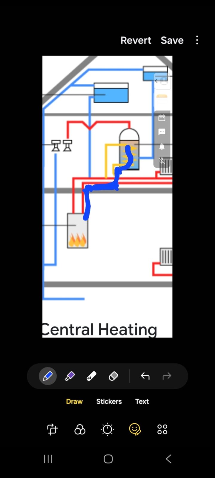

Is the feed from the F&E 22mm ? Is there a seperate vent pipe that comes over the top of the F&E ?

The feed isc15mm from f .n e. Yes thete a separate 22 mm vent pipe over f n e..

Thanks. Getting chemical in tonorrow. I suspect its on the return in blue on diagram.
