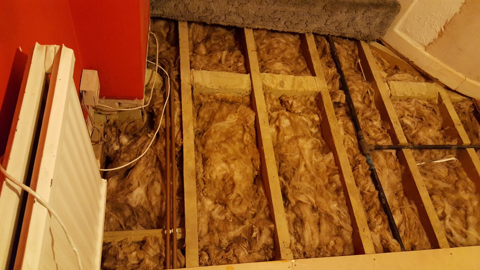

The one in my pic is slightly thinner than the joists, can't remember the dimensions.
It's fine on its own. The names are just words, usually floor joists in lofts are skinny so you stick 100mm between then 200 across

Have look at the packaging to check it is treated with Ecose. The brown, silky stuff in my pic is. I suspect it is all made in the same megafactory.

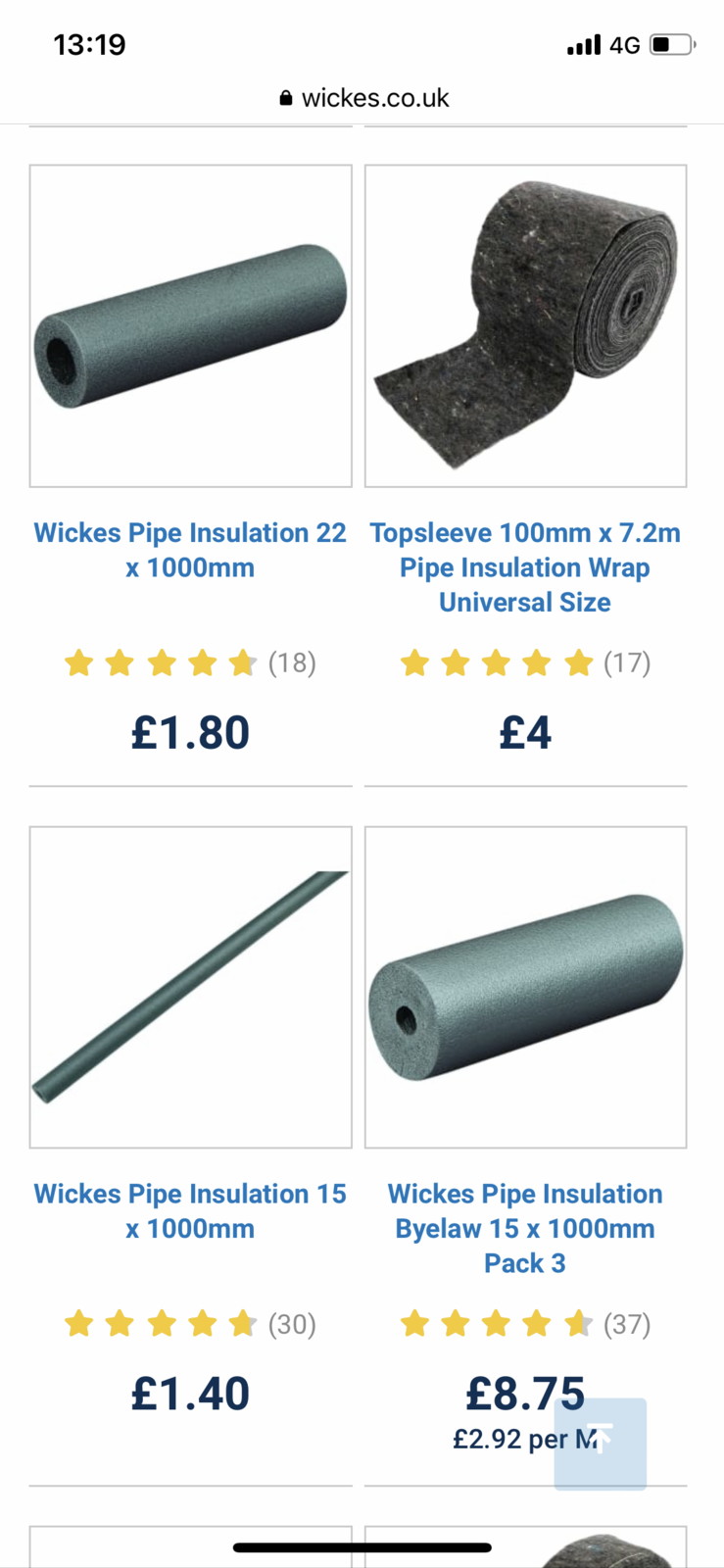

For lagging i forgot to ask. Does it make a huge difference if it’s the wool wrap type or foam tube type?
