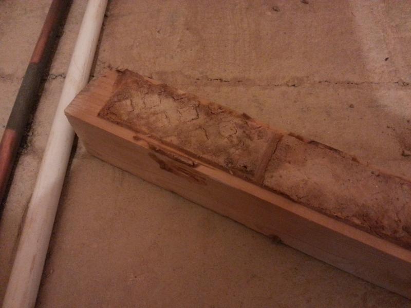

I'm currently in the process of renovating a first floor flat. It's a 1980s build with a suspended floor on a concrete base which forms the ceiling of the flat below.
Upon pulling the floor up, I find the joists that the boards rest on lie directly on the concrete. All of the joists have a spongy kind of membrane stuck to the bottom of the joists.
Is this an older version of a barrier membrane, which is my first thought, or is it something else?
The floor as a whole
The joists are 55 x 60mm and the sponge is around 4mm.
If it is a membrane, will any modern equivalent do or is there a special kind for the joists?
There called Proctor battens and are a propriety acoustic floating floor system. They are available at most builders merchants, Jewsons, Travis Perkins and the like...pinenot :)
How much does the foam reduce by when there's pressure on? The only ones I can find are 15mm bigger than the ones I need :(
The wood alone is 55mm width and 60 mm deep
Proctor is just a brand of acoustic battens, there are many forms available at a range of different sizes.
I wouldnt worry to much about the width, it would be the depth that is crucial.
