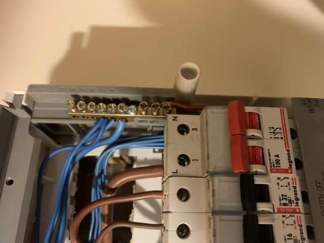

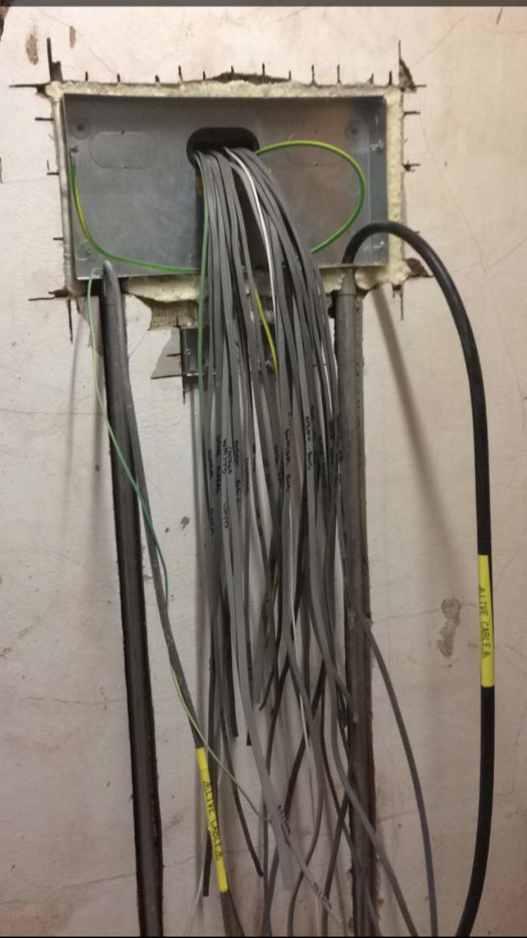

Yep he/she was definite marmite material very knowledgeable but I got the impression armchair warrior and had a great ability to really wind people up in fact me included . Anyway trying to upload pic as still this seems wrong
This board has a 25mm² split con supply on the right. As you can see, it’s much smaller than T&E (although not available in 25mm²)
It is installed in earthed steel conduit so that it does not require RCD protection.
