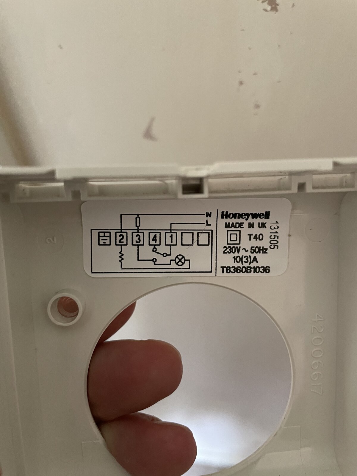

Hi all,
I’ve seen a few threads on here about fitting swapping out an existing timer and thermostat for a Nest, but none of the solutions quite fit my config.
My current setup is a Danfoss 103 timer to a Honeywell thermostat.
One thing I’m really nervous about is 240v going to the 12v connections in the Nest.
Would appreciate some help with wiring!
I’ve attached some pics

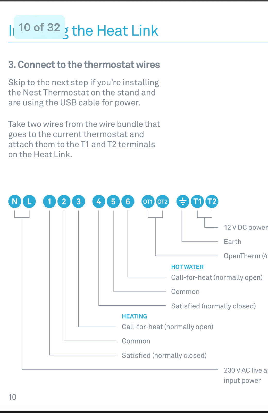

Hi there,
I was just looking at the wiring diagram and T1 & T2 says 12v
Hi there,
They are wiring terminals to power the Nest thermosta, so you dont need to use the USB plg, they wont do anything for the control of your heating system

The Nest Gen 3 heat link needs power to it to work it which needs to be 230 volt, but the three terminals for both heating and domestic hot water are volt free, so does not matter if it switches 230 volt or 24 volt. Then there is the OT (OpenTherm) terminals which are around 5 to 40 volt and can only be used with Opentherm enabled boilers, so it depends on the boiler being used, and last the T1 and T2 carry both DC to power the thermostat and data, if used the thermostat only uses wireless to connect to internet, if not used, then it sends info wireless.

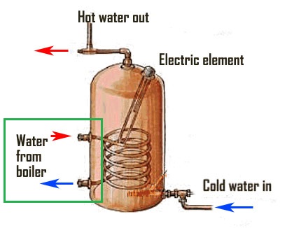

I have a very old oil-fired boiler (albeit I’m told a very reliable one) and only need the Nest to control the heating (water is on Economy 7).
It's unusual that you have a hot water cylinder, but it's not connected to the boiler. Are you sure about that? sometimes the cylinder is connected to the boiler but instead of being pumped, the water circulates naturally around the cylinder when the boiler is on.
The clue will be the number of pipe connections, if it's not connected to the boiler there will only be pipes to 'Cold Water In' and 'Hot Water Out' The connections to the boiler shown in the green box below will be missing.

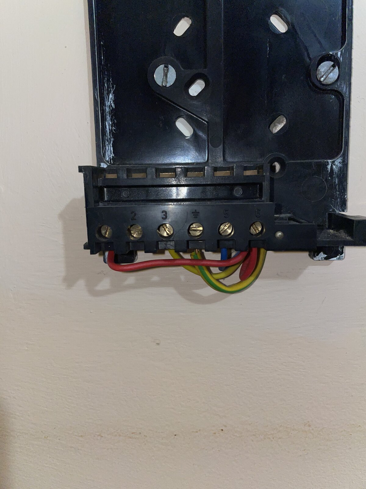

Assuming that the cylinder isn't connected to the boiler and although you don't say, it appears that the Danfoss timeswitch is probably the 103 model. If this is correct, then:
The red wire in DF 6 goes to Nest Heat link L
The blue wire in DF 5 goes to Nest Heat link N
Link Nest Heat link terminals L and 2 together
The yellow wire in DF 3 goes to Nest Heat link 3
Then the old thermostat needs to be decommissioned. This can be done by removing the Honeywell thermostat and linking the red wire in 1 and the yellow wire in 3 together. Isolate the blue neutral and earth wires separately.
The professional way to do this would be to find the origin of the cable going to the room thermostat, note where the wires are connected and then remove the entire cable. Then insert a link to join together the two terminals that the red and yellow wires have just been removed from so that they are electrically connected.
The Nest thermostat can be powered by connecting its terminals T1 & T2 to terminals T1 & T2 at the Heat link, or by using a separate plug in power supply.
