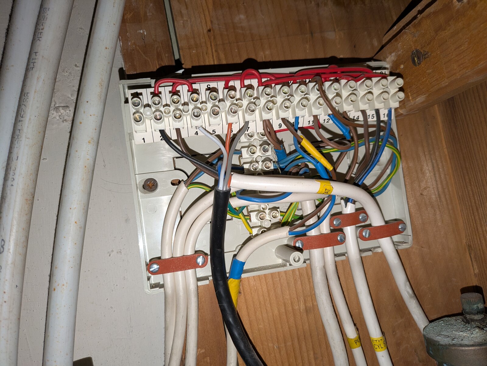

Hi. I current have an oil Potterton Statesman boiler which is wired to a programmer and Netamo Thermostat.
In the cupboard with immersion tank is a twin zone board.
The netamo thermostat is the wire going into 2 and 3 (Room Stat Call and Com). That cable is also connected to neutral and earth in board but terminated at netamo (as thermostat only takes the black/brown wires).
Because thermostat is in room with water tank etc it is always warmer than house and so doesn't really work effectively.
I want to switch to fitting the relay in this room and moving the thermostat remotely.
Can I simply run the netamo relay 4 wire cable down to board connecting black and grey in to 2 and 3, N into N, and L into L (11?).
Netamos instructions are for wiring directly into boiler
Thanks for advice.
