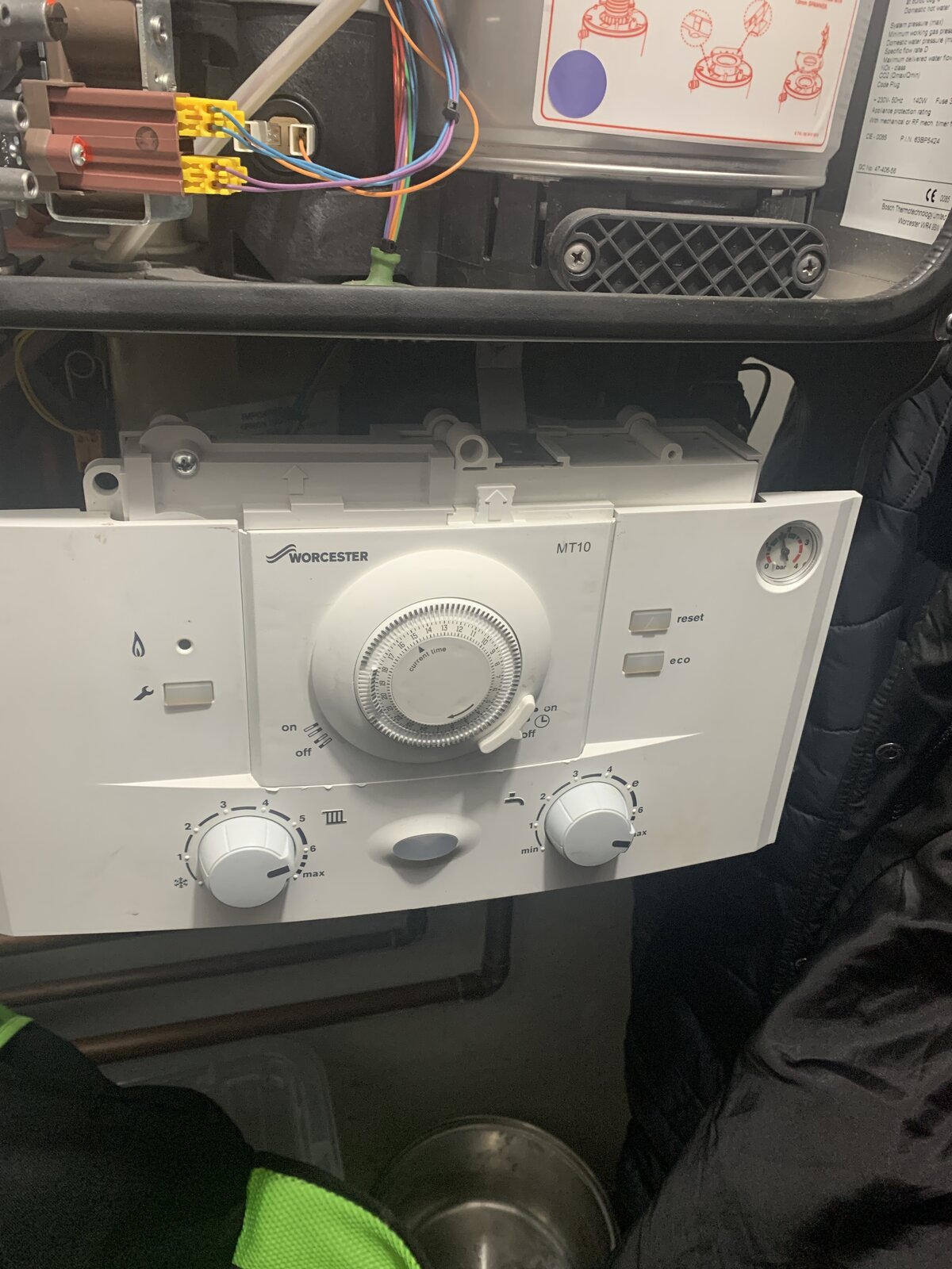

Swapped bathroom radiator, bled radiators and topped up pressure to 1.5 but my Worcester greenstar 28i junior won’t fire up (it was absolutely fine before this).
It’s flashing blue light (mainly off) and reset flashing too.
It sounds like it is making attempts to fire up but after a few attempts times out and asked to be reset again.
I cannot think of any reason why swapping a rad would cause this so any help much appreciated.
Many thanks
No more this

Just an update on this:
I reset again this morning now I have hot water so at least we can finally have a shower
Downside is the central heating still won’t come on
Is it attempting to come on?, if so, immediately after using hot water c/o to CH and see if the pressure gauge on the boiler front is fluctuating or stays steady.
At the top of the heat exchaanger there is a plastic bayonet fitting with a clear hose coming off, turn the bayonet until water comes out of the tube, be carefull the water may be extremely hot
Ah if I knew you I would owe you a drink sir.
It’s sorted now many thanks
