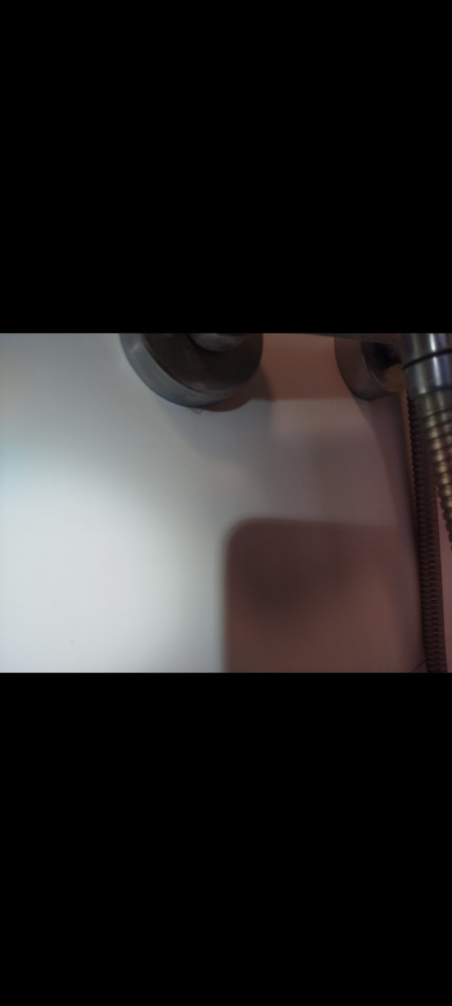

There looks to be a small leak coming from the bar shower fixing kit of this bar shower. I am swapping it, I will have to investigate when I remove the swap and shrouds and maybe put some 3/4 female caps on to test. There is a possibility the bar shower fixing kit may just bite up. But this could be an issue. Anyone had before

Just hoping whoever put the surface bar shower fixing kit hasn't crushed the pipe or put the olive over a scratch
Sometimes those come with fibre washers with the little sieve in the middle of them and the fibre washers just need pinching up slightly. If there olive is not completely sealed you could try sealing it with PTFE and putting the connector back on. Do some elimination and if it is the valve mixer itself then a new one should fix it.
If there's an olive, you can put a couple of turns of PTFE tape over it. It will take up any slight gap.
