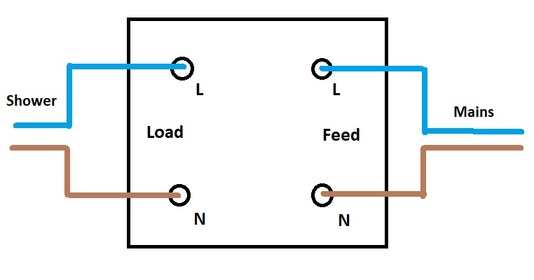

Look at it againYes, but don't really understand why you would think otherwise? That is a standard way both feed lives (line and neutral) in one side and both load lives in other side, why would you think this is wrong?
Does it matter? What I am showing is we all ignore the N markings on equipment.Oh is this 110v?
Oh, do we? I don'tDoes it matter? What I am showing is we all ignore the N markings on equipment.
That would be a very irresponsible thing to do especially if the item contained a fuse.Does it matter? What I am showing is we all ignore the N markings on equipment.
Or a socket outletThat would be a very irresponsible thing to do especially if the item contained a fuse.
Or a single pole switch, the list goes on and would be a complete contravention of 7671Or a socket outlet
Are you sure?If the switch has a neon/led indicator, it would be permanently illuminated whether the switch was on or off.
How can you ignore just the N markings?Does it matter? What I am showing is we all ignore the N markings on equipment.
