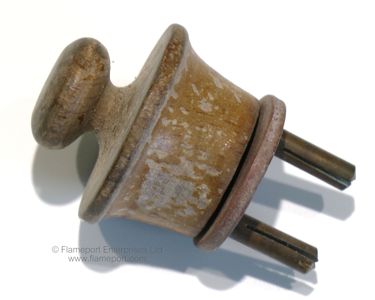

They did look like tops
so can understand the name.
