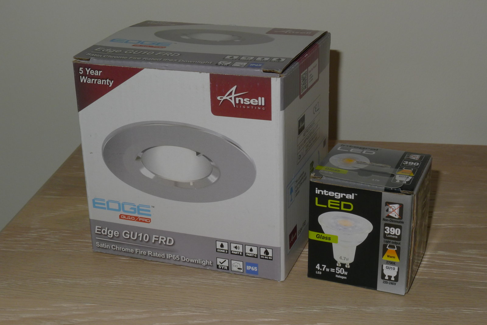

I didn't know that either, but am also in the process of swapping out the old 12v MR16 halogen down lights in my bathroom to 230v GU10 LED's. I'm looking to buy 3 in IP65 & brushed metal as 2 will be above the bath. If anyone can recommend some before I pop to Walsall's?
If you are replacing/fitting downlights in a bathroom you must make sure they comply with Part C of Building regs. This deals with the passage of moisture. Yoiu do not want all that warm steamy air being sucked into the loft where it will sit and rot your roof timbers.
Also, if you have roof insulation above (you really should have) then you'll need either to choose downlights that can be covered in insulation, or get some loft caps that allow the downlights some breathing room while allowing you to pile itchy and scratchy on top.

I've seen the covers at B&Q to space out the loft insulation, but I'm hoping to find down lights suitable for for the installation even if it means going fire rated.

In the end I walked away with 3 Ansell IP65 fire rated down lights and some GU10 LED's for around £34.
Just need to buy a bigger hole saw now.
