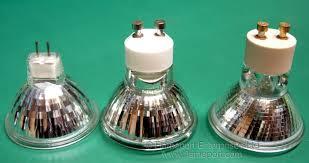

Hi,
I have been advised to change the spotlights in my lounge from MR16 to GU10's as there is a greater variety of dimmable LED's on the market for GU10's.
I have seen some conflicting information online with regards to the replacement of these fittings.
Some sites say that you can cut off the current MR16 transformer and wire the GU10 socket straight into the mains, others state that you should still use a transformer with GU10's.
Could someone please help clarify this?
You are, not surprisingly, mixing up the names.
MR - multifaceted reflector - refers to the glass type and GU to the fixings.
The 16 is diameter of the lamp in eighths of an inch.
L to R
MR16 with GU 10mm. base. 240V
MR16 with GU 5.3mm. base 12V
MR11 with GU 4mm. base 12V
The straight pins are 12V.
Thanks for that.
So it would appear that i am swapping out the 5.3mm base 12V for the 10mm 240V.
By that rational is it correct that no transformer would be needed?
One website i visited suggests that inside the GU10 is a mini-transformer but it is not suitable for the job (which seems a little odd!)
Don't believe everything you believe on the web. There is no room for a transformer inside a GU10 that would do the job. Some LEDs have capacitive droppers, some may have an electronic regulator of some sort. Either way no external transformer is needed as they run on 240 volt. Whether they will work on dimmers is another matter entirely.
