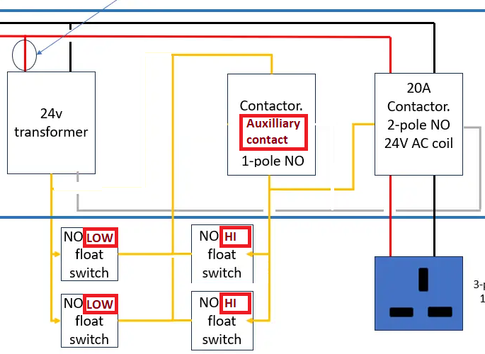

This is a little different - I want to build a small control circuit to turn on flood pumps when a high level float switch is tripped, and leave the pump on until the low level switch is broken. I figure this can be done with a couple of contactors inside an enclosure and feeding a regular (outdoor) 13A socket.
My first stab at a concept is below.
Things to note:
- I know pumps come with float switches pre-wired, but the pit depth means long tethers to avoid short cycling the pump and the possibility of snagging the float is too high. Hence this need to build 'fixed' switches to turn on the pump.
- I know I could wire the pump directly into the 20A contactor, but it is important to be able to swap pumps easily.
- The installation will be under an open barn roof, so weather protected. The existing ring main looks to be DIY wired. I haven't been able to check yet, (not my barn) but I am assuming it does come off a 30 year old CU in the workshop that is RCD protected.
Questions I know I would like some advice on. There are probably others things I don't yet know I need advice on, so please chip in if this looks plain stupid:
1) Is this 'allowed' to introduce some home brew switching circuit upstream of a 13A socket?
2) I feel better using 24V on the float switches, although they are rated to 240v, and using 240v would remove the need for transformer and first contactor (changing the second one to 240v coil). Is this practical to step down for switching?
3) Should I fuse the transformer?
4) Would an RCBO inside the enclosure be good practice? Can't be easily reset though, so probably not, even before I get into the difficulty of sizing it.
5) What am I missing?
Yes.
Yes.
Yes.
Look up 'no float' pump control relays. Basically, three metal tubes or rods. One earth, 2nd starts the pump when water touches it, 3rd one stops the pump once the water clears it. There are no floating parts, no flexes to become tangled. Such a relay system can be set up, with a latching and none-latching relay.

Re RCBO inside the enclosure.
I assume that the circuit that the double socket is on is protected by an RCB/RCBO in the house consumer unit? (there should be).
That will provide earth leakage protection. the switched fused spur provides over current protection.
As an RCBO's job is top provide over current and RCD protection then it is pointless. Those functions are already taken care of.

Thanks. I'll take a look at the no-float. Only thing I see straight away is a £1 AliExpress module. Concerned on the corrosion of bare metal ends in contact with water for months at a time. .
I would prefer to use robust industrial level switches, but they are expensive, and mostly through-wall. In consumer packages the float switches look to have the best long term reliability.
I do like the idea of a 'column float' because it can be removed for level adjustment. Concern is the robustness of the movement, that it remains free and doesn't snag. I'm only going to be able to inspect the installation twice a year, and I can't rely on the owner being competent to run a good maintenance schedule.

Why am I considering using a FCU? This whole assembly could be with a 3-pin plug, straight into the conveniently located ring main socket. It's then just a switched extension lead. Advantage - no need to open up the ring main for adding the spur (I'm happy doing this, but it's extra work). I can test the new assembly away from location, and easier to remove to modify if needed.

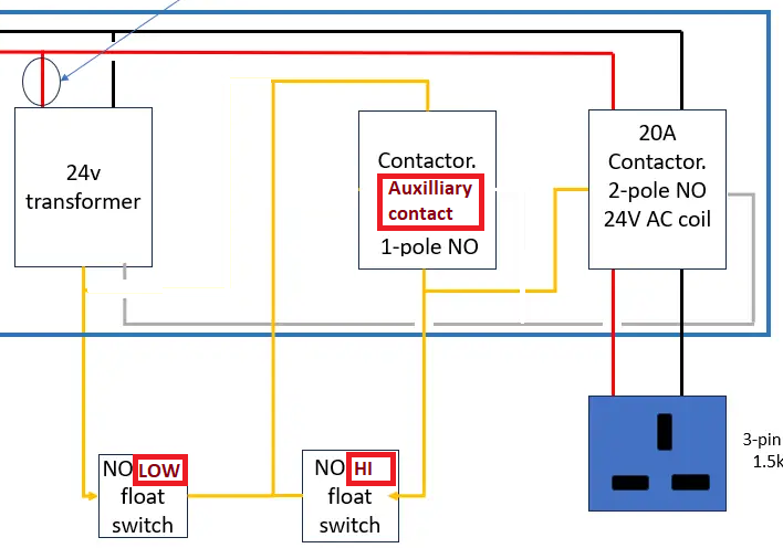

Only one contactor required:
google for "auxiliary contact" and images.

I have worked with both methods and To be fair I've found both have their problems. The most reliable are the ultrasonic level detectors but very pricey: https://uk.rs-online.com/web/c/auto...YyEQD2yI6R82urGxHHgaAo8aEALw_wcB&gclsrc=aw.ds
It's not uncommon to add an additional float switches to add to reliability:
However this will not account for stuck in 'ON' position.
Thanks everyone - I'm going to look more at the liquid level relays. I had not come across these before. My first thought is they might be harder to troubleshoot for the inexperienced, and cheaper versions are probably not so robust as cheaper float switches.
The thing that attracted me to float switches is that this is what the £500 pump comes equipped with, and not had any issues with it yet - but had near misses with tangling to maximise pumping volume. Two separate floats on a vertical pole solves that as each has a short flex to its pivot point. Of course the pump switch then needs to be secured in its pumping position (or removed)

The 3 probe type are eay to fault find. Short long probe to short, pump should start. Short long probe to middle the pump should stop.
Doesn't get much easier.
Don't flood the sensor head though as water in the top shorts all 3 probes and the systrm goes nuts.
