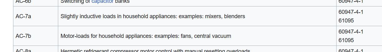

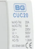

On the contactor rating - can you shed any light on this rating below? This was my initial pick (cheap, available in Screwfix) before checking the spec. You see for AC-7b it is rated for 9A, but only 1.2kW. So I conclude this is not suitable for a 1.5 kW pump. Are AC3 specified contactors so different that when plated at 6A they are good for 1.5 kW of inductive load?
The comparison between different ratings is not straightforward and seems to vary between different manufacturers. Not only that some manufacturers rating plate shows only current for AC1 but KW/HP for AC3 and then may only show for 400V/3 phase.
It's not always easy to identify what category a motor should be put into unless it's shown on the rating plate, for example a similar motor may be fitted in two different devices, although not a good example (for several reasons); think about the varying load on an electric drill compared to a sewing machine.
Working in controls for a few years soon got me into the swing of using AC3 figures for motors which meant frequently fitting a larger contactor than actually required.
Without knowing which category your pump fits in it's hard to say if AC7a or b
I'll be honest, I've only ever used a domestic contactor once and that was to override a 500W floodlights PIR so the question of rating of these have not arisen with me before.
A 1.5KW pump will be approximately 6.6A, once you have been able to establish the category your pump fits into the resolution will be quick. If it were me I'd be using a different contactor because that's what I use on a daily basis, I'm sorry I don't have the experience with things like the BG you show, I'm not in any way criticising as I don't know them.

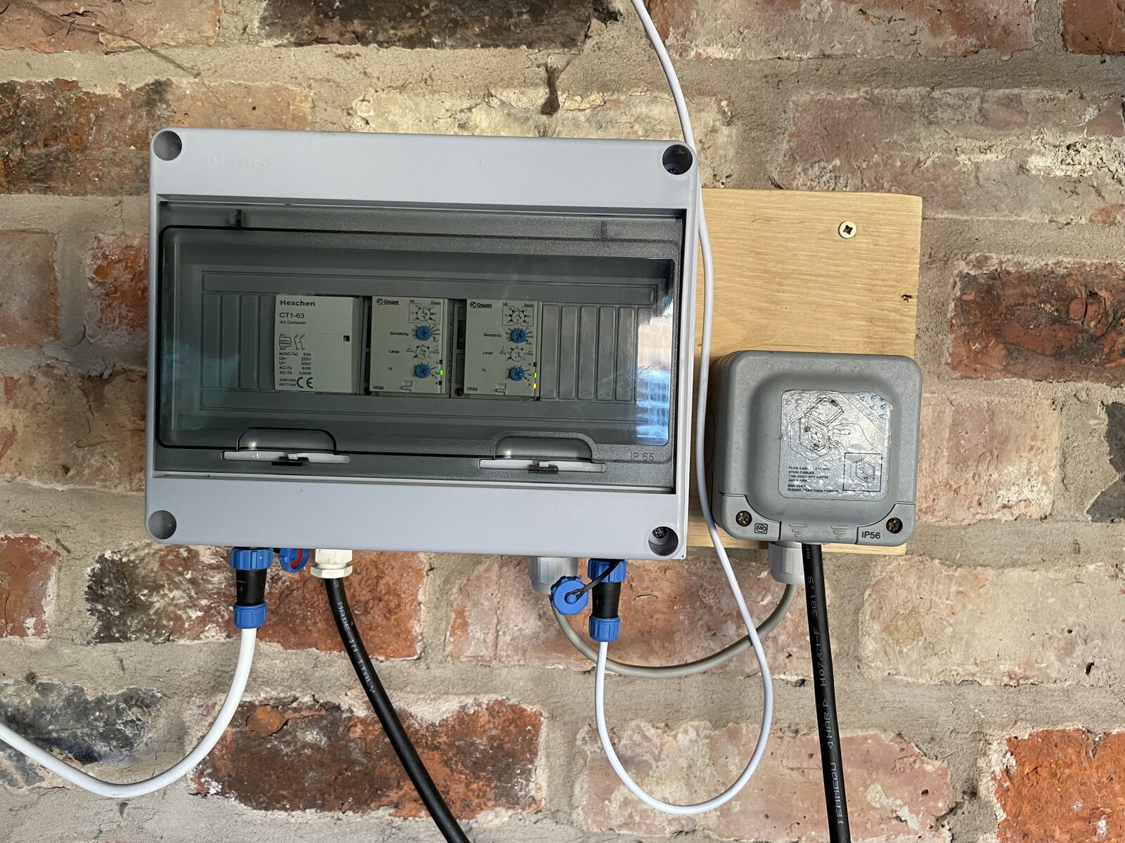

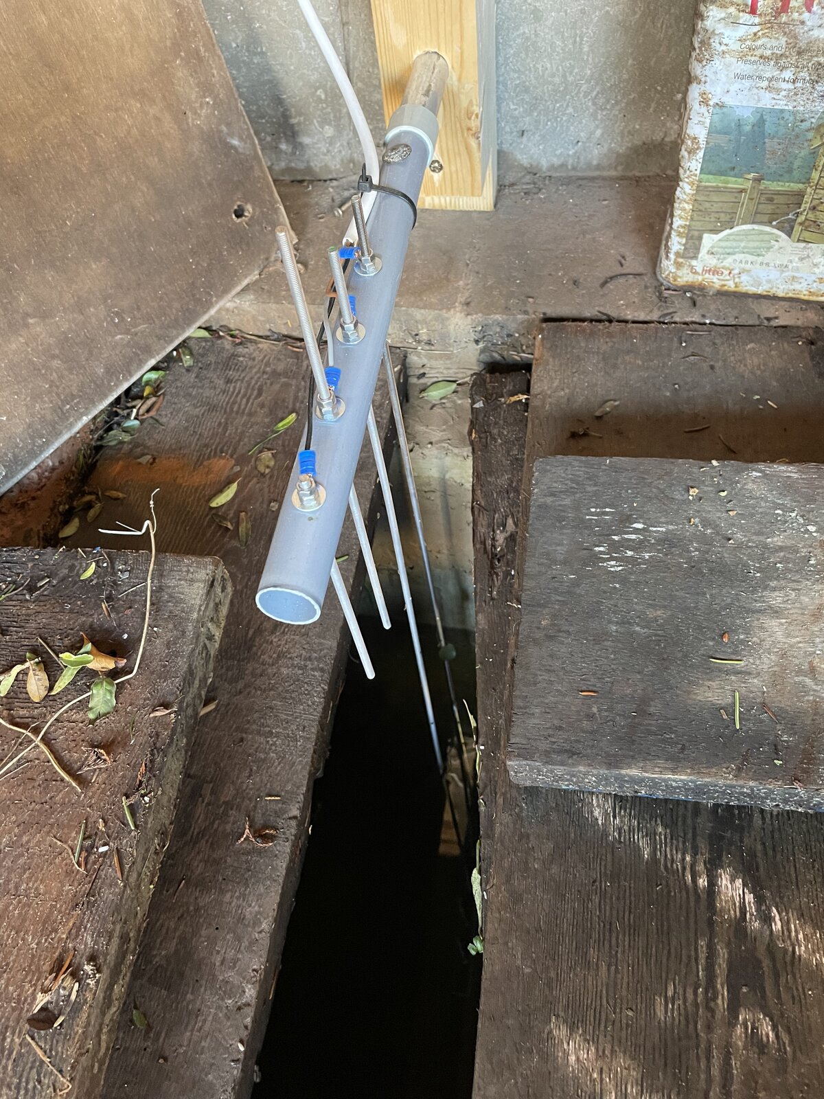

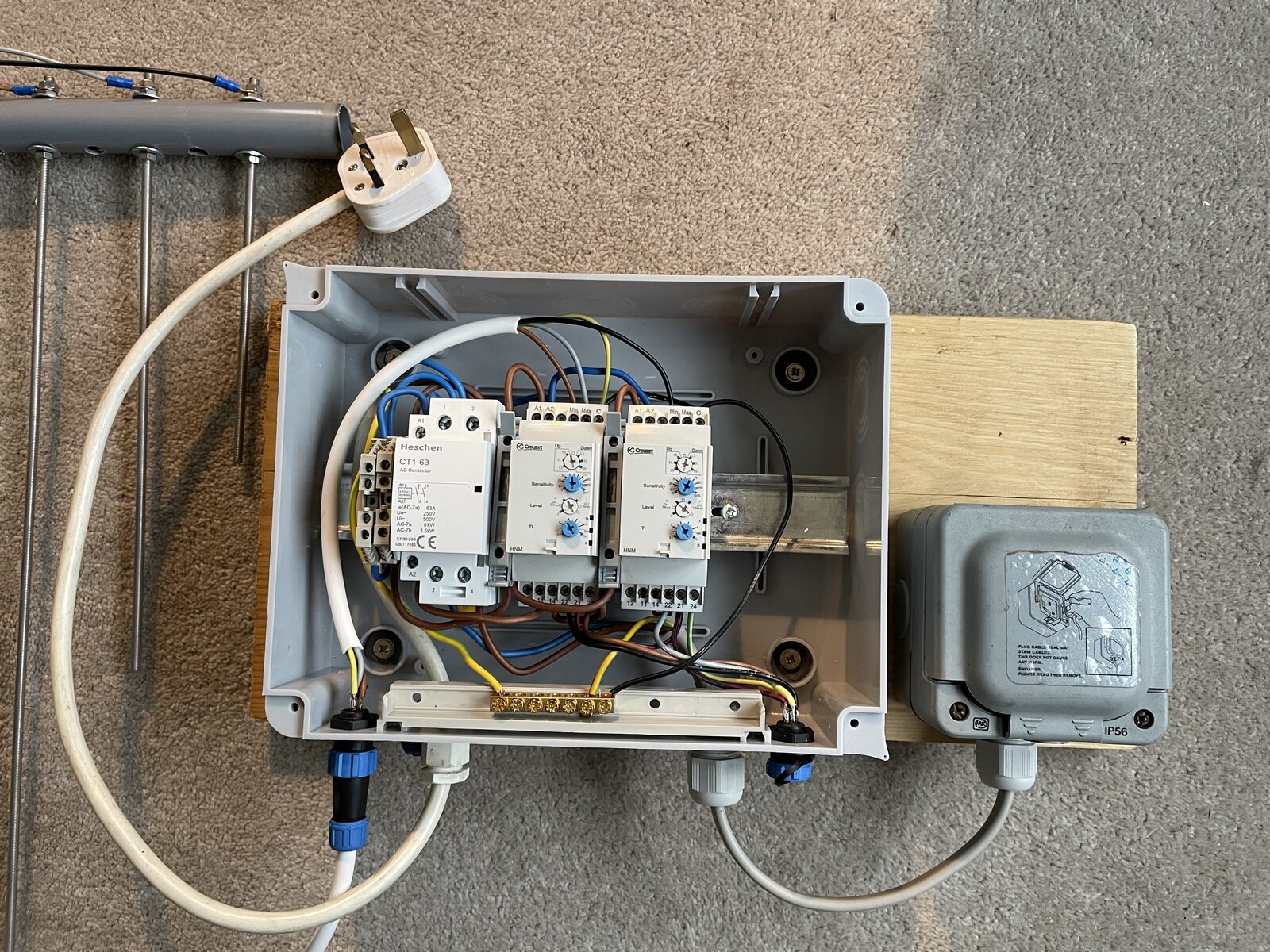

UPDATE

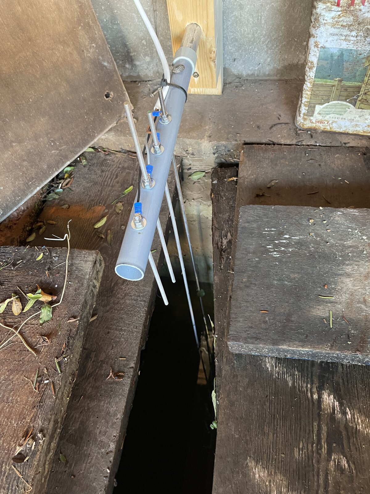

The thing is built and has been working this week in flood control. All perfect.
Second relay provides an alarm contact for high-high electrode or for power loss. Alarm in house has battery back. Hard wired to look at both relays.
In time I hope to add some monitoring logic to record frequency and duration of pumping cycles, maybe even power draw of pump using a clamp transformer to monitor for blocked intake.
Many thanks to those that pointed me in the right direction.

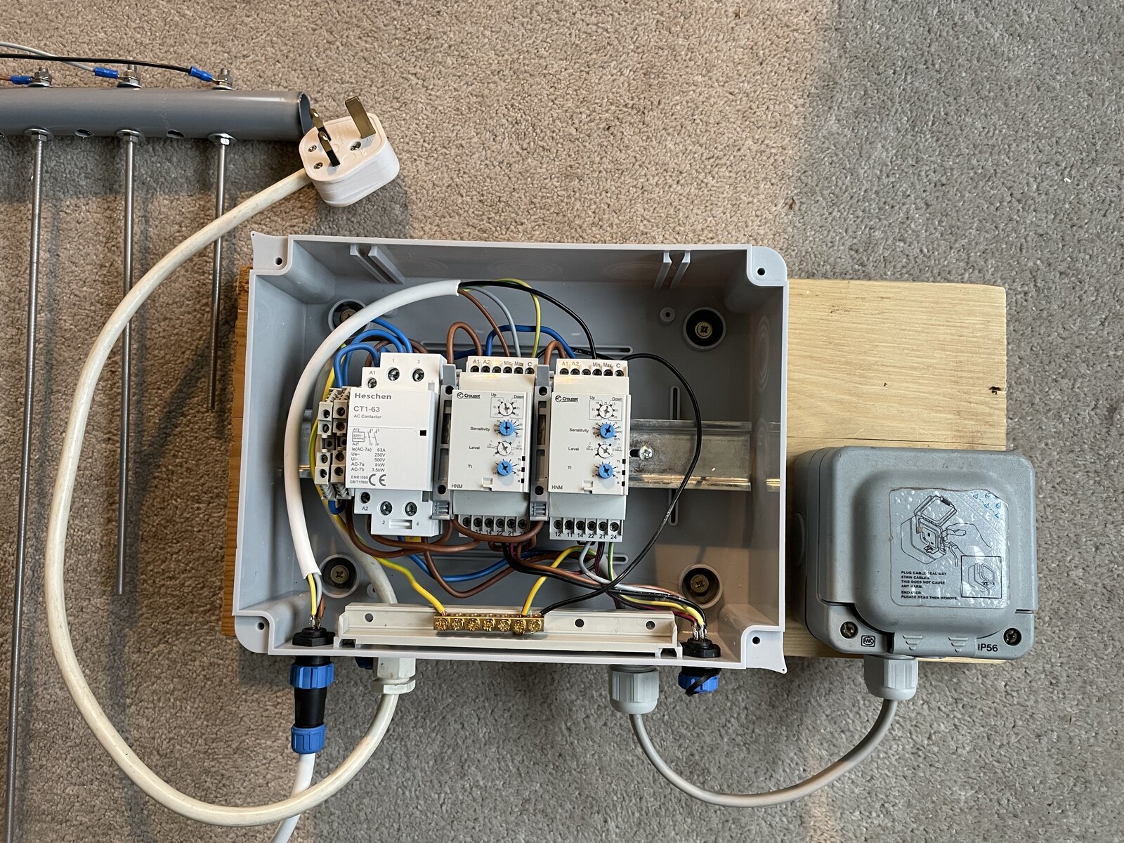

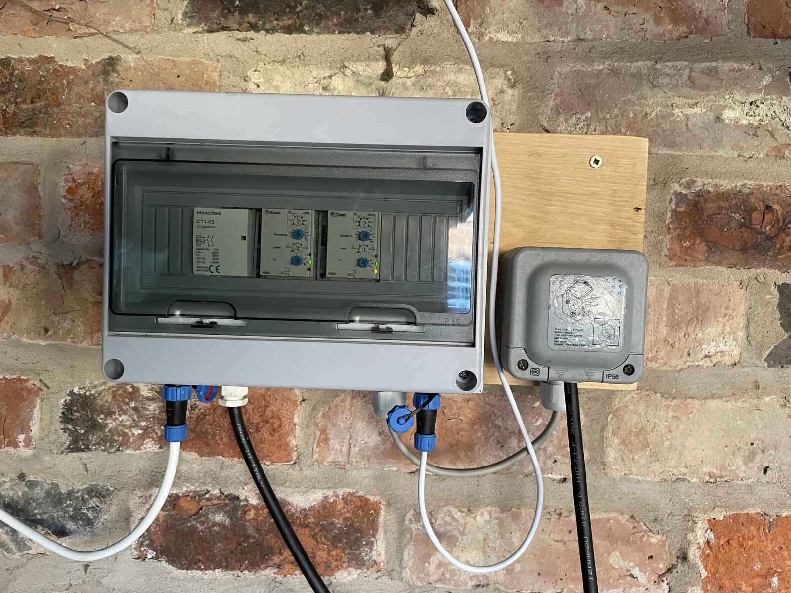

UPDATE
Well done, glad it worked-out for you. I love the level sensors arrangement. Looks like the rear element is stainless steel, did you use that for all?
All stainless. M5 threaded bar in 1m length from ToolStation. I thought I might replace with thicker stainless rod, but it seems robust enough. Now the heights are set I should trim off the excess to neaten it up
