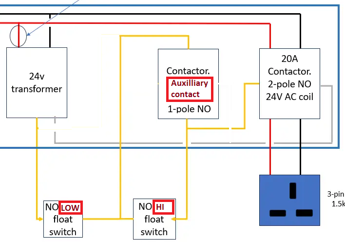

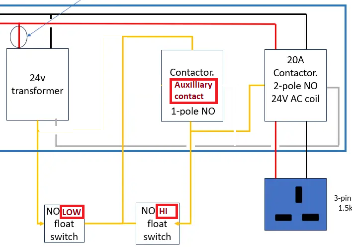

Only one contactor required:
google for "auxiliary contact" and images.
Is this a mad idea - I'm sure it's bad practice, but any reason it would not work? If I happened to have a 3-pole contactor available, 2 poles to switch the pump, and the third pole to use as the Aux for the coil voltage? Or on a 2-pole, only switch the pump live and use the second pole for Aux?
I know it is not hard to get a contactor with Aux contacts, I'm just thinking though minimizing the component count.
And overcomplicating it. Why reinvent the wheel.

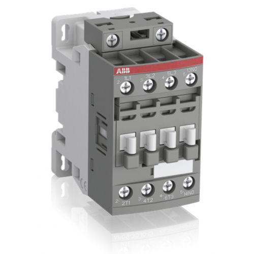

Most contactors are 3 or 4 pole so yes it's ok and some incorporate an aux contact too, example:
It's the sort of thing I may possibly have in the bottom of a box of redudndant stuff.

Thank you everyone for your help and suggestions. I have now acquired a Crouzet HNM liquid level relay and planning the other parts to wire it up as a panel.
I learnt some things about contactors today, I always assumed they were relatively simple things and had never had need to look at utilisation ratings. I thought a 16A 2pole would be more than adequate, given the pump is on a regular 13A 3-pin plug. But these 'household 20A' contactors are only rated to 6 or 7A for inductive loads. I think I should play it safe with a 40A contactor, rated to 15A for AC-7b household inductive loads. I'm also considering an industrial 3-phase 16A AC3 contactor, surely AC3 rating (squirrel cage motors with breaking during normal running of the motor) is as good as AC-7b (motor-loads for house hold appliances) and I can just use 2 of the 3 poles. Still hunting for a bargain.
One more decision - the Crouzet works on 24V - 240v. I guess my instinct is to use 24v, given there are probes dangling in the water. But the power pack is another component that might fail so I will most likely stick with 240v, assuming I get a matching contactor. On the other hand if I stumble on a decent contactor with 24V AC coil I may revert to the power supply option.

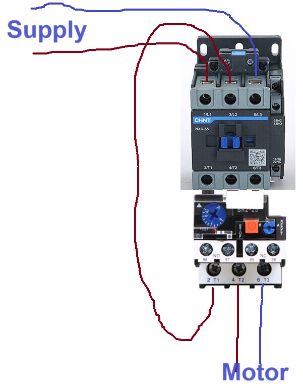

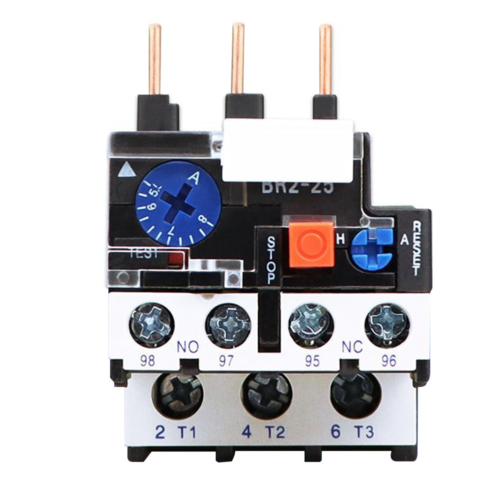

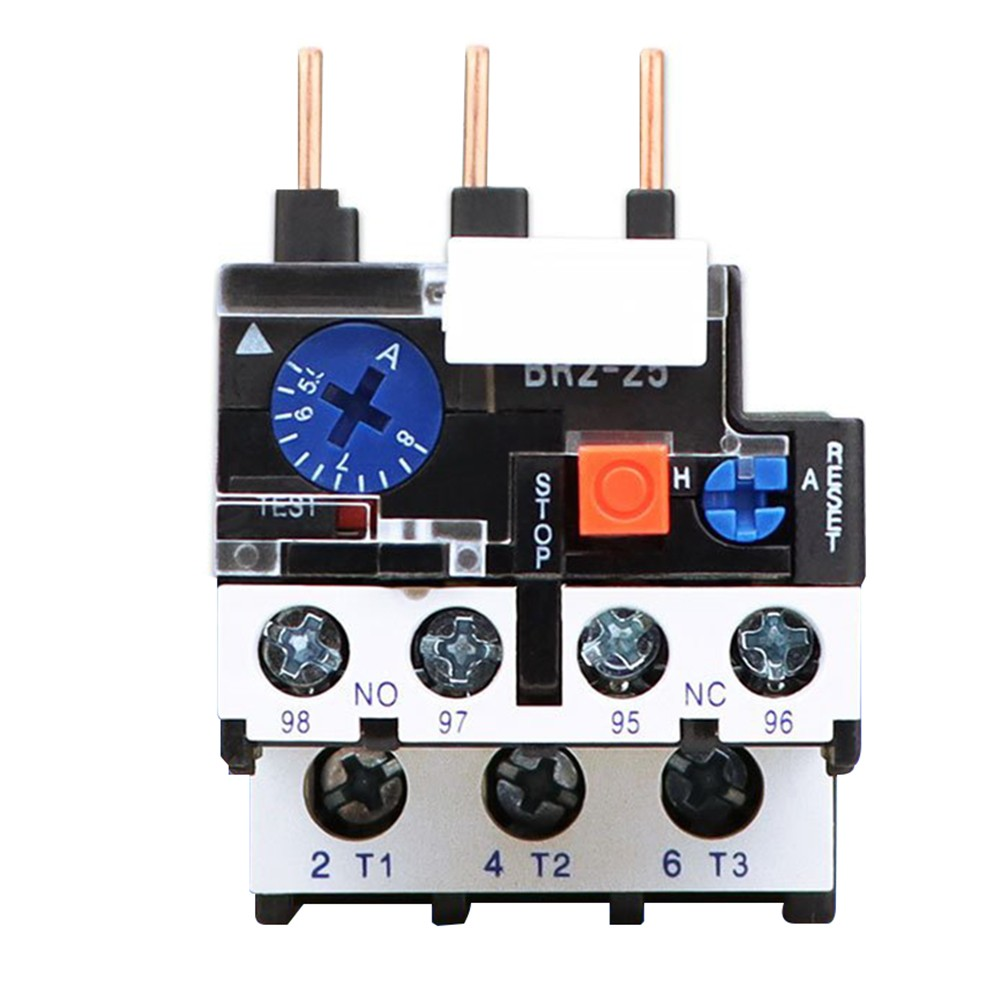

Any contactor with an AC3 rating of 6A will be fine. If this is commercial any motor over 370W should be correctly protected with an appropriate overload

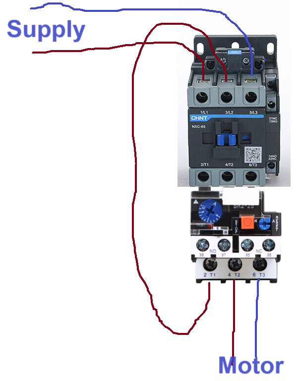

Which fits directly on the side of the contactor (excuse the mixing of makes which should not be done in actual use.
and all 3 passes through the overload must be used in order for the thermal element of the device to respond correctly.

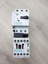

Another variation goes before the contactor and acts as an MCB but still requires 3 passes of the load current.
Personally I'd fit either one regardless of whether it is commercial use as the pump is left unattended for automatic starting.

Any contactor with an AC3 rating of 6A will be fine. If this is commercial any motor over 370W should be correctly protected with an appropriate overloadView attachment 321998
Which fits directly on the side of the contactor (excuse the mixing of makes which should not be done in actual use.View attachment 322002 and all 3 passes through the overload must be used in order for the thermal element of the device to respond correctly.

Is it a 1.5kW pump, usually left for remote starting on just a float switch. The whole purpose of this exercise is to provide easier setting of hi and low levels, and to avoid potential for the float switch to get snagged. I intend this control box to simply power a socket on/off. It should result in fewer starts per hour than the float switch as we can then utilise the full depth of the sump.
My thinking here is that so long as the contactor itself is not the weak link then the overcurrent protection continues to be just as provided by the 13A fuse that will still be present on the pump plug (maybe10A, haven't checked). I need to leave the pump workable on any socket in case it needs moving location, so hard wiring is not an option.
If I did opt for additional protection in the panel then would a regular single pole MCB on the live just prior to the contactor do the job? I guess these are not as adjustable, but given it is a domestic pump without FLC data on the nameplate its going to be a bit of a guess what to set the overload to anyway, although I could measure actual current in operation.
On the contactor rating - can you shed any light on this rating below? This was my initial pick (cheap, available in Screwfix) before checking the spec. You see for AC-7b it is rated for 9A, but only 1.2kW. So I conclude this is not suitable for a 1.5 kW pump. Are AC3 specified contactors so different that when plated at 6A they are good for 1.5 kW of inductive load?
