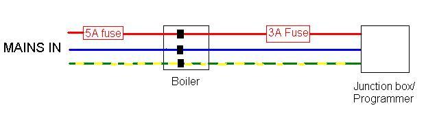

I seem to have discovered another "concern" as regards this change. The existing Switchmaster timer is supplied from a switched fused spur fitted with a 5 amp fuse. ( The boiler is a Firebird 90 s and the installation instructions state this is to be supplied via the 5 amp fuse so-- correct??) The LP 552 instructions state that it is to be protected via a 3 amp fuse and I can't see how I can protect the unit and run the boiler if I change the spur fuse to 3amp. Do I have to take the chance and supply the new programmer via the 5 amp fuse?
Presumably you have a wiring centre (junction box), with the motorized valve, thermostats etc connected, fed from the L and N terminals of the Switchmaster.
Most gas CH systems only need a 3A fuse to protect the boiler, programmer, motorized valve and circulation pump. Presumably the Firebird needs a 5A because it has an oil pump as well.
The ideal way would be to supply the mains direct to the boiler from the fused spur with a 5A fuse and have a take off from the boiler's mains terminals to the wiring centre protected by an in-line 3A fuse.
Click to enlarge, then right click to save
Alternatively, contact Drayton and ask their advice.

Contacted Invensys-- 5amp Fused spur ok.

Invensys Technical guy said quote-- As long as it is a MINIMUM of 3 Amps. I didn't discuss this with him as I was happy to receive his answer. You would think the literature would have said " a minimum of 3 Amps" and it would have saved me a lot of bother and involving yourself.
The Tech guy is not very technical then. :rolleyes:
If you took his advice you could put in a 13A fuse, which wouldn't protect anything. The wiring would probably catch fire before the fuse blew.

I have tried to calculate all of the load supplied via the fused spur and my total is 485watts. If I am correct the system could run on a 3 amp fuse but I am going to continue with the 5 amp at present. When I have time I will try running the system on a 3 amp fuse for a prolonged period.
