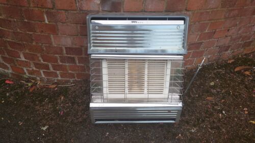

I'm doing a bit of research here, on heating just my living room with my radiant gas fire, rather than the whole place up...
I had to look up radiant gas fire. We had this when I was growing up, I think Mum called it a "gas miser". I wonder how efficient they were back then? Gave out lots of heat. I only have a open flame fire from 30 years ago, which could well only be 40% efficient.
I still keep one tucked away, with a full tank of gas - just in case ;) I would guess they were 100% efficient, none of the heat can be lost.
The open flame fires were terrible.
