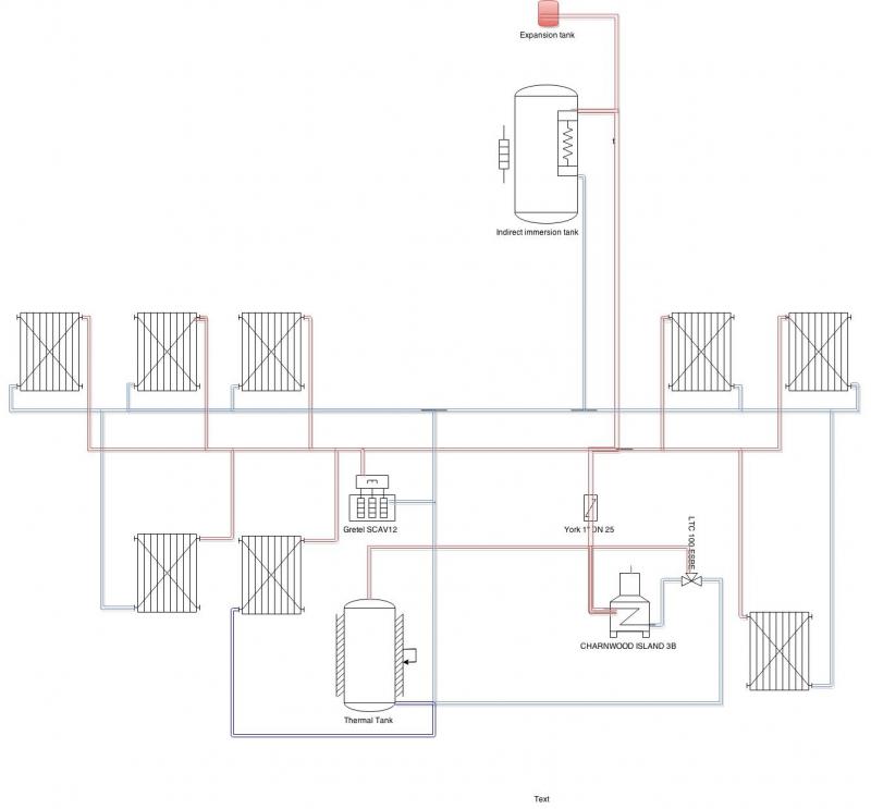

Hello
Jumping in.
I have been getting very large over winter EDF bills and only notice after I checked my bank account 5 months too late, 100 Euros a week, it would seem that the plumbing/heating company (French) that supplied and fitting my duel fuel central heating system has fitted no zoning valves, wired up another pump to run permanently 24/7 causing the immersion tank to boil and supply the rads 24/7.
without the other pump running the down stairs rads stay cold BTW.
Well not being a plumber I think that is what the main problem is.
Could someone please identify what is needed and where to put it to make it all work, I notice also that the thermal tank that is fitted may have been plumbed wrong too.
I have asked this company to work with me in identifying what is causing these massive EDF bills but finally got and answer from them only after I had to ask my local Mayor for help, the plumbing company just said it was normal over winter EDF bills for everyone, full stop.
I have only put a picture of the system, there is an overheat release valve not shown.
There is a LTC 100 ESBE next to the stove and a York 1" DN 25 on the line going up from the stove, apart from these there are no other restrictions and the system is all joined up like i have shown.
Tony
You don't need a big accumulator tank for a wood stove.
Best to send the heat direct to the rads with HWC priority.
Is the stove ever fired up? How much solid fuel have you burned over the last 5 months?
Drawing looks wrong. Then again it might be right and the plumbing wrong.

@ Norcon, yes I have turned off the accumulator tank, complete waste of money, his insistence again.
We have I recon used about 2/3 of a tonne of coal/anthracite ovals (shipped over from England) mix with about 6 steer of wood, the stove is a fantastic piece of kit BTW, Without it we would have been in real trouble, the immersion tank got a good supply of the heat along with the up stairs rads while it was lit.
To you both, the drawing is very neat unlike the real pipes but totally accurate in it's configurations.
Looks a right mess. Don't know where you would start other than rip it all out and start again.
His idea of "control" seems to be wire everything up 24/7. Nice.
I dont see the pump(s).
Nor do I really understand what this electricity consumption is relating to as we are told all the heat is from solid fuel. Actual consumption is kWh would be more helpful.

To me that system is completely wrong, the boiler should be feeding the accumulator, its solid fuel so should be gravity fed I'd say. Then from the accumulator to the h/w cylinder and the rads. These would be pumped, and controlled by zone vales.
Solid fuel cant be controlled very well so the heat from it would vary, feeding into the accumulator means a more steady temp can be taken form there.
Is the cylinder being heat by the charnwood or is it being heat by the immersion heater 24/7. What else do you have in the house?? As in electric guzzling appliances??
Loading valves are usually controlled by flue stats. So when the fire dies down the pump shuts off quickly and doesn't cycle the entire contents of the accumulator back through the appliance. They also have a gravity feature for fail safe operation.
I dare say its not fitted.
Not that it matters as the plumbing looks wrong.

srhawksy I made quite sure that the system was gravity fed and a feed and expansion tank was fitted by him begrudgingly at the time, in the top of a cupboard above the immersion.

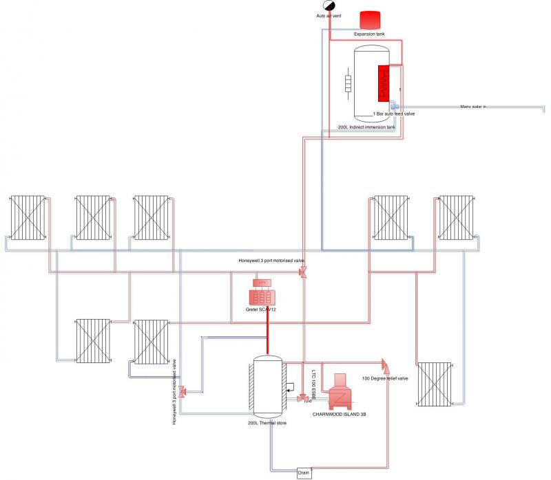

As I was trying to find out what was causing the EDF bills I investigated everywhere As best as I could and discovered he had taken out the feed and expansion tank and replaced it with a large expansion vessel, he had made my system into a sealed system without even telling me, upon further inspection I see he had fitted a 100 degree pressure release valve.
At first the Thermal tank was being fed by the stove but as I struggled to get my head around what was going on I shut it down.
As the system was fitted with this 100 degree pressure release valve, I wasn't worried that it was going to blow up.
We have the normal stuff run by electricity, like fridge/freezer kettle, washing machine etc, no electric heaters BTW.
Norcon your right of cause about Loading valves, ours isn't, so another issue there.
The gravity feature for fail safe operation you talk about is still there, as the thermo syphoning feature can still take place, I hope.
Well any pointers as to where the zoning valves should be put and how the thermal store plumbed, given how this system is plumbed at the moment, I am going to ask him to correct it to your advise, otherwise it's court I feel, he is a big electric/plumbing company and I'm only little, I hope it don't go there.
:eek: :eek: Bloody hell I'd be getting him back, solid fuel sealed is a big no!
If it were me, Id have flow and return from stove to store, open vent from store to F&E tank. Then a flow out of the thermal store with a pump, after pump 2/3 zone valves 1/2 for rads (2if you want to zone upstairs-downstairs) and one to cylinder. Then obviously the returns coming back into the store.

srhawksy "If it were me, Id have flow and return from stove to store, open vent from store to F&E tank. Then a flow out of the thermal store with a pump, after pump 2/3 zone valves 1/2 for rads (2if you want to zone upstairs-downstairs) and one to cylinder. Then obviously the returns coming back into the store."
