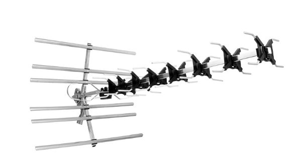

Beware double or even quadruple counting of elements. Marketeers like big numbers. Shoppers aren't experts, and so in the absence of any solid knowledge they fall back on numbers, because 'more is better, right?' This is how we end up with this being called a 48 element when it's nothing of the sort.
You can read more here: https://www.aerialsandtv.com/knowle...Now we come to the,was counted as one element.

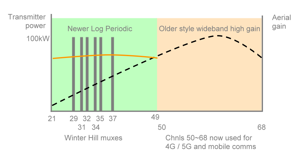

We'll start off with how much gain is needed. This depends on local conditions such as living on the other side of a wooded area, or in a dip, or behind a mill. Somewhere that's in a signal shadow case by some obstruction. It also depends on the proximity to the local transmitter. You're in Lancashire, so the main transmitter for the Granada region is Winter Hill. It's pretty powerful (100,000W for the main muxes). However, Lancashire ranges from somewhere at the foot of the hill where the Winter Hill transmitter is located - which means you could stick a bit of fuse wire into the aerial socket and get a signal - all the way over to the Fylde coast which is mostly flat so good signal. The flip side could be somewhere in the Pennine foothills where the geography is very different.
More gain increases the chance of pulling in decent reception where the field strength from the transmitter is weakened due to some local conditions. However, manufacturers know that shoppers don't understand how gain figures can be misleading. It's possible to have an aerial with a tonne of gain, but in the wrong place on the reception range for the local transmissions.
Prior to the Government selling off bits of the TV transmitter range for mobile phones, we used to have a tuning range from ch21 to ch68. They have now whittled that down to 21~49. However, there are still a lot of aerials just like the one above that are suited to the old range, and they have their peek gain in part of the tuning range we no longer use.
Takeaway: Just reading the peak gain figure without seeing the graph for the aerial can result in buying something where there's less gain where you actually need it.
On paper, Log Periodic aerials have lower gain than most other types. However, you might not need that much gain in the first place. Somewhere out on the Flyde or where I am in mid-Cheshire can get a tonne of signal with a Log because the surrounding areas are pretty flat.
The amount of gain also improves the more the reception range is concentrated by the aerial design. One designed for the old 21~68 range has the gain spread over a larger area compared to an aerial built for 21~49.

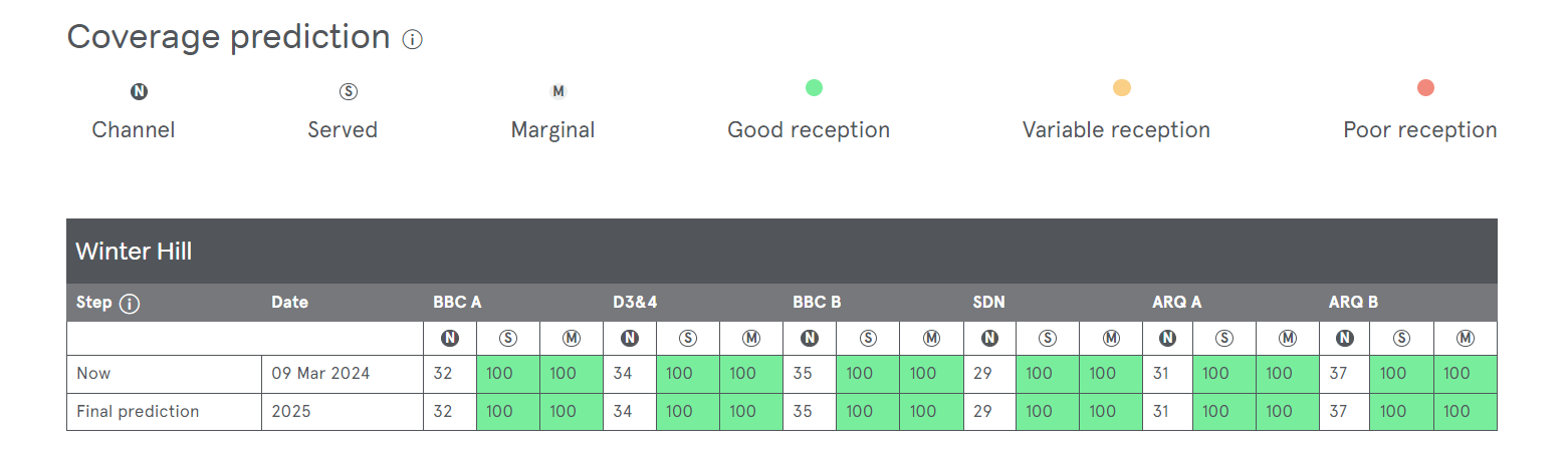

To get an idea how strong the signal is for the location, use this tool: https://www.freeview.co.uk/corporate/detailed-transmitter-information
This is what the reception prediction looks like for an Oldham postcode

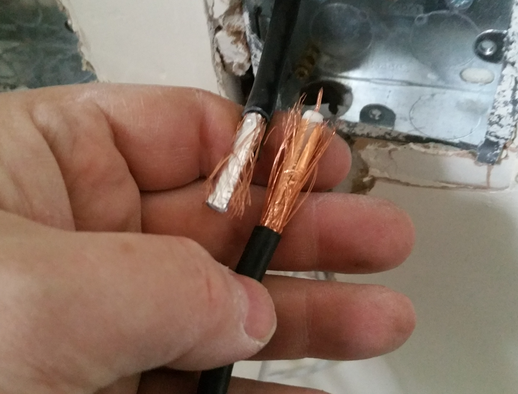

Use good cable.
This is a shot from a recent installation. It's a newbuild. The cable on the left is what the builders installed. It's a bit better than your typical bog standard RG6. The foil shield is still Mylar - like the inside of a crisp packet - but there's a copper braid albeit with very sparse coverage. Bog standard RG6 uses aluminium braid. The centre core was steel with a thin layer of copper anodised over the top (not seen in this image). Steel has higher electrical resistance than copper.
The stuff on the right is what I use. Webro 100. It's all copper, no plastic, no aluminium, no steel. There's more shielding, of better quality, and - should the worst happen and water get into the cable - copper survives a drowning where as aluminium corrodes to a mush.
Webro isn't the only manufacturer of good aerial coax. Labgear (PF100) and Triax TX100 are very close equivalents.

NB The Freeview reception predictor does not calculate the signal level received at the location 100 metre x 100 metre square (other than it is above a minimum threshold). Rather it is all to do with interference from other transmitters: the two numbers are % of locations in the square that are Served (interference <1% of time) and Marginally served (>1 but < 50% of time).
Another prediction tool, on the Wolfbane website, does an estimate of signal (field strength) level but is out of date using the older frequency allocations... nevertheless that can be used to do gain/loss calculations and aid aerial selection if the numbers are taken with due caution.
