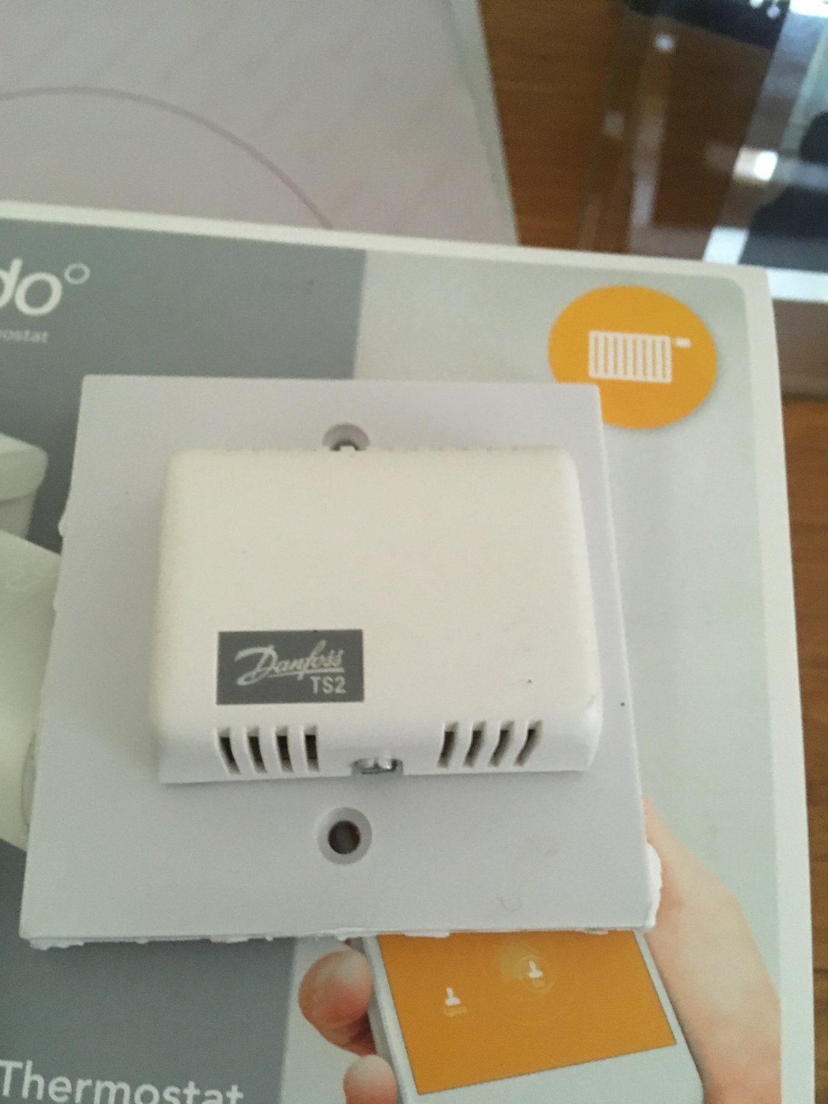

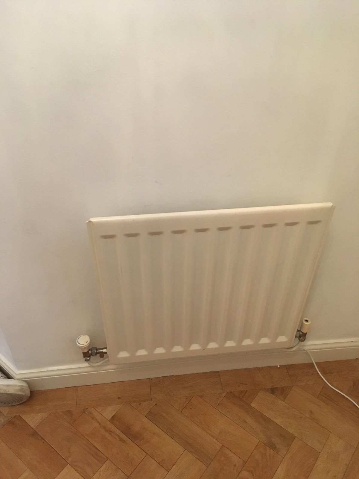

Does anyone know if you can fit a tado radiator valve on this radiator, there’s a load of adapters I just cant make them fit.
No that’s a lockshield valve, not a thermostatic radiator valve. What’s at the other end? Another of these? Will probably be where the room thermostat is located if this is true.
Ok then thanks, I have just removed a danfoss ts2, replacing it with a tado thermostat only problem is that radiator is getting bouncing hot and won’t turn off. Any ideas
you will have to fit a thermostatic radiator valve that accepts the tado actuator, neither of those valves will fit
I had to fit a cheap standard TRV valve and then swapped the head over for a smart TRV head
